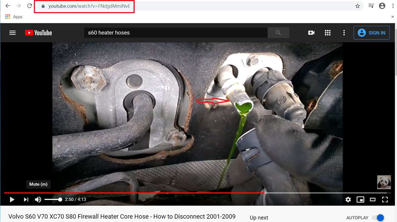

Question for the P2 gurus: has anyone used generic heater hoses in the P2 S60, V70, XC90 cars?
Such as connecting the generic heater hose to the metal outlet, then add a few clamps at the RED arrow area...
