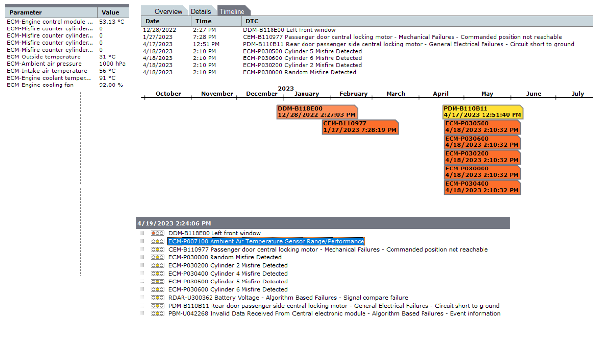

Hi all -- my father's 2008 XC70 (~105k miles) has been having some intermittent overheating issues for a while now.
Last fall it would give him the High Engine Temp Stop Safely message if he drove in heavy traffic with the A/C on full blast for extended periods. At first I thought it was a fan issue (the fans weren't turning on), but VIDA ruled that out. So I replaced the thermostat (incl. ECT) in December -- the tabs on the old one were busted, as expected -- and it did fine until earlier this week.
It gave him the same high engine temp message, and then threw a bunch of misfire codes. I couldn't reproduce the issue - I'd probably have to drive it through traffic for a while with the laptop attached.
See the collage of screenshots below for more details from VIDA. Upper left shows some of the parameters I tracked after I started it (vehicle was already warmed up, but this was the next day, not after heavy traffic). Top right shows the timeline of the faults, bottom right shows all the codes that came up on the initial read.
A few thoughts:
1. When I hear "overheating" and "misfires" I think "head gasket". Currently in denial, since he just bought this a couple years ago, but I'll probably end up pulling some spark plugs and/or trying out a coolant gas tester.
2. Actual outside temperature was ~75F (24C), but I assume that outside temp reading is affected by sitting in the sun (which the car was), and I'm not sure outside air temperature would have this effect.
3. I am wondering if this could be due to a faulty ECT -- could that send the wrong temperature both to the ECM (misfires) and to the dash warning light?

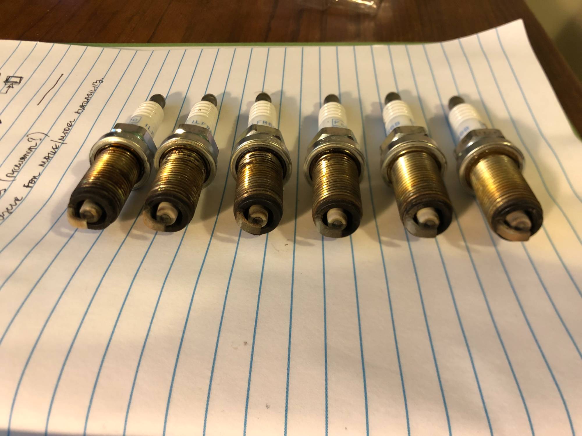

As for the sparkplugs please take some pictures and post them here. If the PCV is allowing too much oil to get by then it can foul the sparkplugs which will cause misfires. Take a look at the picture of my PCV fouled sparkplugs from my S80. (scroll down for the picture)
viewtopic.php?t=87687&start=200

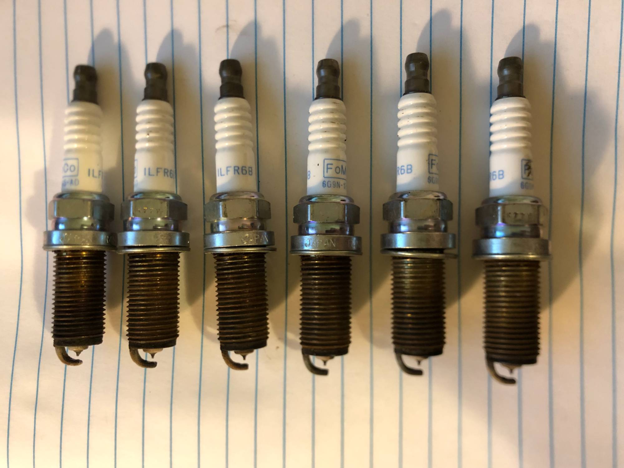

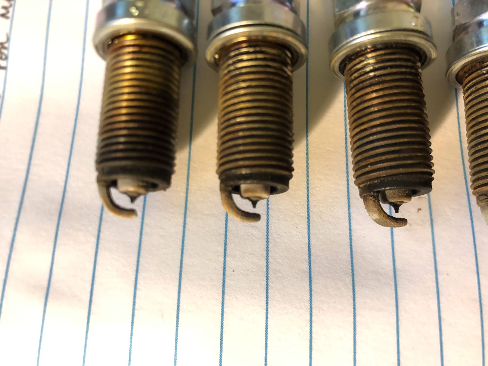

Two updates: 1) Spark plugs and 2) PS pump / Water pump / tensioner / idler / belt replacement. Apologies for the pics being slightly blurry in random places -- it's a 4-yr-old iPhone. Hoping for another couple years out of it..
1) Spark plugs were dirty, gaps were all a bit wider than spec. Original to the car, based on the FoMoCo stamp.
