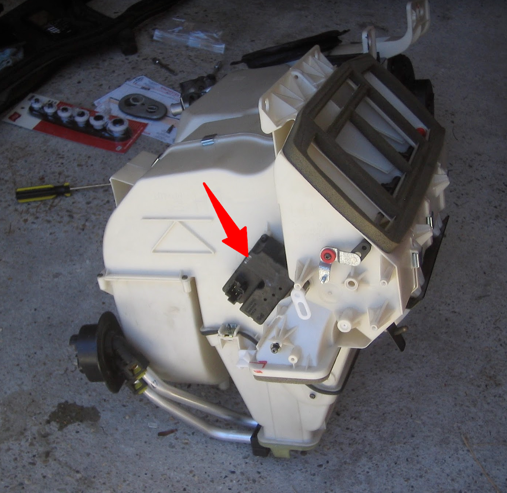

Can you access all this pretty easily from under the driver kick panel? Or do you have to get to it from the top by removing the dash pad? Here's a picture of when I had my white HVAC box out last time. Is the motor in question the one with the arrow?
Curious that in this picture I only see one motor. I think there is supposed to be 2.
HVAC Blend damper motor?
HVAC Blend motor.png (1.5 MiB) Viewed 293 times

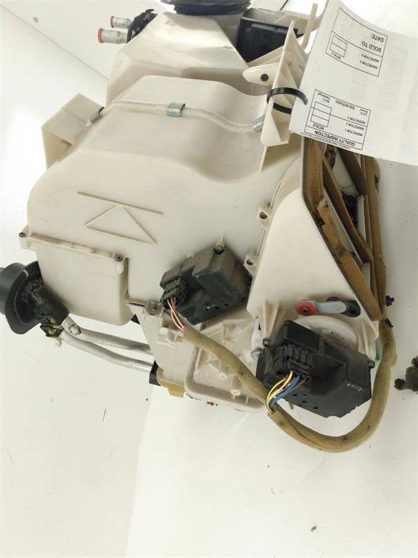

Here's a picture from a seller on eBay, I think this is more accurate. Is the electric damper in question the on on the left, deeper in the dash?
Picture from eBay
Picture from eBay
HVAC Box2.jpeg (42.01 KiB) Viewed 286 times
