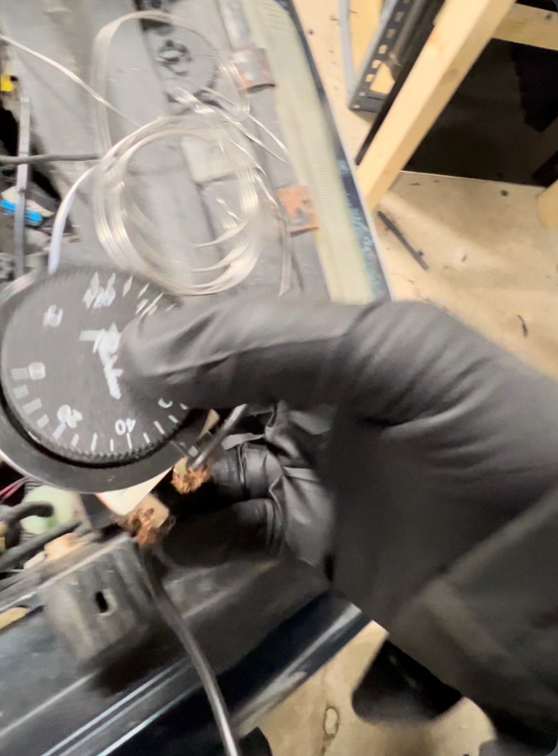

When i purchased this car there was a thermostat dial switch wired into the #2(High) fan speed centre connector on the fan control relay. He had the Temp set to 65C on the dial switch to turn the fan on. The dial read temperature from a probe that was shoved in the upper rad hose port on the radiator side.
I took this system out assuming that the relay had gone bad and replaced the relay with a new one.
