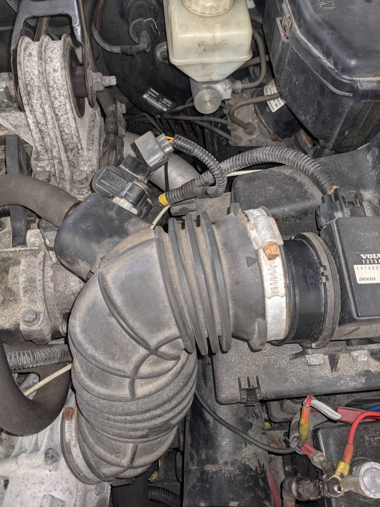

The attached image seems a bit contradictory. The MAF says Denso on it while the snorkel has two inlets (fuel vapor and oil vapor). There is no small version of the IAC valve, suggesting Bosch ME7.
I'm leaning toward part 9202309. FCP says it's for 2000 and the other is for 1999, and the usparts.volvocars.com info seems to suggest the same in its cryptic way.

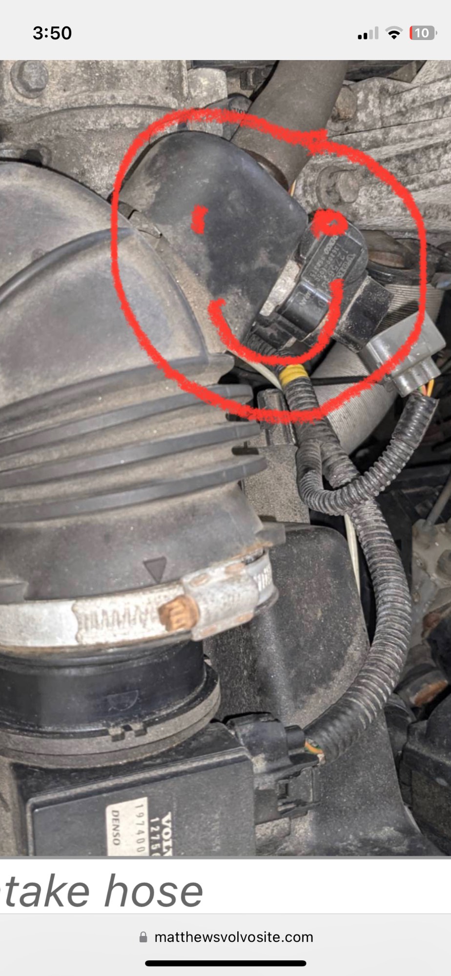

That’s the Denso idle air valve.

Thanks, I've been wondering for a long time which system I had and where the IAC valve might be.
