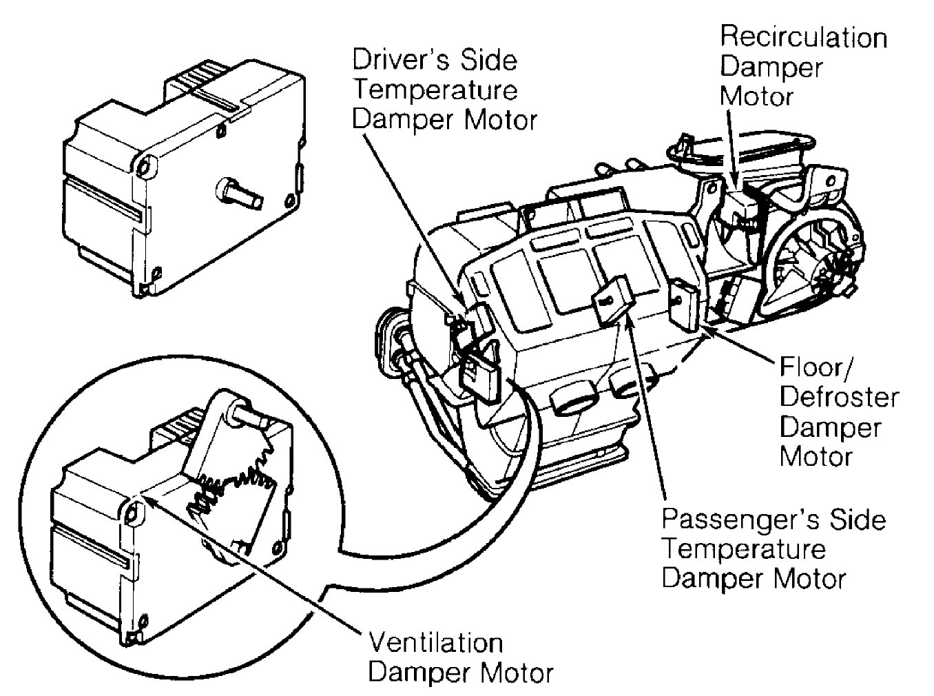

Here's a servo diagram for a 1998 850. As abscate said, there is one fewer servo in 1999- (because they combined two?).
Looks like your picture is the passenger's side temp damper motor (and the driver's side is identically diagonal on the other side of the center console, visible with the knee panel removed). My notes say that in 1999-, the floor/defrost motor was combined with the left vent damper motor. Since I don't see the right floor/defrost, is it possible that yours was combined in 1998? Regardless, I recall it being easy to pull the driver's knee panel and see the two dampers there.

850's used to have a motor on that end. There is one on the driver's side that turns that shaft. The black item behind that is a servo motor so you are correct in your assumption. If you remove it (I can't recall the size of Torx screw, T15 or 20? It is not 'fun' extricating that motor as you need to be bendy and it is hard to see the screws. A mirror on a tick with a built in light may help. I can't now recall if I used a bendy stick with a Torx bit on it to get into the screws. Last did that a long time ago.
Once you have the motor out, mark the position of the motor shaft flats to the motor case so if you try to test it with a 9V battery, you can make sure you get it back to the correct position before re-installing.
