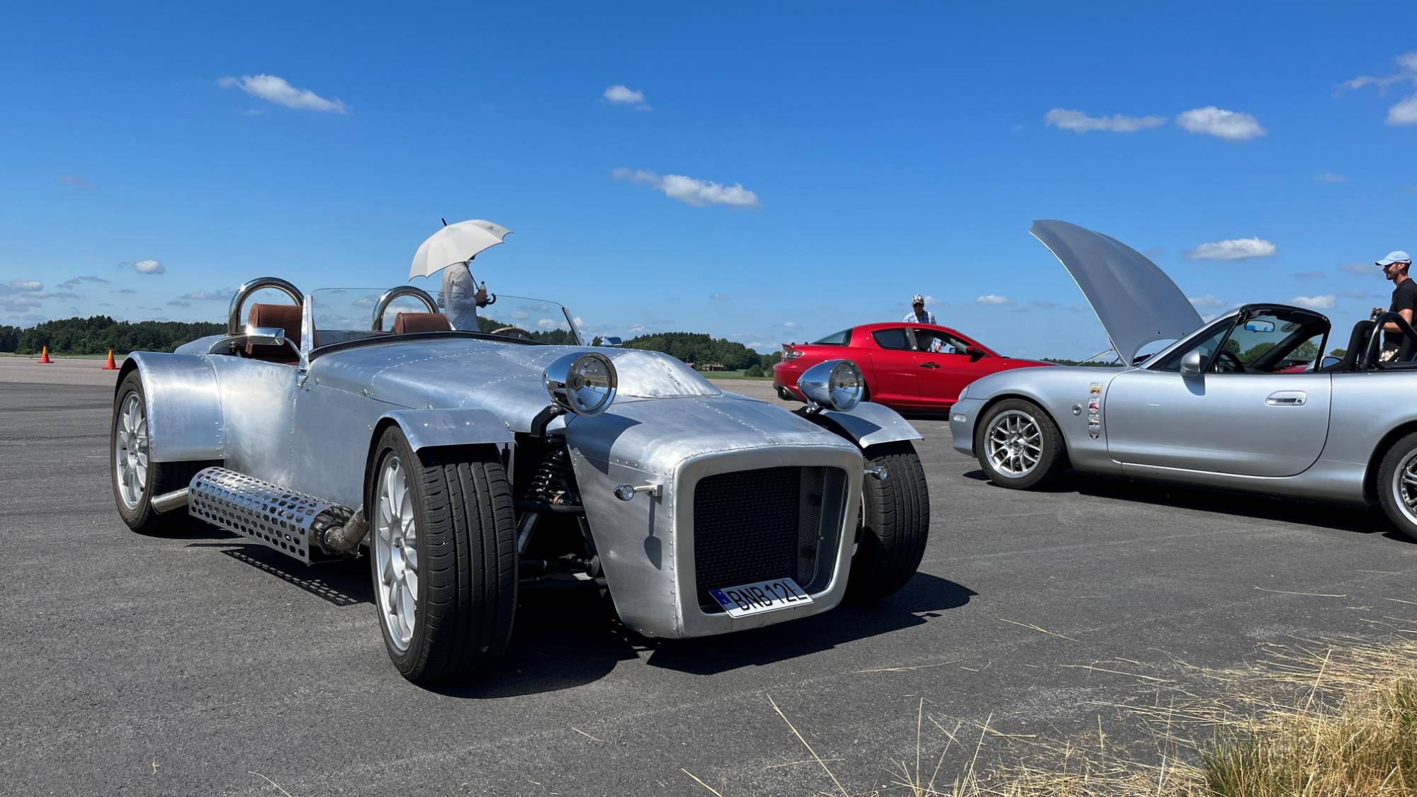

I'm thinking of trying to tackle a head gasket change myself on my Volvo engined Special build but I would like to learn about the tricky stuff before I start.
I have done headgasket changes on a few VW's (1.6 GTI and 1.8T engines) but those all had the cams fixed in the head when you lifted the heads off the block. I researched a bit and there seems to be needed a special tool for keeping the valve cover in place while you undo the valve cover nuts?
Any other advice you can give? :)
