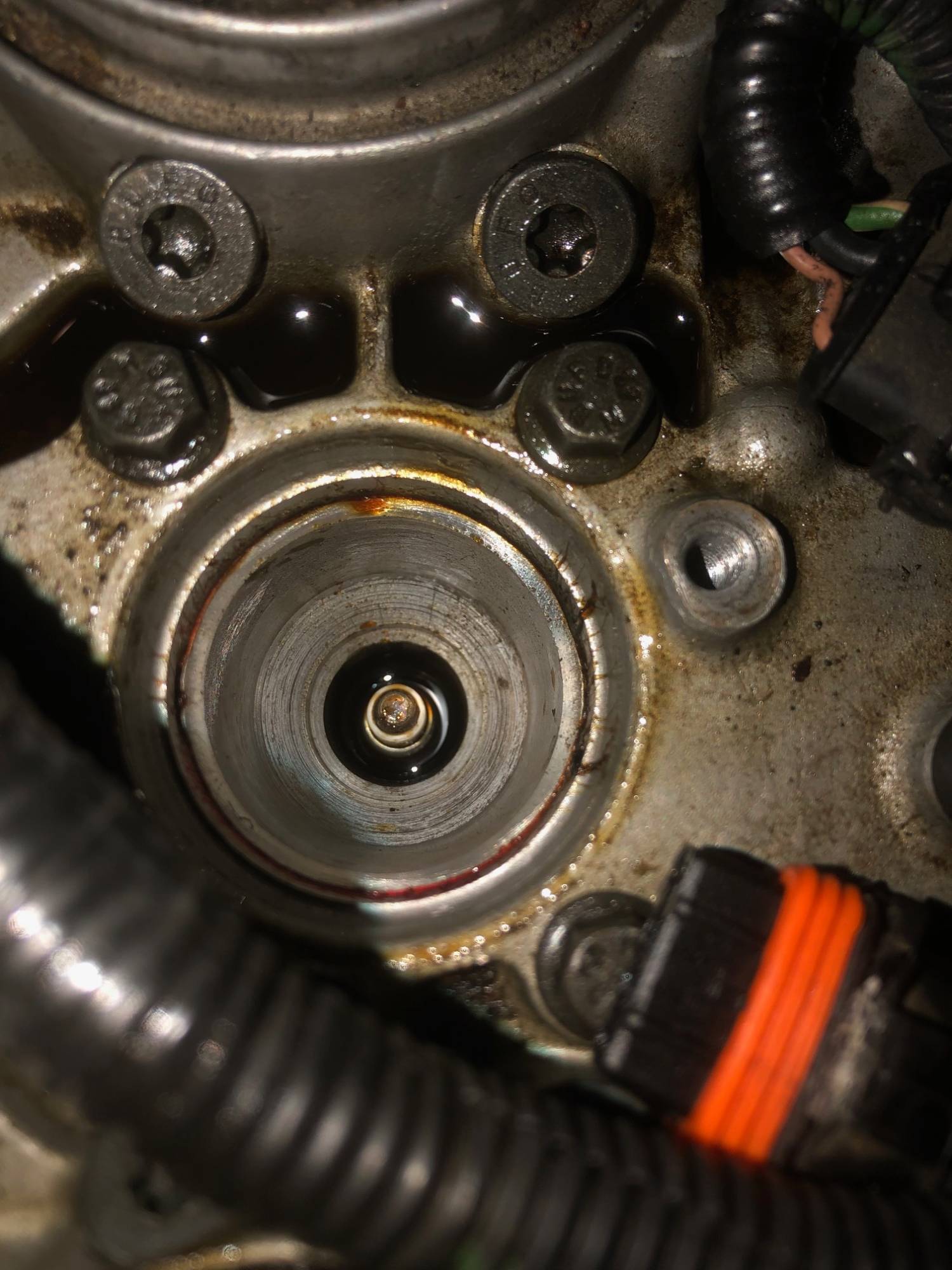

So, I read the code, and it said cylinder 3 misfire. I took the coil out, and there was oil in the spark plug well.
The oil in the little holes above the spark plug well was from me spilling some oil there awhile ago, and somehow forgetting to clean it. Some of that probably made its way into the well. I also noticed it seems like there is a small oil leak between the upper and lower part of the head. I did take off the top part of the head when replacing the head gasket, and put anerobic sealant on it. Can I try to fix that small leak with some rtv?

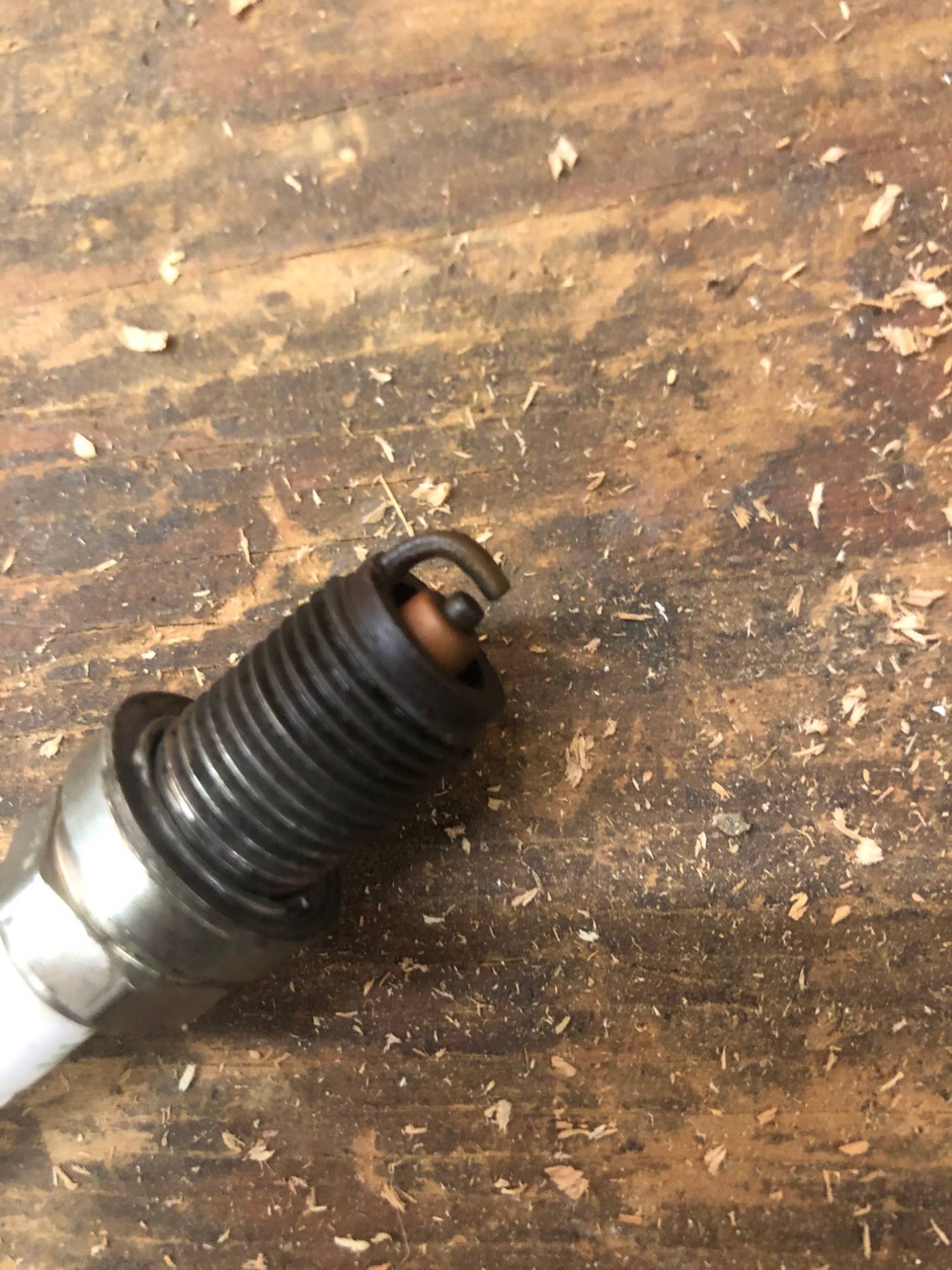

I cleaned out that oil with a rag and and compressed air, put a new coil and spark plug in, and it seems that it has fixed the misfire!
I noticed that the spark plug seemed slightly wet. Is this just becasuse it was misfiring, or does this indicate another problem?

Likely wet from fuel in cylinder but no spark. I’d run it and check that plug in a couple hundred miles.
