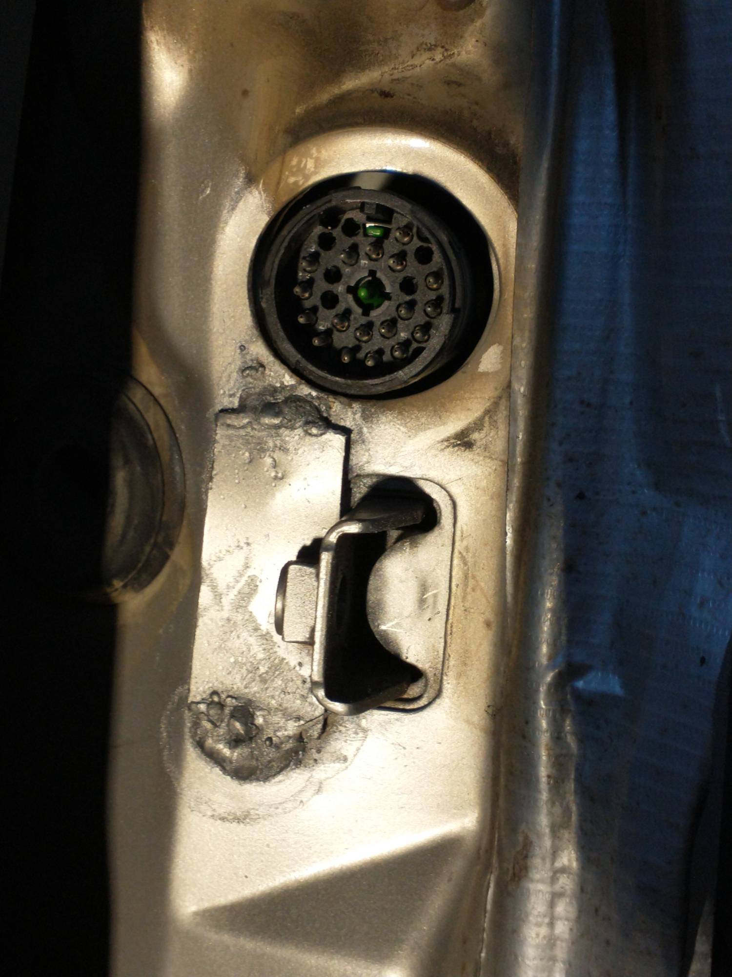

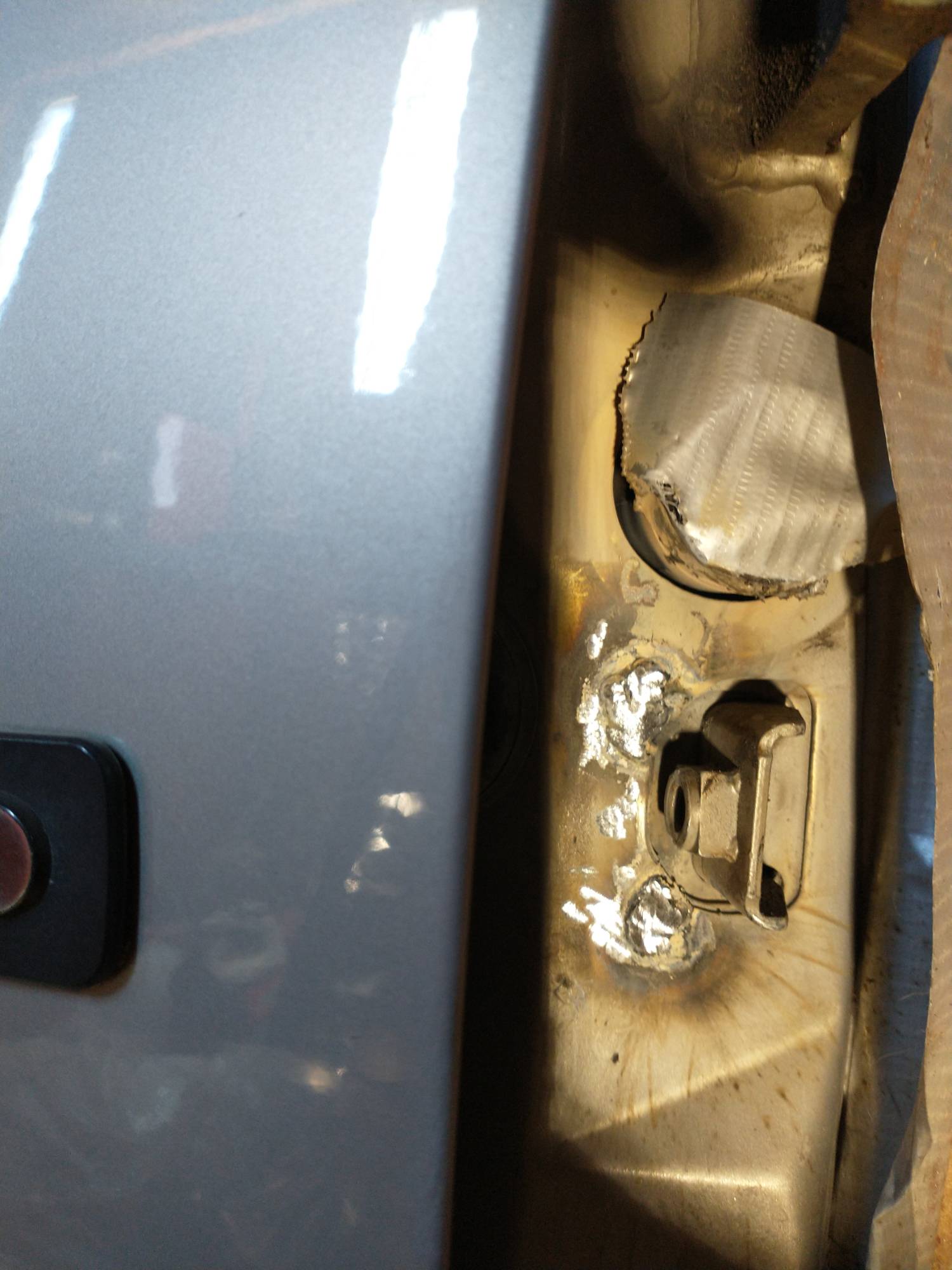

I've been dealing with the door ( drivers, LH ) making the dreaded popping sound whenever it is opened or closed, for a few months, but yesterday it really broke free. I had this happen a couple of years ago with the other front door, and fixed it in this same manner. I think the repair will last longer than the original design, do to adding a small piece of steel in the last step of the repair.
I welded everything, but I believe you could do it with cold weld ( JB Weld etc ), and still have success.
First, peen / flatten the broken body metal. Then wire wheel the paint off from that area, and all around the hinge base. You might need to pry the hinge base back out a little to close the gap between the body metal and the base. But I didn't need to on either door.
Weld everything back together as best you can, and grind flat.
Now the take a small piece of 1/16" sheet metal ( 1" x 2 1/4" ) and slip that behind the welded nut on the hinge base. Tack weld ( or JB Weld ) that piece to the body metal. It doesn't need much; just enough so it doesn't slip out.
It's this little piece of metal that prevents any future movement, as the force is pushing it tighter to the body.
Yeah, I threw some paint on it, but you won't see it when everything is back together.
And it doesn't cost diddly.

Looks like you hit it with a mig, which should provide plenty of penetration. I wouldn't go the JB Weld route just because we know that whole area has a propensity to flex. That said, it would be better than nothing for someone in a jam and without welding equipment =)

Looks clean and sturdy, very nicely done!
