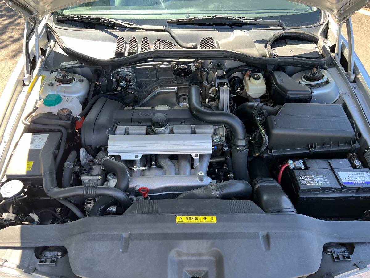

UPDATE: Just checked out the CARFAX on these two and the 99 XC is the clear winner. Not only the low millage and near immaculate interior, but also only two owners. Regular maintenance. At 80,000 the timing belt & water pump were replaced. Seller is springing for a new set of tires.

I think the XC is a good buy. I'm normally not a fan of low mileage cars, because they typically aren't maintained based on time rather than mileage. But it seems this one has been maintained properly. Also looks super clean!
The early AW55 transmissions like in that '01 are pretty bad. There are probably also some other small early P2 issues that would need to be sorted out, so it's easier to avoid it.
