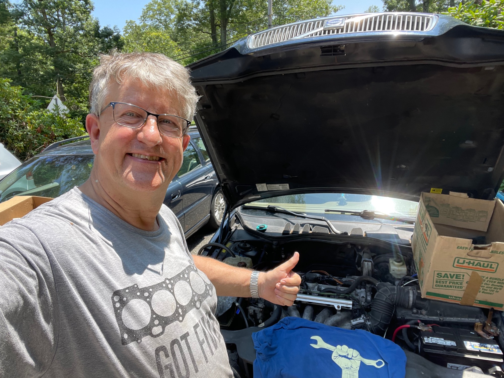

15 minutes of smoke and clatter then Shagg settled into silky smooth idle
Question: how do you keep all the subtle routing of hoses straight in the engine bay?
Answer: pop the hood on of your other 4 1999s…..
