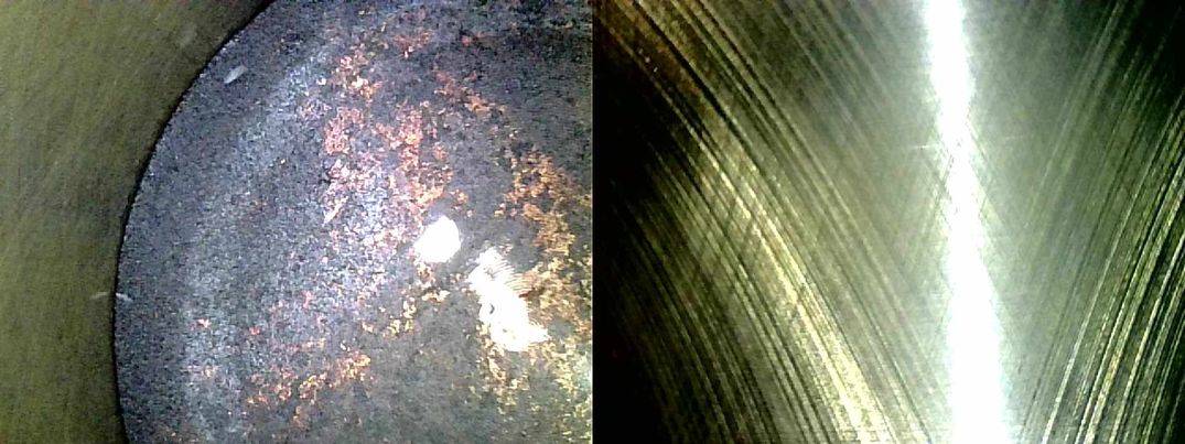

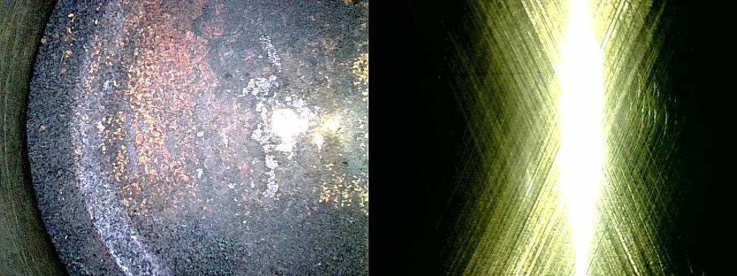

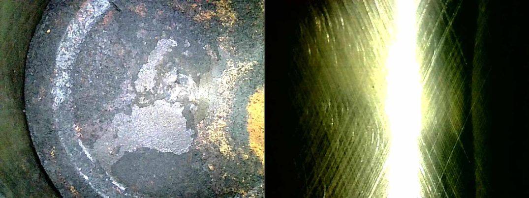

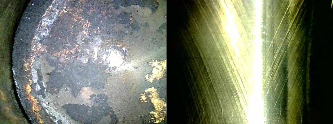

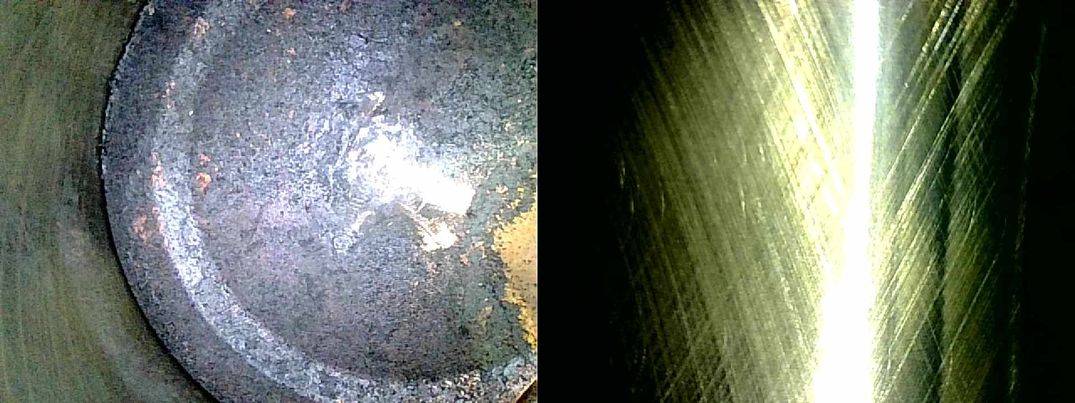

Back from vacation and one week to fix this issue :)
This morning we looked inside the cylinders with a endoscope and the cylinder walls and pistons look fine. ( see pictures)
Also we tried to feel for some play pressing down on the pistons but no play at all.
This was done with the pistons on the way down in the cylinders.
Then we tried to disconnect one ignition coil at the time but the sound does not go away.
It's so hard to tell 100% where the sound is coming from, is the next step removing the oil pan or can we do any other smart test ?

Removing oil pan, cleaning pickup tube screen, installing a new O-rings is a wise move for any P2 in 2023.
Third picture has some overheating signs.
