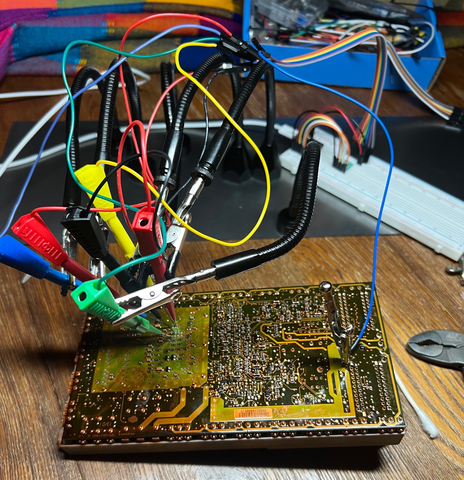

Hey y'all, so I just read the flash off of my spare cem
I got data off of the flash memory in hexadecimal, now I don't really know where to go from here. Do I need the entirety of the bin in order to crack the pin, or do I just need the security block, which in Luke's code as "read security block 4000-7FFF" ? I was doing some research on the thread and it seems like I may have to upload the entirety of the bin to D5T5 in order to use the pin with VDash. I am eventually going to change my car's CEM from a bin for an automatic to a manual.
Im really new to this so I appreciate how helpful everyone has been so far!
(had to jury-rig the ground wire, I didn't have enough magnetic arms for it lmao)
