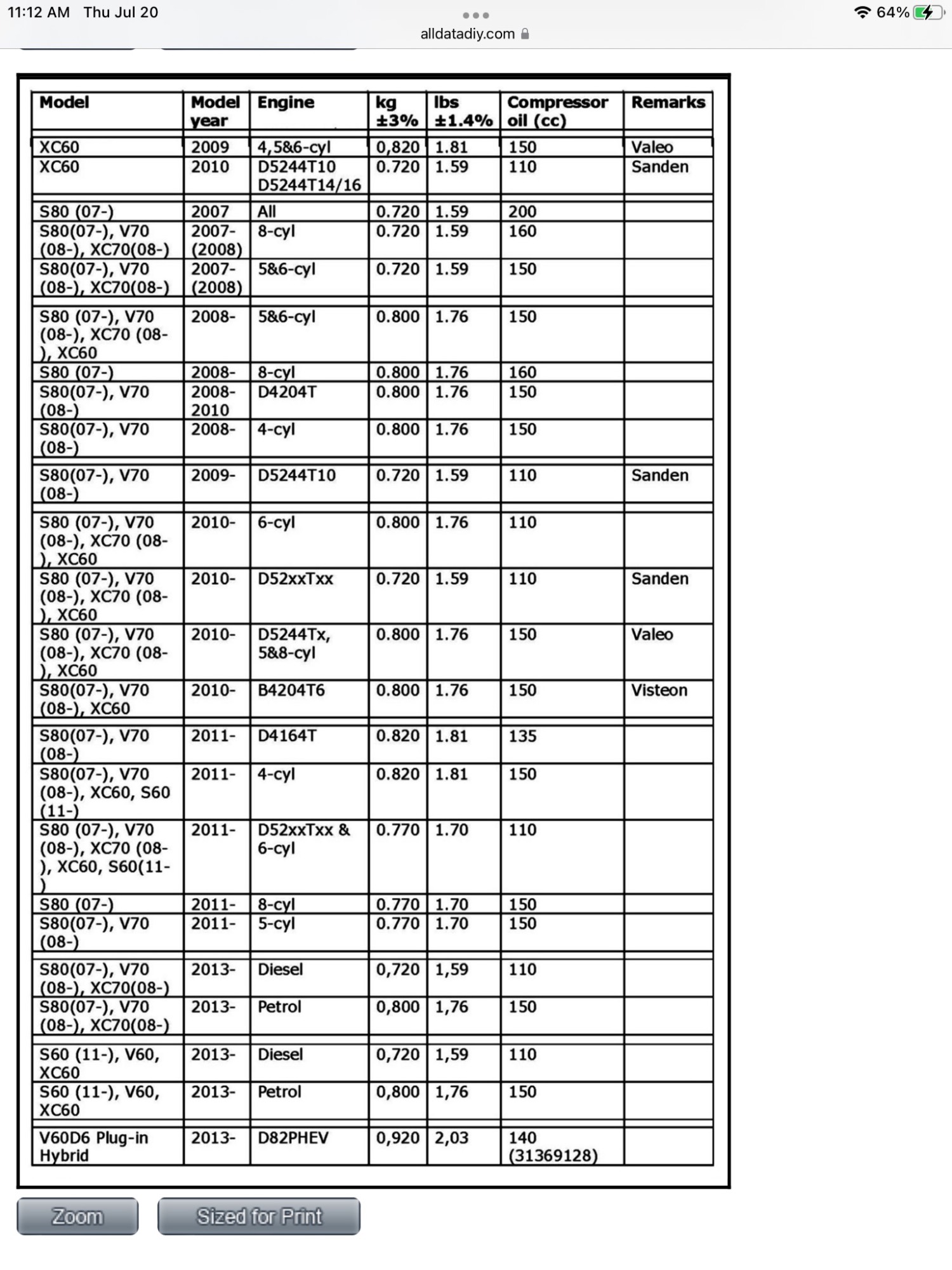

Everything is pointing to a system blockage , the performance and the shortened piece of cold “ hard pipe”
1000g in a 700g system is a huge overcharge, get the specs right. My p2 takes a 700g charge. You can’t guess at this, it will damage the compressor if you overcharge by 50%. The P2 is really sophisticated at protecting the compressor from liquid, it actually engages the compressor briefly when cranking to kick out any liquid present thst might pool in it.

From what I can tell you have had a refrigerant charge of 700kg, 1000kg and 1300kg in the system. The dealer said it needs 1000g based on your VIN. If the compressor is short cycling at both 700kg and 1000kg charge levels there's another problem other than the charge. If the system pressure is too low or too high the compressor will be commanded to shut off, the pressure switch is on the receiver/drier. What are the gauge readings saying?
If the pressure sensor is working correctly and there's is a blockage in the system, I would expect you to see have a very high pressure reading on the high side gauge and a lower than expected reading on the low side gauge. Another indication of a blockage is the gauge readings after the running the compressor and watching how long it take for the low and high gauges to equalize after shutting off the engine. It shouldn't take more than a few minutes for these gauges to equalize. When you replaced the condenser was the receiver/drier also replaced? When your mechanic has the system apart for flushing it should be easy to determine if there's any blockage in the condenser, evaporator or hoses. You can't flush the expansion valve or receiver/drier but you should check these for blockage with some compressed air with these components. Because you've replaced the condenser and will be replacing the expansion valve you should pay special attention to the receiver/drier if this has not been replaced, this will be a likely area for blockage. Check the old expansion valve with air too, at room temp air should flow freely through it.

Not clear where a 2007 S60 fits in this chart..
I provided my VIN to two separate dealers and both told me 1kg.
