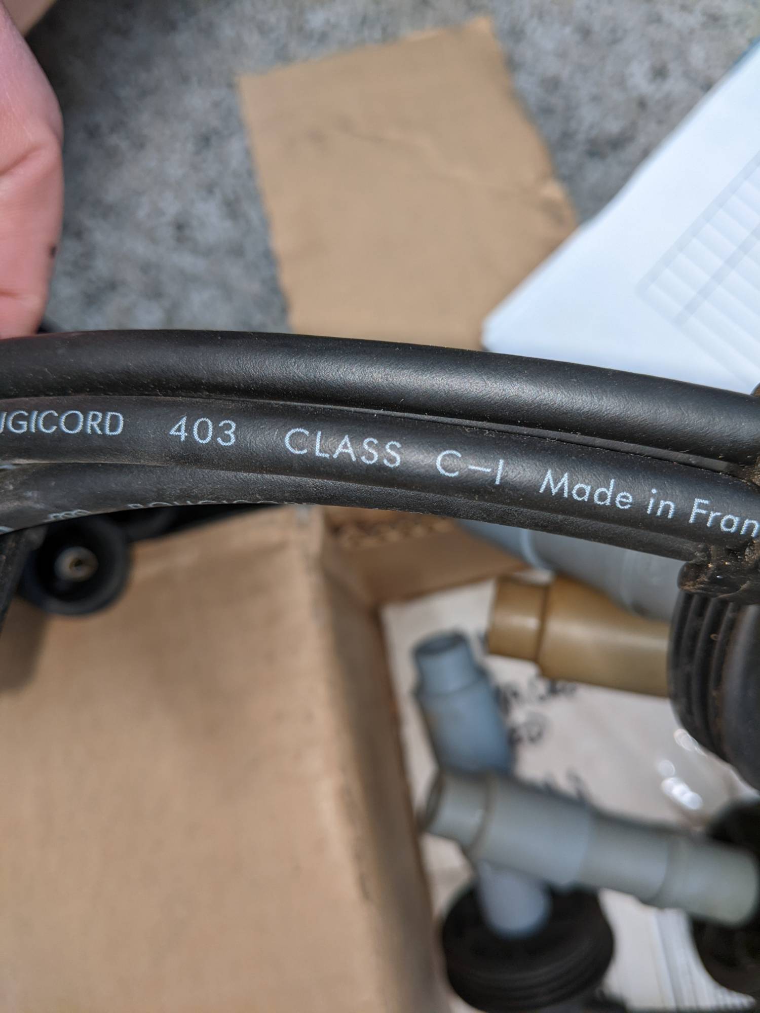

Ok! Now this is why I have been more confused than normal. I was looking for a part in my Pre-98 P80 parts boxes and found a set of plug wires that were replaced on my 1998 V70 XC. The box is the original Bougicord box and interestingly is part numbered # 9135700. That is the parts that I fitted to my 98 probably 8+ years ago.
I pulled the leads out the box to compare to a new set I have for my friends 98 V70 NA. The surprise? These are marked C-1 403??
So these were fitted to other engines and this was a LPT turbo engined car. Even the distributor to coil wire is marked with the C1 403 code on them.
I believe Volvo has now stopped supplying Bougicord plug leads so I had to buy a set from IPD of Bougicord items.

Do Bougicord wires have date codes on them to show when they were manufactured? Is there a trick to translating them into a date? That would help anyone with wires of unknown age know if they should be replaced. Thanks.
FireFox31
- Posts: 11800
- Joined: 25 July 2009
- Has thanked: 292 times
- Been thanked: 765 times
Bougicord plug wires are date coded yy-ww e.g. 06-35 means manufactured the 35th week of 2006.
