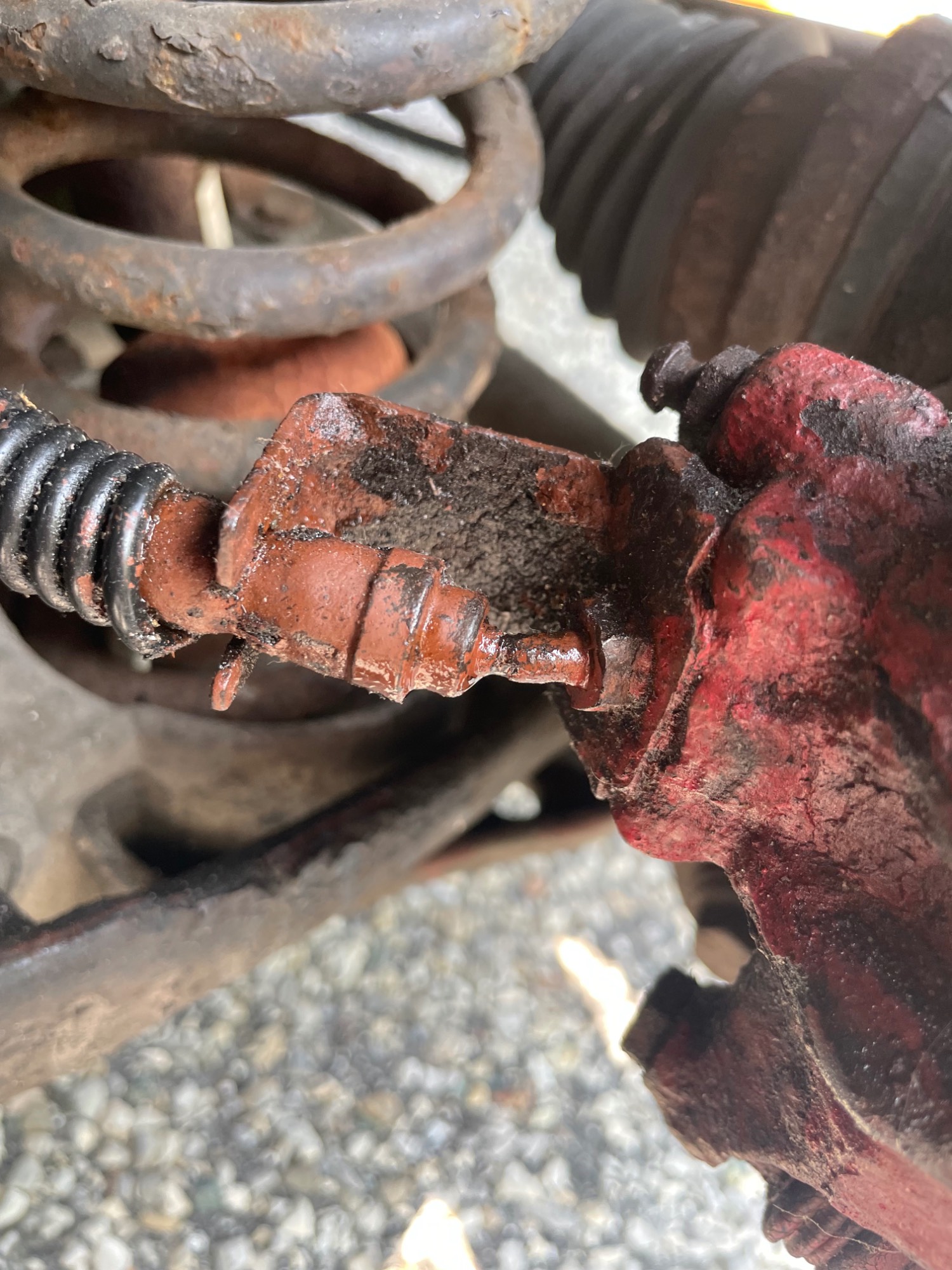

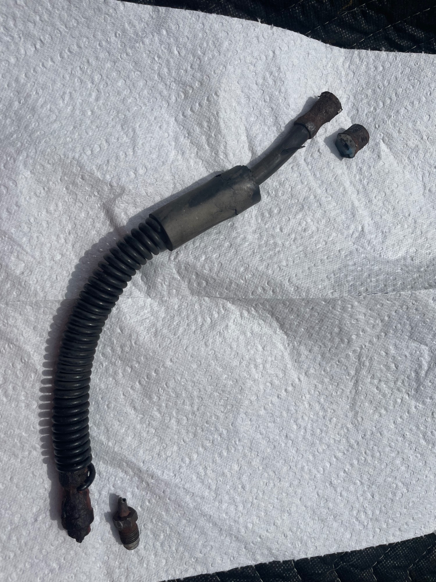

I had a seep at my left rear brake line, which isn’t good. It turns out the old one ( original) was pinholing at the junction of the hardline and the flare nut at the caliper

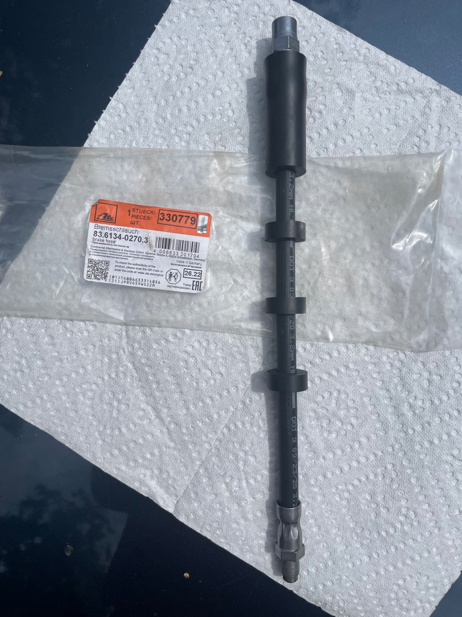

FCP had a nice new replacement style with a swage at the caliper instead of the line/flare. You have to tighten at the caliper first, of course, with this design
The AWDhas a bulkhead flare connection on the jack point connector , unlike the FWD cousin with a hard to read Union on top of the rear suspension arm. That’s payback for the rear axle drop needed for other service .

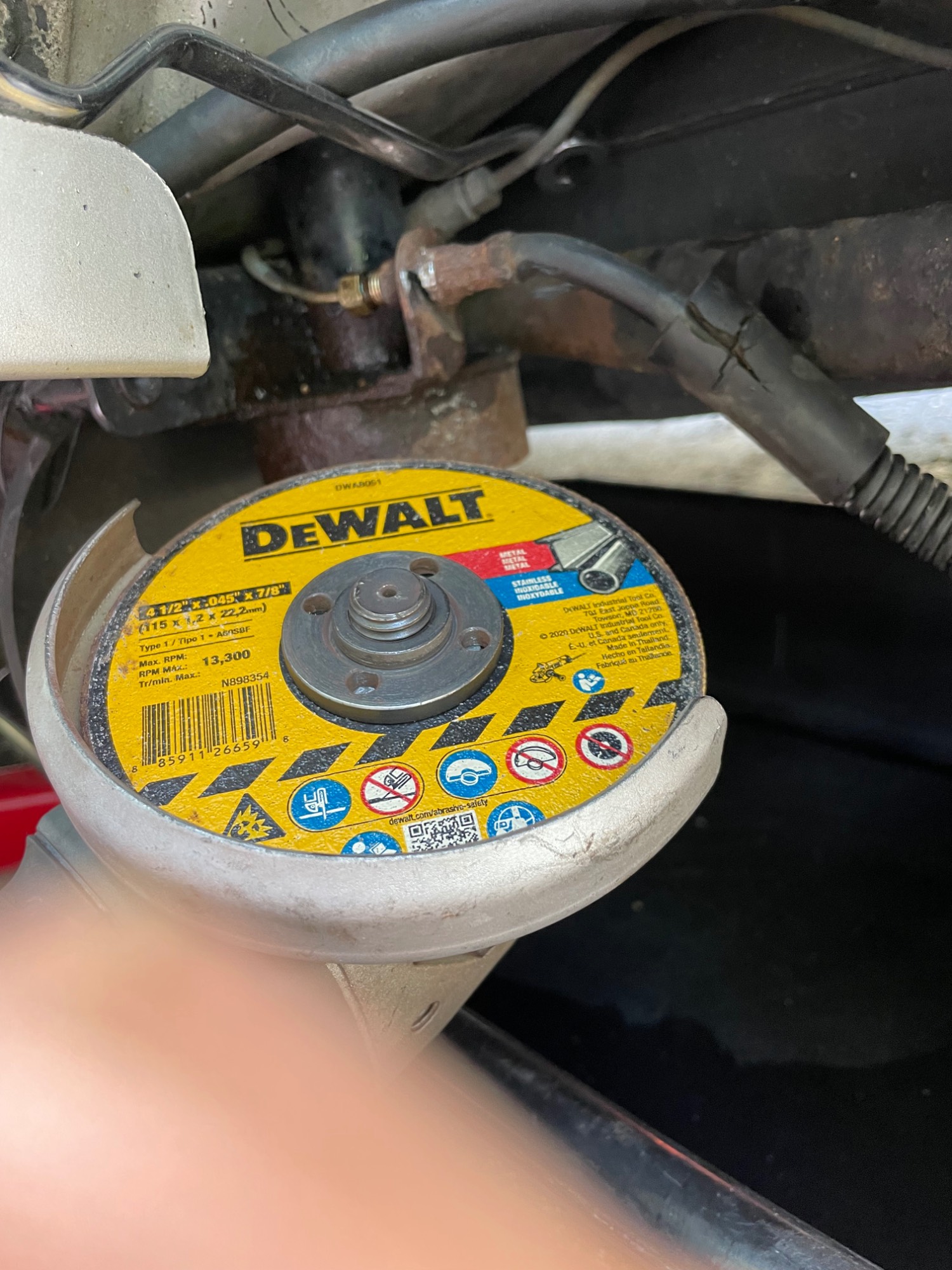

30 seconds of propane heat yielded the Union nut from the piece of the soft pipe, after I cut it off with a Dewalt brake pipe remover

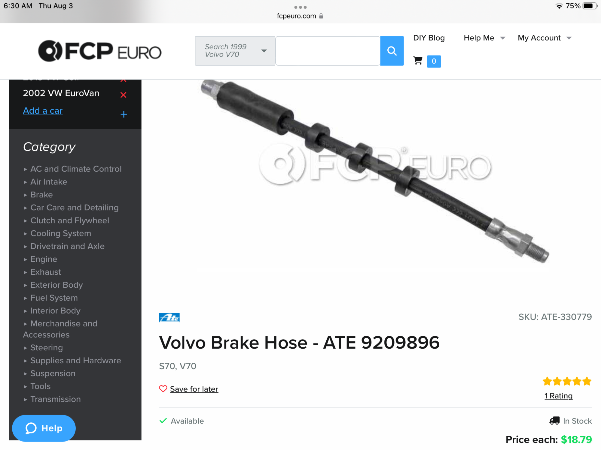

Part from FCP of course
1 minute to bleed air at the caliper, put tire back on, and all set.
