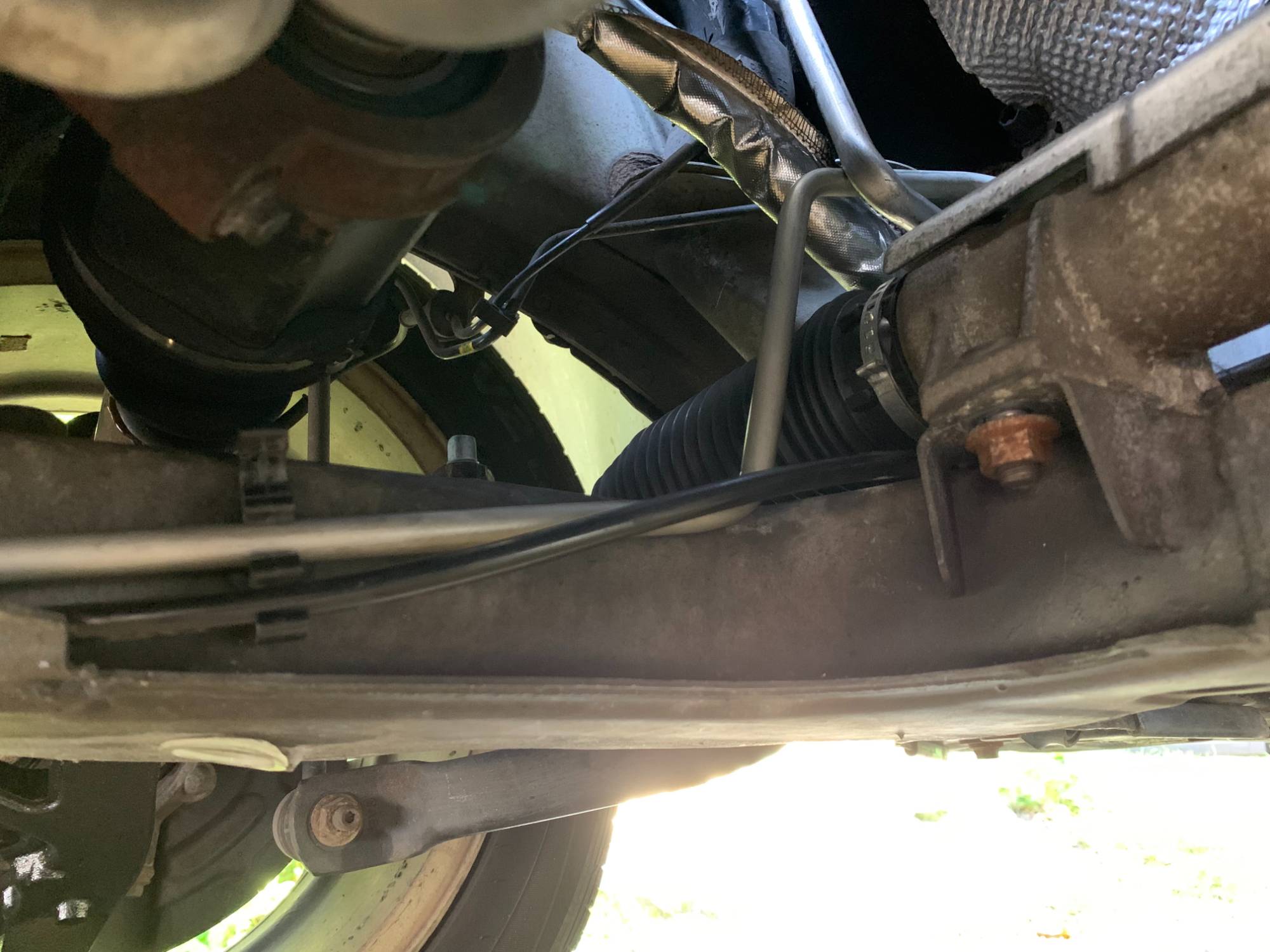

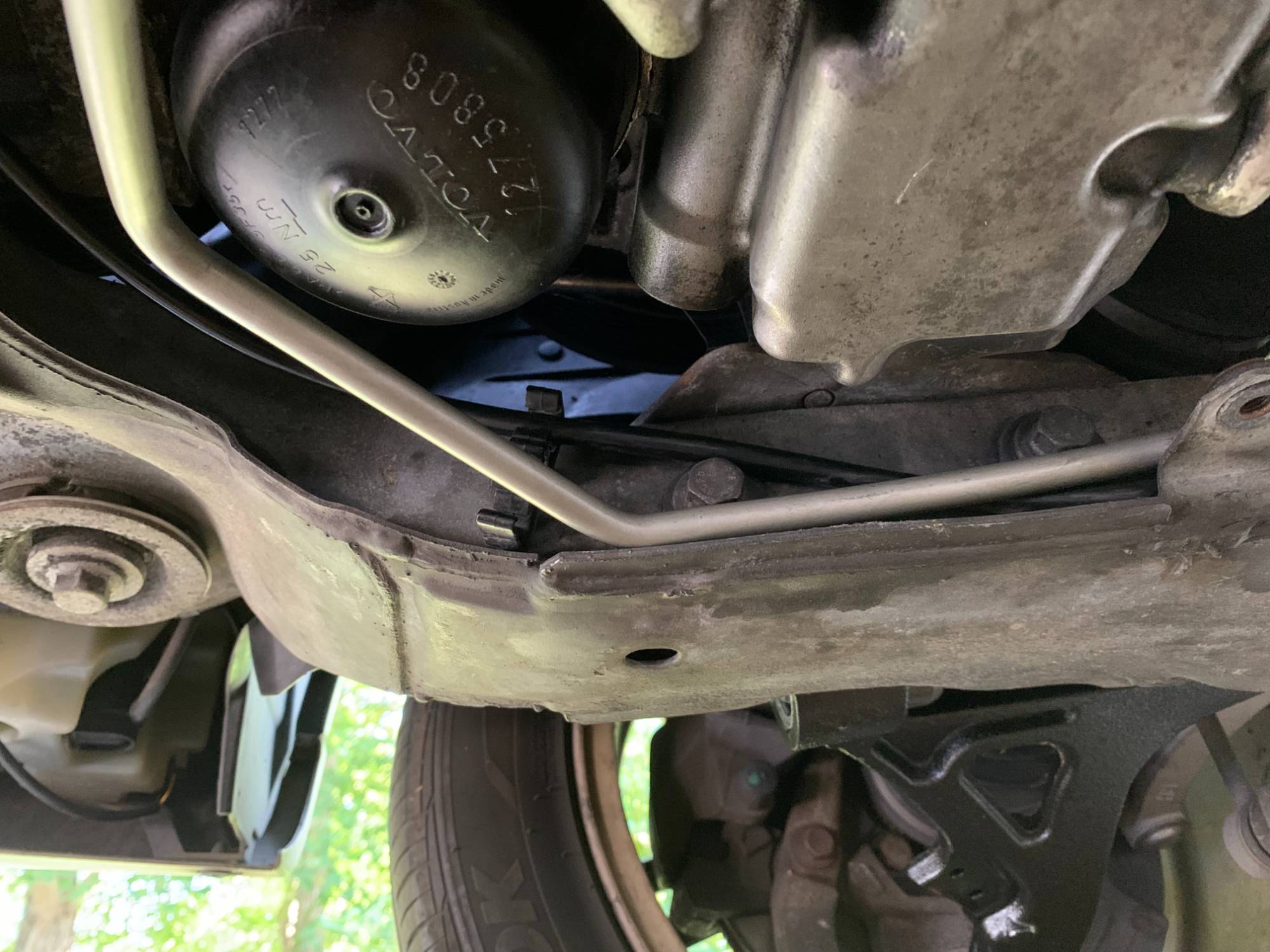

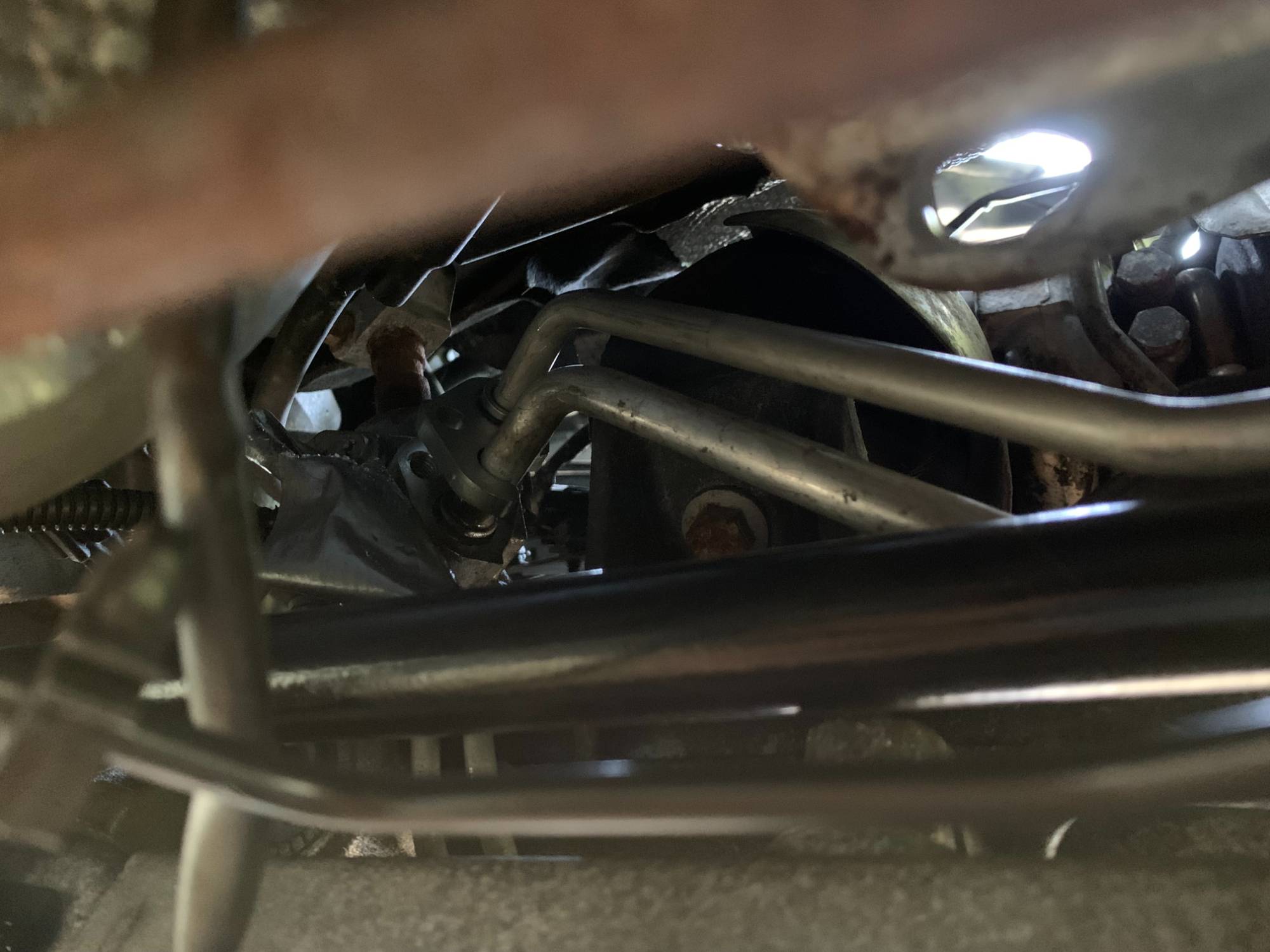

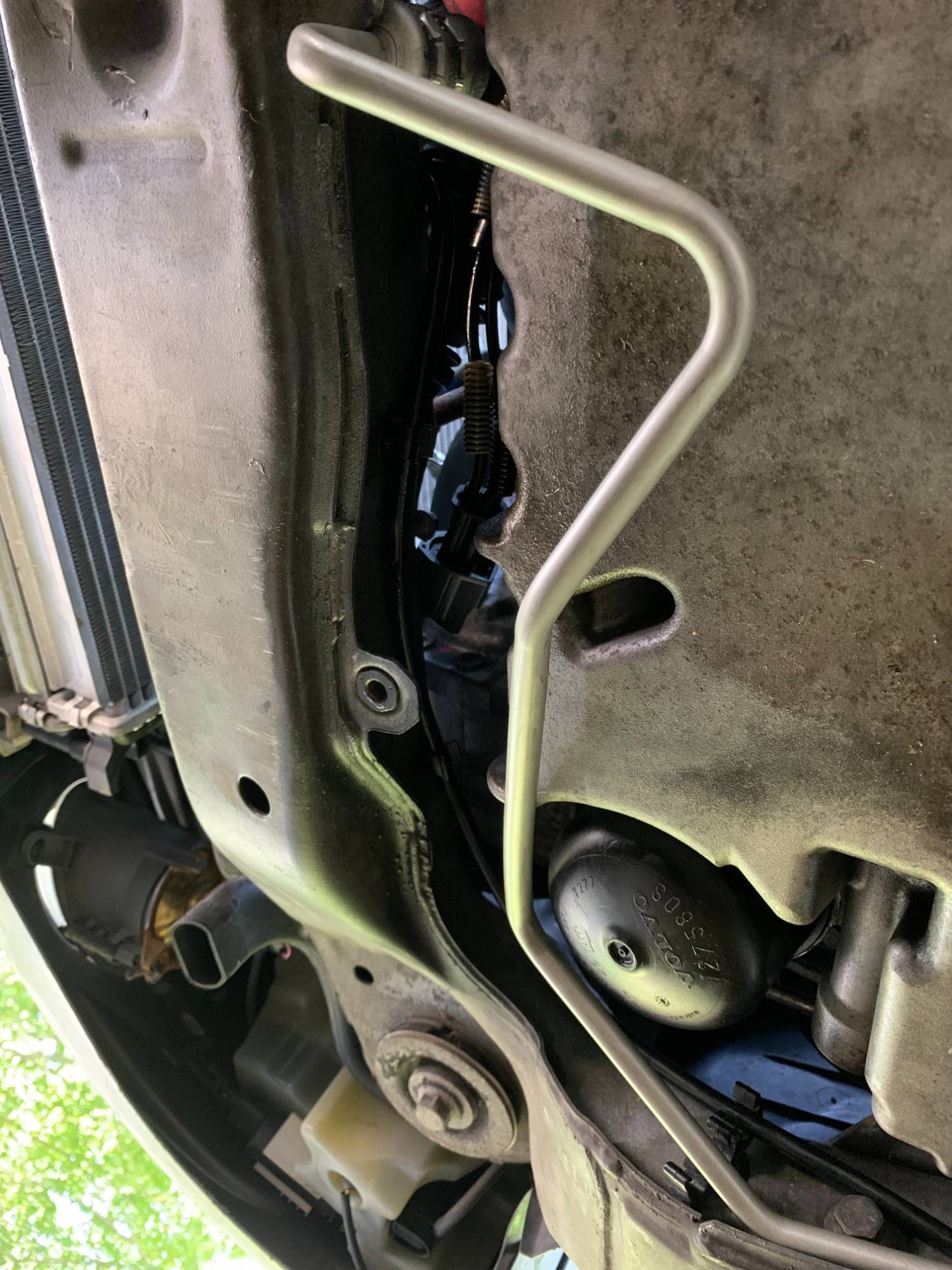

The power steering pressure hose started leaking at the crimp so I pulled it out and bought a replacement. Can’t get the replacement to fit in the car, but it has all the same bends as the original hose. I must be routing it wrong, but I did not take photos of the original before removing it.
Can somebody with the same car please take reference photos of the power steering pressure hose from the steering rack up to the power steering pump?
The way I have the hose installed now looks like it fits on the steering rack just fine, but up front there is a sharp bend in the hose that interferes with the oil pan. I must be routing it wrong and it is not obvious to me how it’s supposed to go.
Photos of the way I have the new one routed and the interference at the oil pan are below.

To put the new hose in, thread the end that goes to the rack down through the engine compartment and get the sharp bend under the hose crimp positioned about where it should go.
Start working the rack end into position. Pay attention to the way you route it around the power steering return line.
I guess the trick is to raise the front end of the car high enough to manipulate the hose from under the car. The radiator fan gets in the way so it must be taken out. The exhaust hanger bracket gets in the way too. You may have to bend down the riv nut tab near the oil pan to get the hose in.
