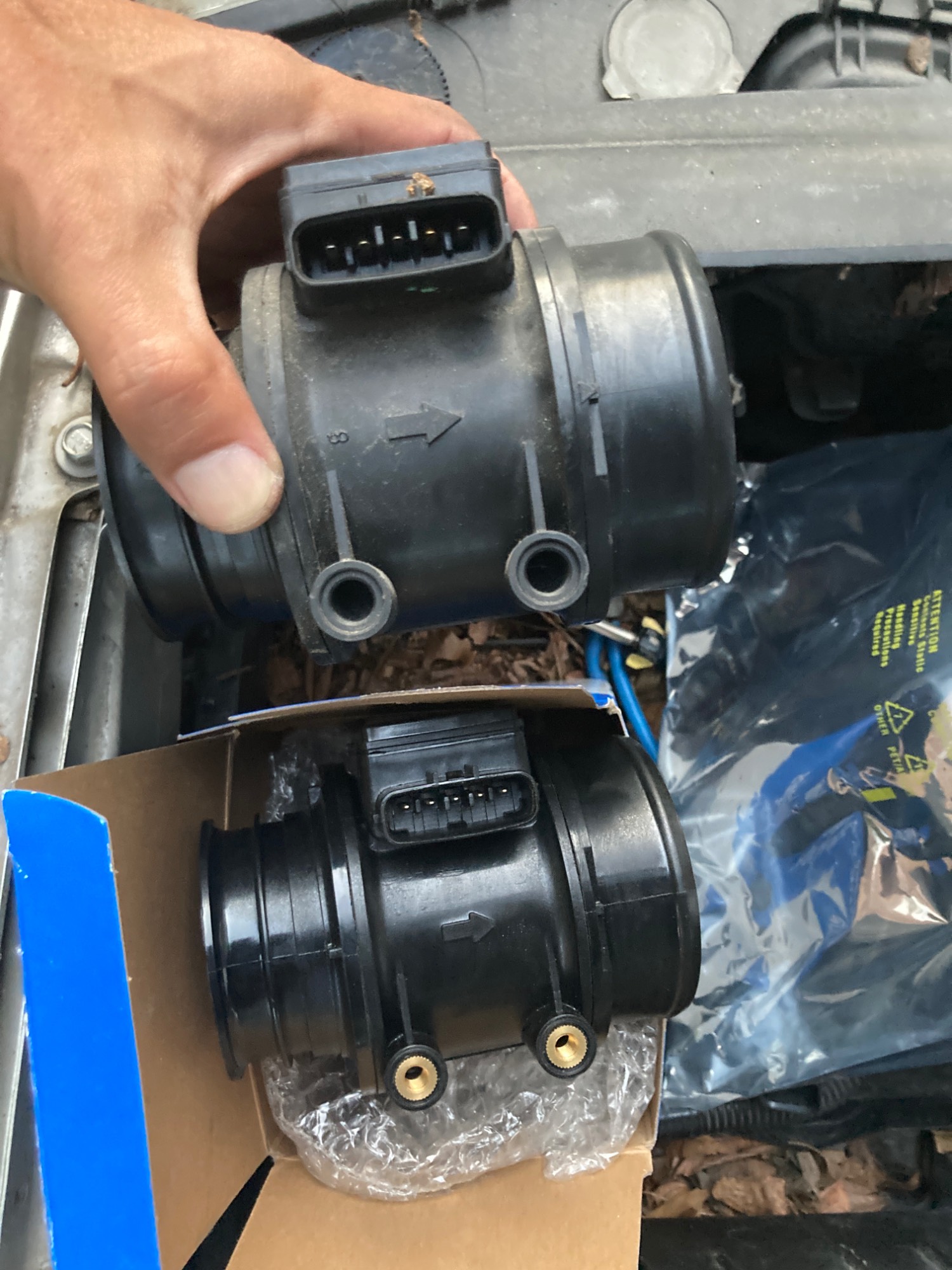

Received my Xemodex-repaired ETM and MAF sensor for the Silver Bullet. The MAF had the mounting bolts embedded on the wrong side, so back in the box they went.
The car started right up with the new ETM … and then the RPMs started climbing and climbing to over 5,000 before I shut it off. I tired again, and the same thing happened. Then the car had no power, yet the battery still has 12.3V.
My thought was to get a new MAF and try again, but now I’m not so sure.

Do you possibly have an air leak? I have not heard of the MAF causing this sort of issue (doesn't mean it can't), they either are variable or dead, not heard of one causing a rapid rise in revs. Being a non-turbo and manual, there are limited options that I can think of that might cause this issue.
Leaking pipework/air-leaks and wiring are the 2 main issues I can think of.

Thanks, Neil. I’ll check for air leaks when it’s light out. My brother was set to unplug the MAF sensor once I got it started again, but the car was completely dead. Not even the dash lights came on, which seemed weird.
