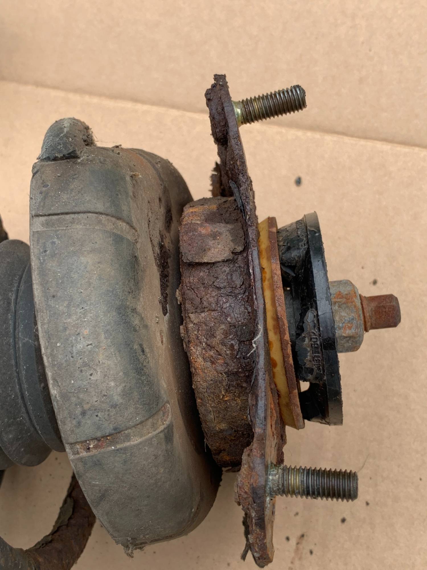

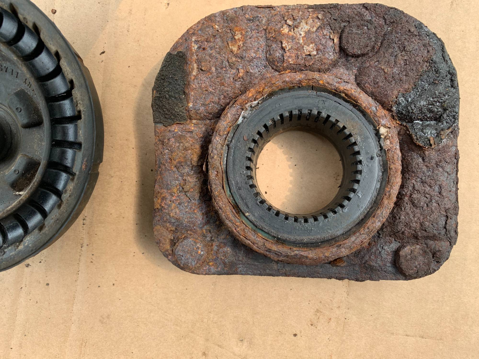

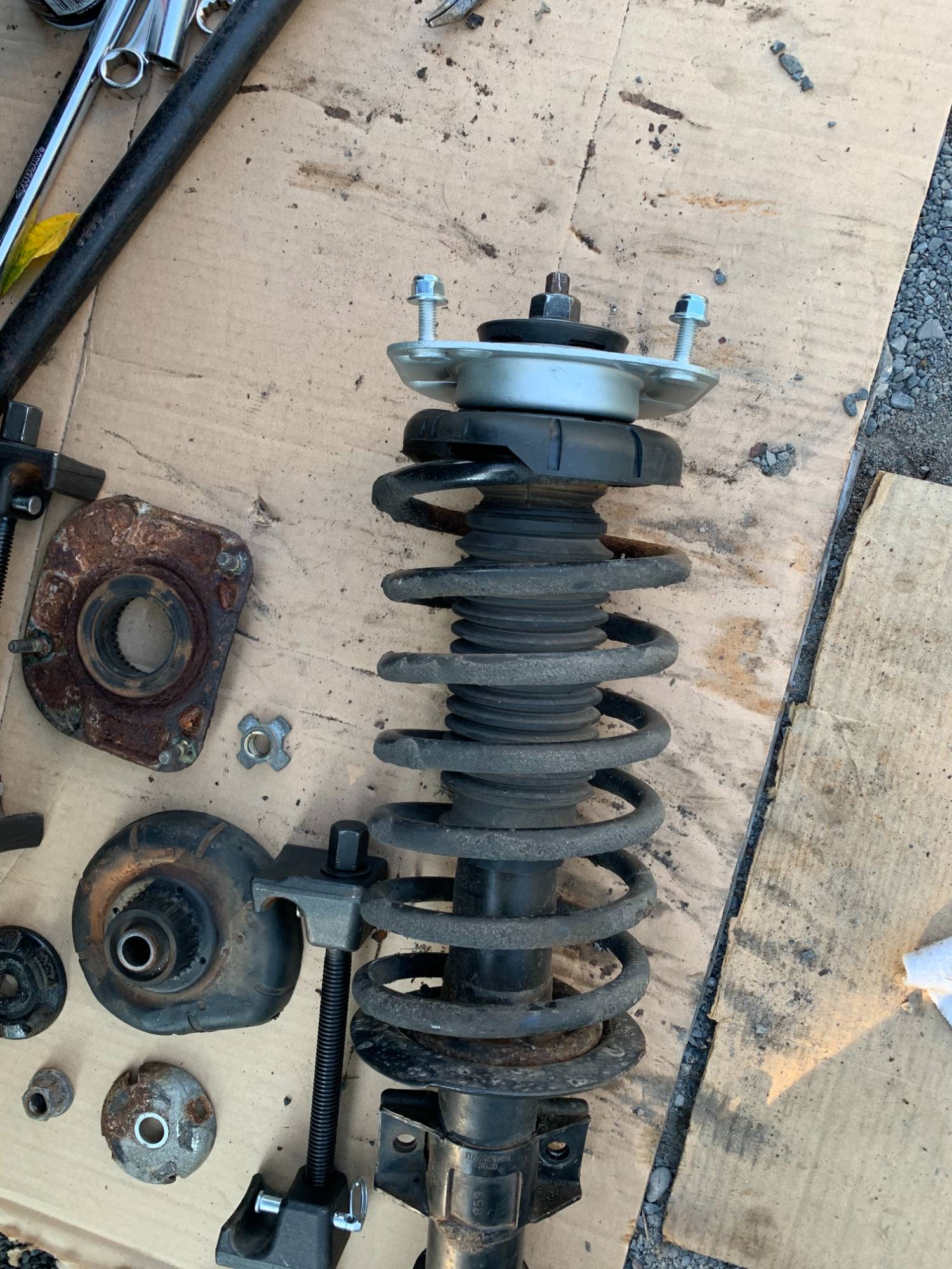

Finally had time to work on the strut assemblies on my V70 T5. Removed the mounts, washers, spring seats, cross nuts, etc., and replaced with new! The old mount was so rusted the bearing did not move at all. In fact, I had to spray some liquid penetrant on the mount where the bolts stick up to loosen the rust that had developed in order to remove the assembly from the body! Just have to lower the car and torque the primary (top mount) nut holding the new parts in place!
I've attached a few pictures:
Spring compressors really make this job easy!
Thanks go to Neil for his help on this project!

And wow... those are crusty. You never see strut mounts that bad around here.

I have never seen strut bearings that bad! Wow, you might be able to turn the steering now!
