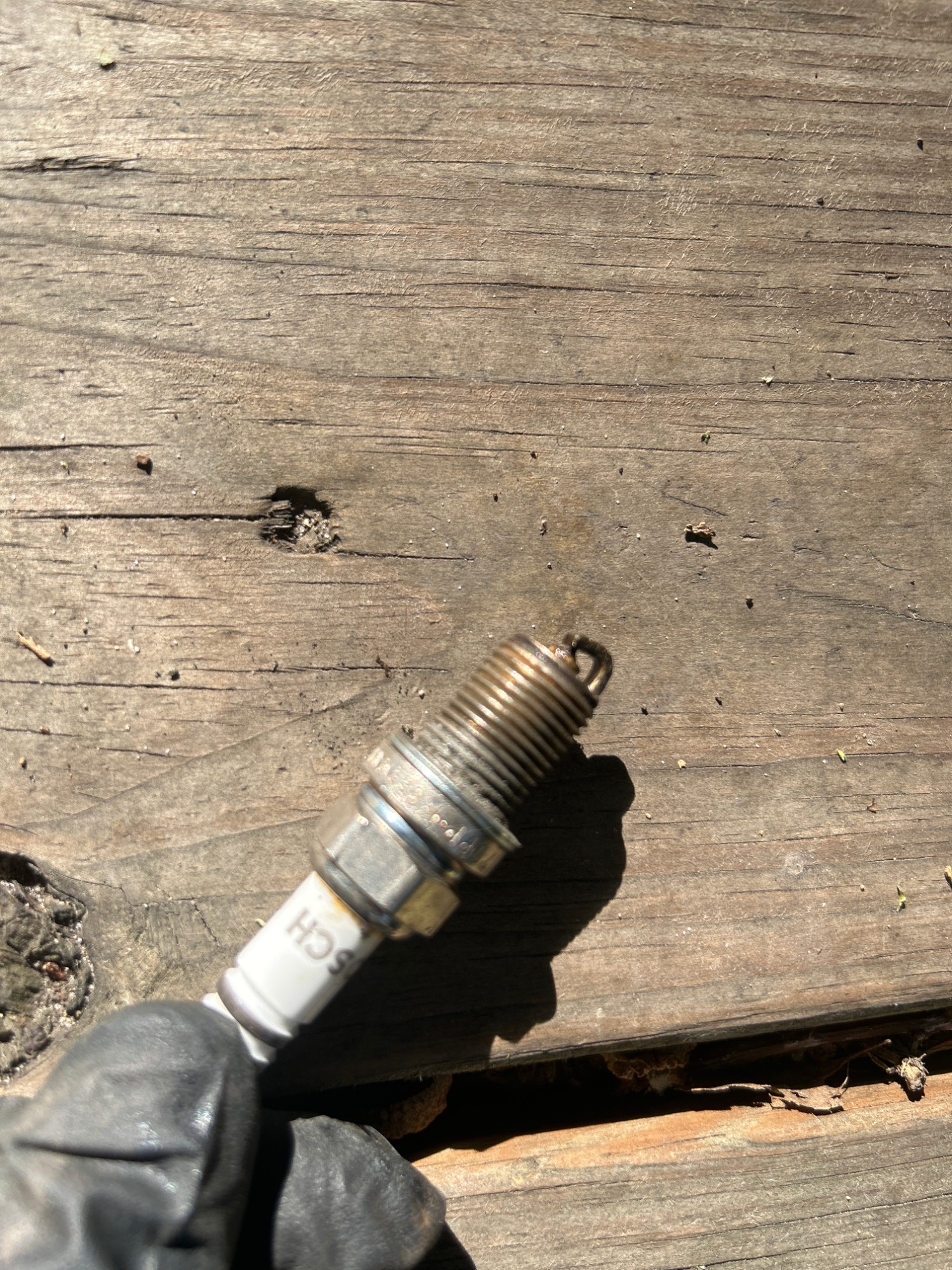

Went back to check with stethoscope and a mister for the serp belt. But it Wouldn’t make the noise, just had a rough idle. So I went down the line and pulled each injector. Every one of them affected idle except for number three. So number three is not firing. Pull number three plug, the electrode gap is smashed and the prong shows some scarring from getting hit. Here’s the plug.
Checked compression on 1-2-3 got 125-130-55. Checked each cylinder twice those are averages.
Do I stop now or try to do more troubleshooting? Seems the bottom end is in trouble given that plug damage? I could see then top of the piston in the plug hole, it looked fine there of course. Borescope time maybe; I don’t have one.

She has dropped a valve and has some bits in the cylinder.

Sigh. I do always preach that an engine swap is a better move than head work ...

Depends on condition of engine and accessories. Labor wise , about the same
Cylinder head job requires hood local shop
Erik , bottom end is fine because she drives like an adult and Babied it home.

I was referring to possible piston damage from whatever smashed the plug, that's all.
I do have a good local shop. Been 10 years since they did a head for me though.
- Posts: 36145
You will know when it opens up. But it’s it’s got 55 psi it isn’t catastrophic
