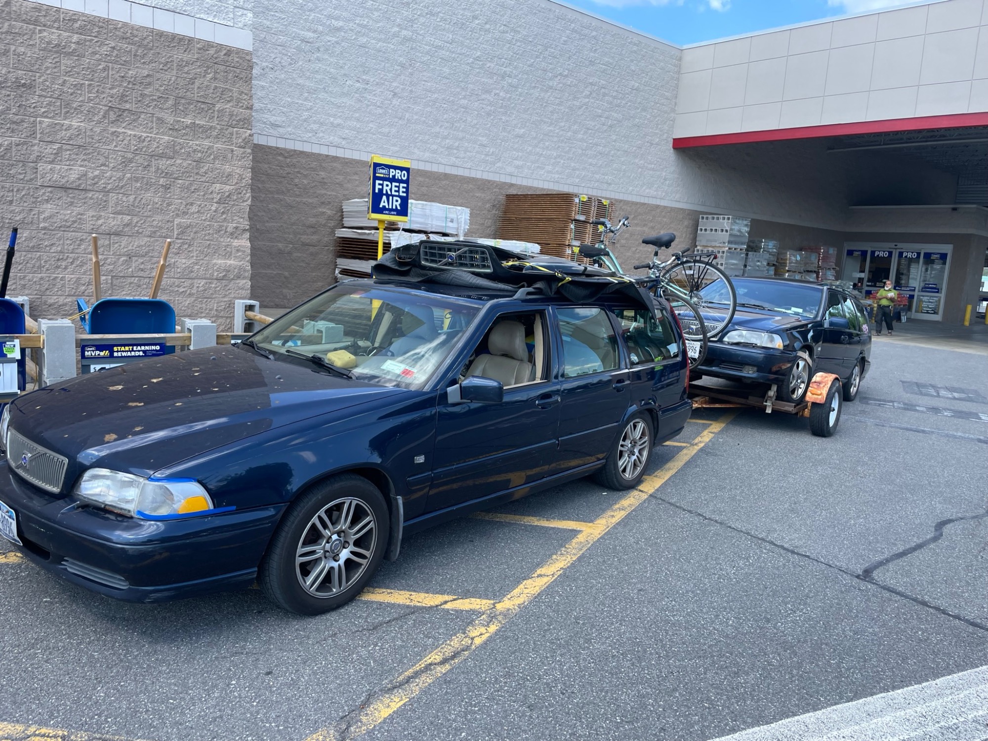

An air cooled type 3 weighs under 2000 pounds. You could dolly that nice and slow, but stop every 2-3 hours and let things cool off. With an M56, you don’t have to worry about ATF temperature!

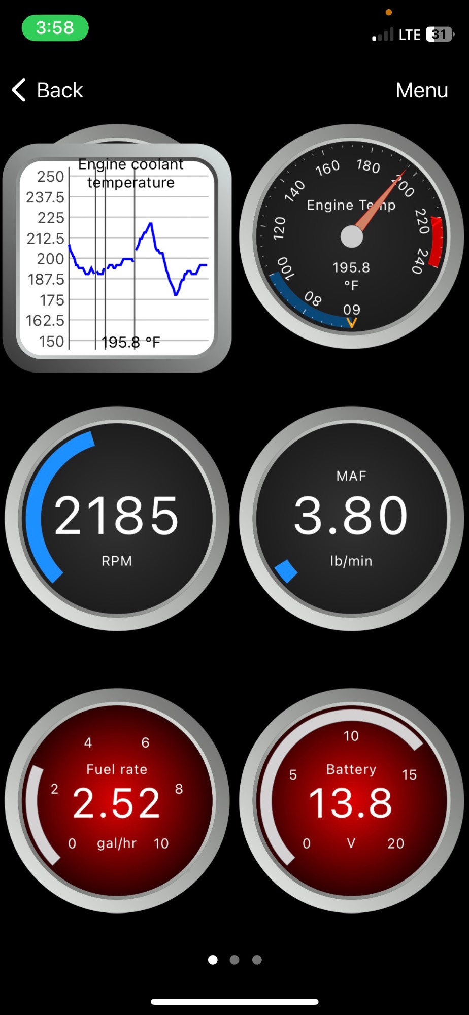

I just trailered a 3500 pound v70 with an NA V70 and it was near the limit of safe , power wise. Look at my coolant temps….

I towed this with the Curt , it’s fine
Not seen -another 500 pounds of Volvo parts in the car

That is the greatest photograph I've ever seen... thank you for filling me with sheer delight. The world of possibilities has opened up for me knowing that I own a tiny tow rig, and I'll likely put it to good use soon!

Take it slow, like 60 mph, and watch temps on grades. Stop and cool off on big hills at top
I was down to 45 on some of the mild grades in upstate NY
