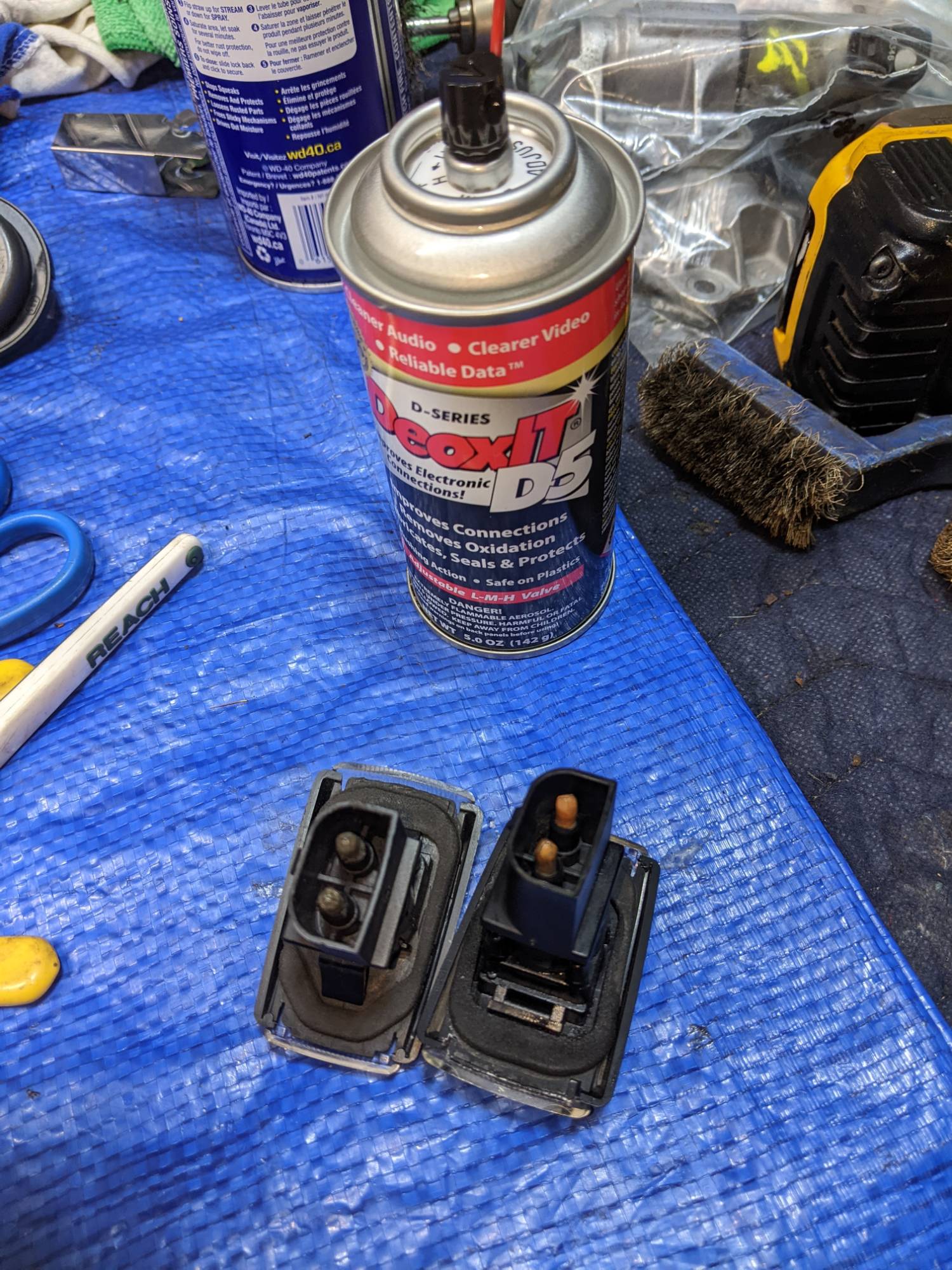

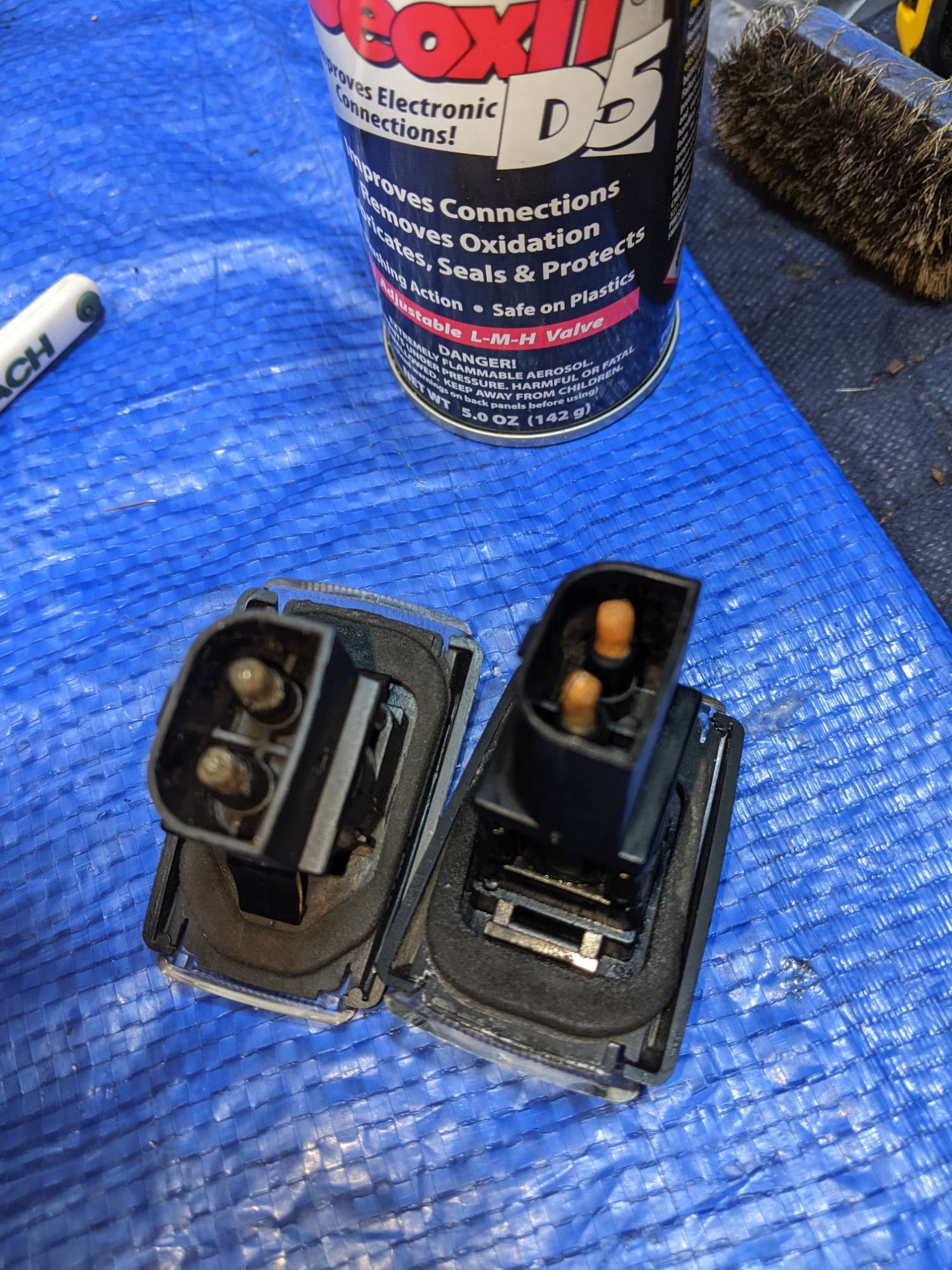

Thought I would come back to this as I have found a cleaner that has worked way better than any other offering I have tried.
The Product is DeOxit D5. I found that a local music shop chain sell this stuff for cleaning electrical contacts. Not cheap at $25+ tax here (about $18 US), but I found I did not and much and with the use of a cotton bud, a sharp pick and an old tooth brush, 5 minutes or so of effort got this:
I should add the one on the right was way worse then the one on the left when I started. I had tried regular contact cleaner on that to no effect, and made it worse using white vinegar and salt followed by baking soda and water (YouTube videos).
