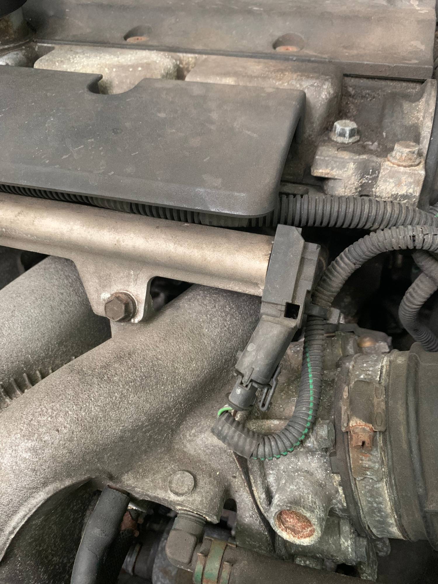

I have read that not all P2s have a fuel rail pressure sensor, but I believe I am looking at one:

Got a diagnosis of a bad fuel pressure sensor. Not sure exactly how this was determined, but the mechanic said the fuel pump was all good. The shop didn't have the sensor on hand, and I had plans to keep moving, so I decided to wait to get home to replace it. Having driven it to Toronto with no issues (the CEL turned off when I started the car to drive into the service bay—ha!), I drove it another 600mi with no issues and normal operation.
KWL in Toronto seemed to be a good Volvo shop, he had a long line of P2 XC70s out front and didn't charge for diagnostics. My V70 turns out have the steel fuel tank without a replaceable fuel filter, and the mechanic said that in his experience this is usual for non-turbo P2s—I have seen some back and forth about this in past threads.
Will replace the sensor, clear the codes, and follow up here with the results.

Exactly the same symptoms I had on my 2005 when my fuel pressure sensor failed

Fuel pressure sensor $43 from ipd installed today according to:
As in the video, this was quick and easy to do in my car—some other configurations such as turbo models seem to make the bolt that holds the sensor in place more difficult to access.
There is a relevant comment from peppermint (oragex on MVS) on the youtube video: I used vaseline, as he suggested, to lubricate the o-ring, as opposed to non-petroleum grease as suggested by the video creator. The only surprise was that the Schraeder valve on the other end of the fuel rail did not seem to relieve any pressure in the rail, although about 2 oz of gasoline came out when I removed the sensor. I drove yesterday, and I wonder if a lack of residual fuel rail pressure might indicate a problem elsewhere...
Codes cleared, engine started and runs as normal, no fuel leakage, took a short drive with no codes reappearing.
