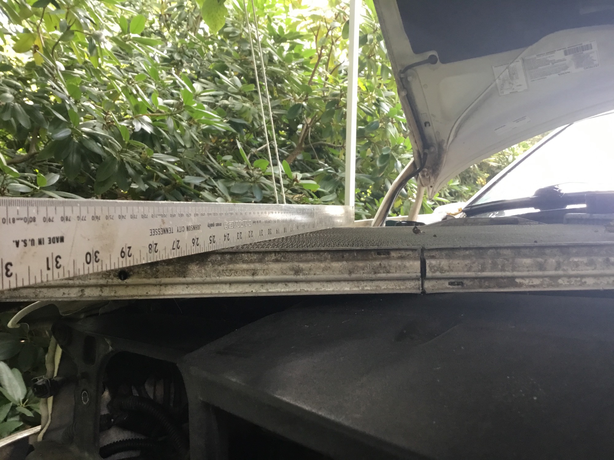

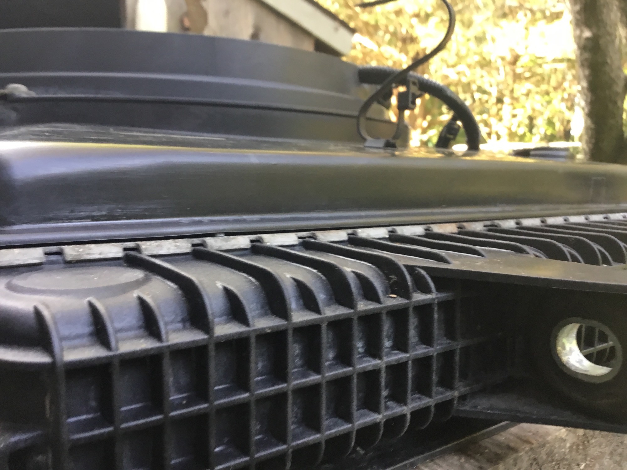

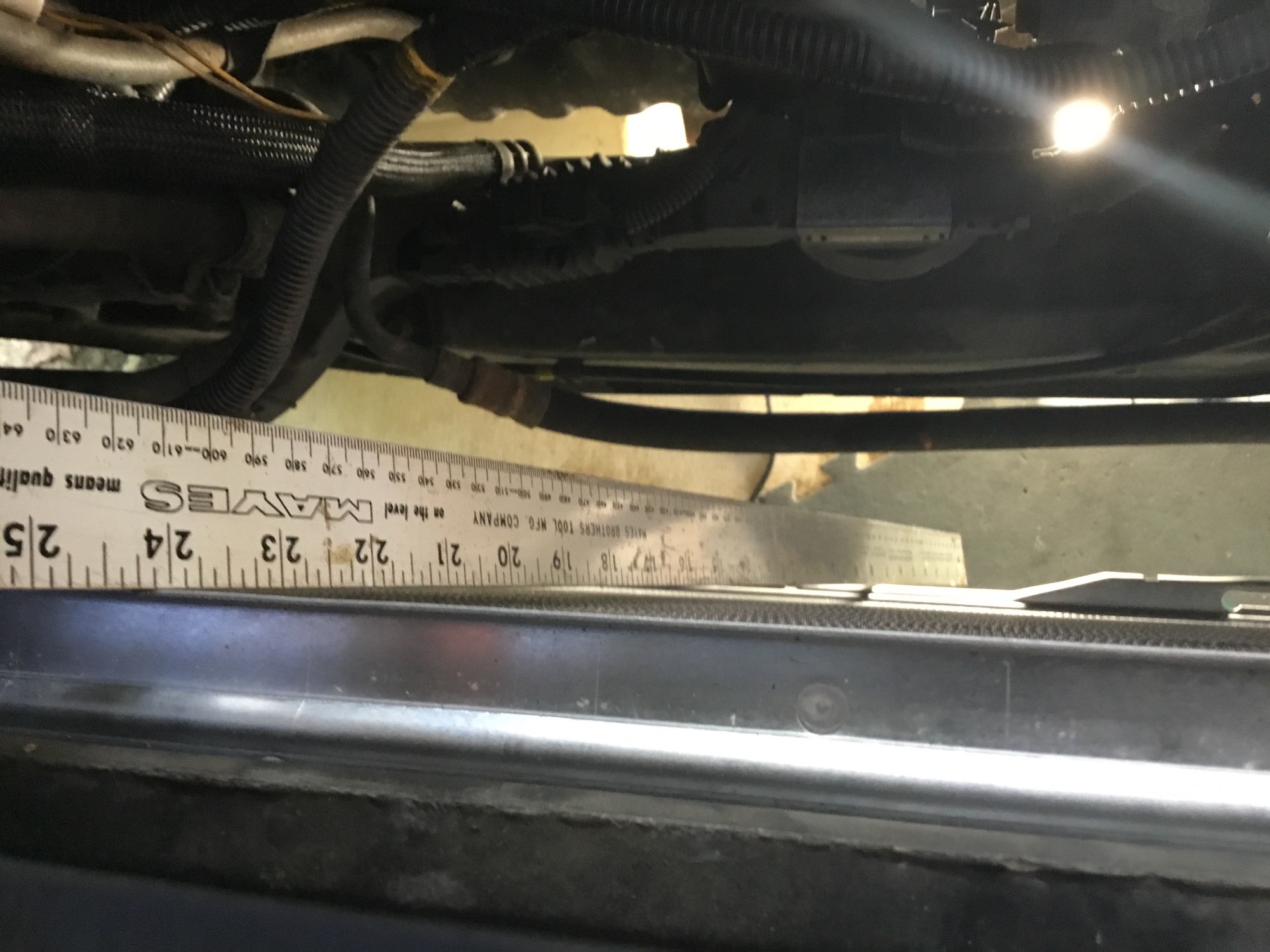

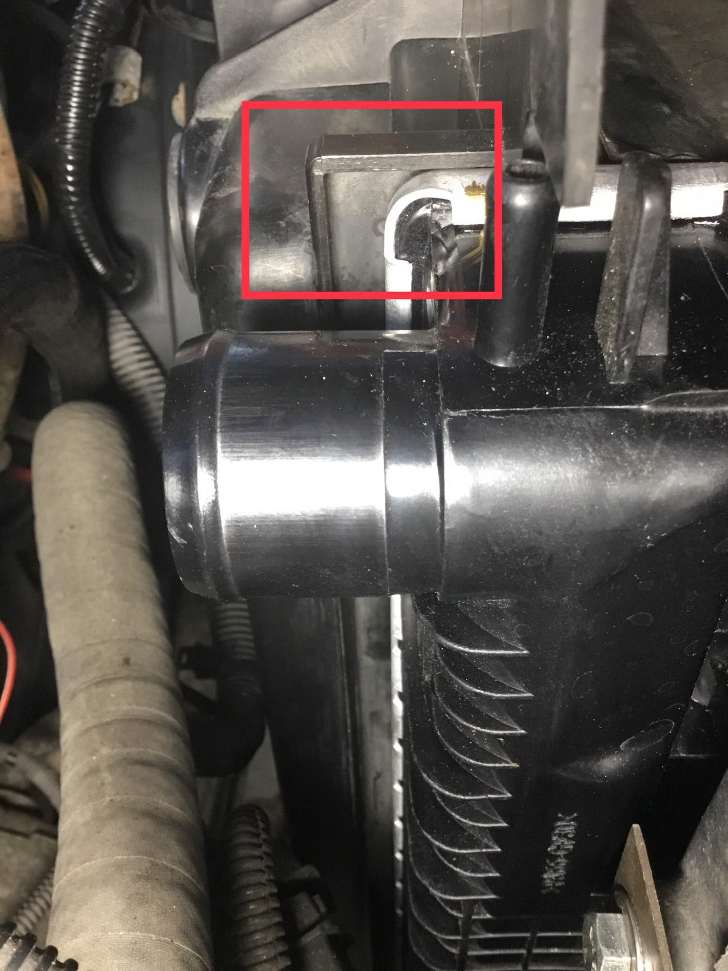

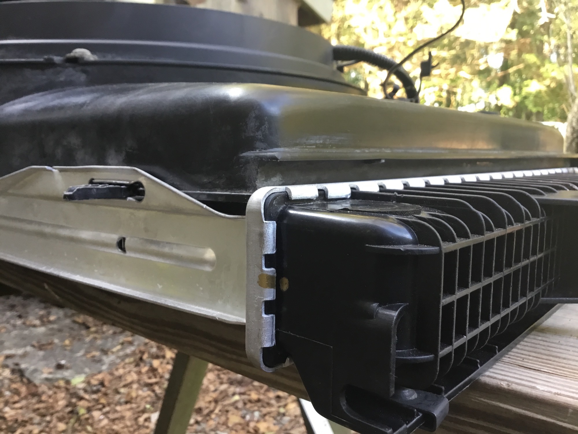

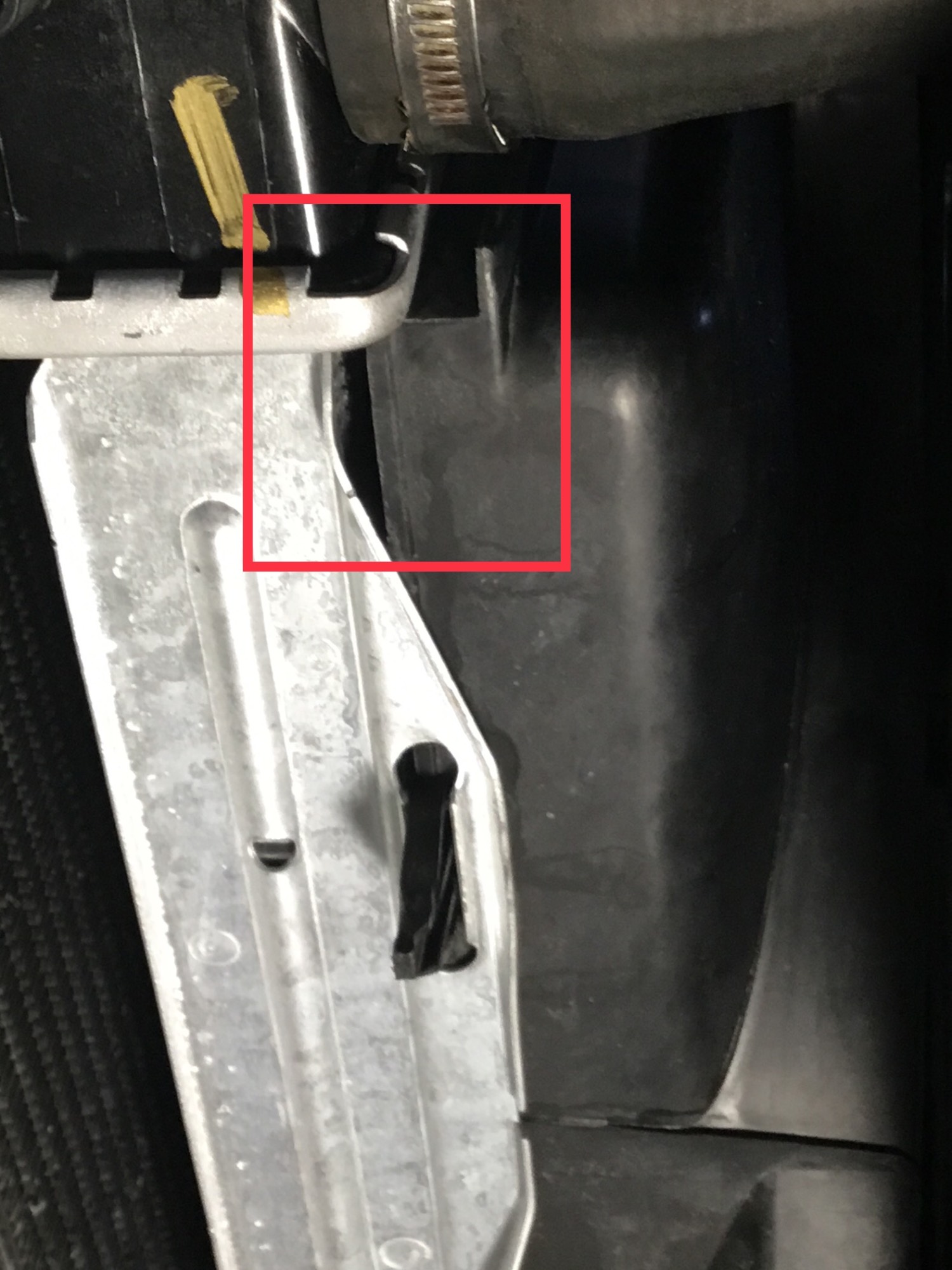

After finally finishing the headlight wiper motor repair and getting them reinstalled I set about to wrap up the radiator replacement project. Laid the new Mahle Behr and original side by side for “careful” comparison noting some minor differences but couldn’t really judge the merits or downsides of what changes I found. Installed the new mounting hardware and put it in the car. My wife helped me wiggle the fan shroud back in place and we set the bottom tabs into the radiator slots and pulled it forward into place against the condenser and immediately noticed it was not setting correctly against the radiator. what we saw in the car. the old radiator core sat flush to the back of the top and bottom frame pieces. The new radiator core is set in from those members there by pushing it away from the fan shroud and leaving those gaps all around.rabaout of the car again you see the gap around the new Mahle Behr. the original set tight with no gap.
Volvo engineers designed as system for optimum air flow through the system and that gap is an unacceptable construction flaw in my opinion and this part will be returned. Not sure what to order now. How do those Nissens fit to the fan shroud? Anyone have one? Abscate? I’m seriously thinking of driving down to Milford tomorrow and getting a Genuine Volvo for $357. But that would probably be stupid, or not. I hate this…(rearrange the last four letters!) But it’s never easy, is it. Hope your projects are all going well. Best, Peter

Try pulling It up a bit from those bottom tabs and see if it goes flush, then. I vaguely remember this on the Nissans in 2018

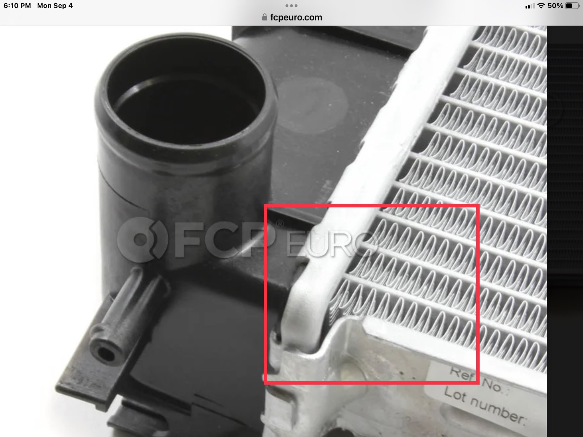

I’m afraid it’s siting where it needs to live. The top tabs on the radiator for the fan shroud bolts are tight to the fan shroud as well. It is what it is. Ineffectual junk I’d say. The pictures of the Nissens I’ve viewed, (carefully as I can in the ad postings) seem to show the finned core part of the radiator nearly flush to the plane of the bottom shroud tap slots and the top cross piece with the tabs for the u nuts
These are shots of the Nissens. Perspectives are tough but they somehow seem more promising.

I had no issues with my last Nissens but that was 5 years ago.

I put a Nissens in a couple of months ago, it fits fine. For information go to Rock Auto and look at their info listings for radiators. They list the Nissens core as being 1 5/8", the others are listed as 1 1/4". I suspect this is a case of (not) getting what you pay for.
