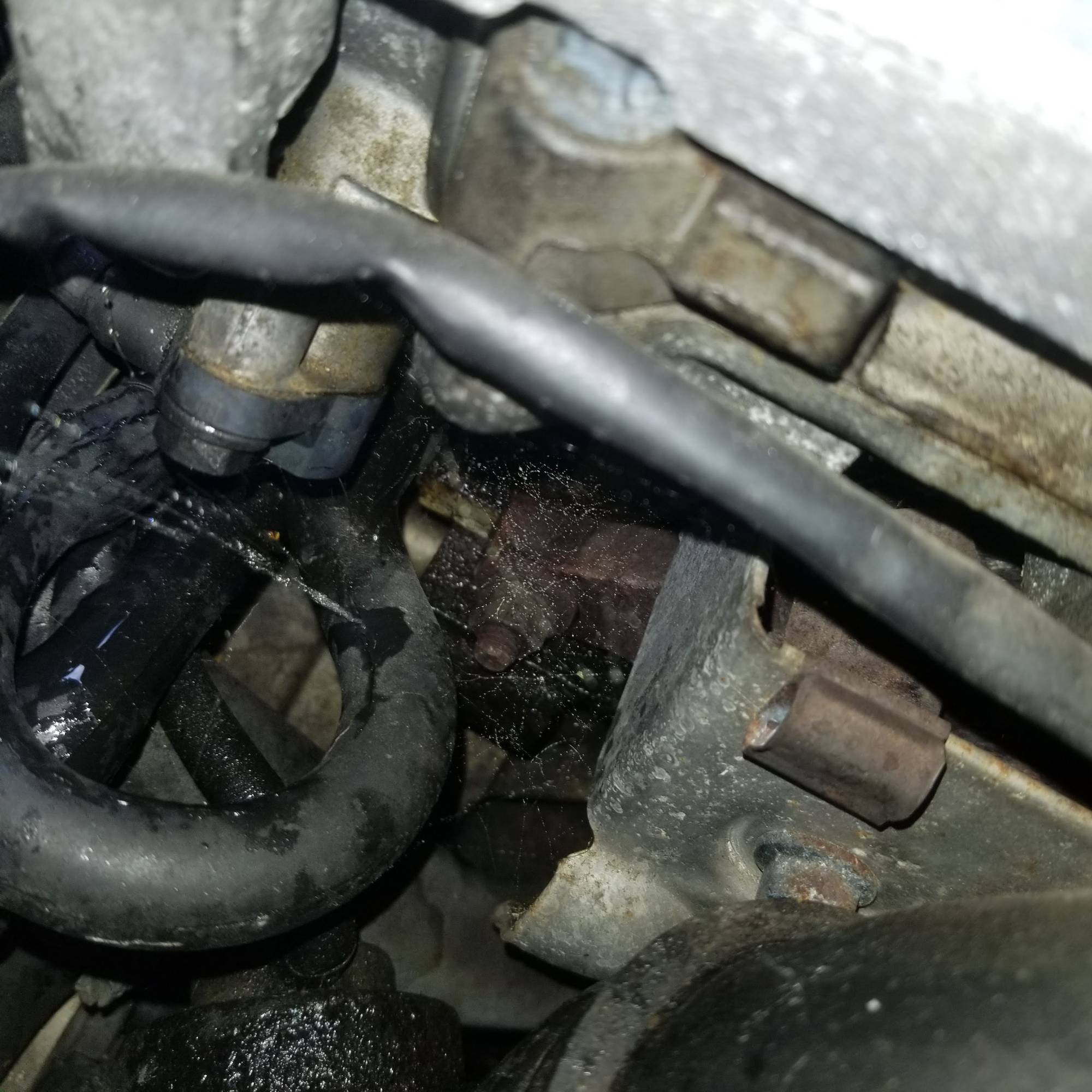

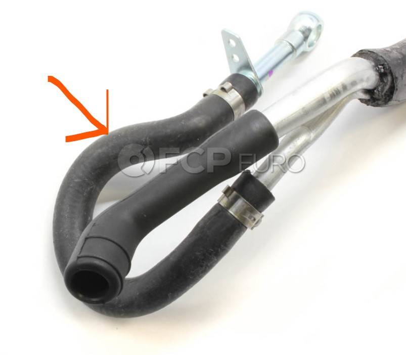

Driving the car around (after being on vacation for 6 weeks and replacing the dead battery) I noticed it was leaking after parking it. Coolant low message. Topped it off, got it up to temp and started hunting. After giving it some RPMs it was pretty clear. Old faithful spouting out of a "Ubend" leading from the crankcase breather assy PN 9470330 to a banjo bolt on the engine.
I have read through many of the fabulous guides here on servicing the PCV system. Replacing the entire Breather Pipe Assembly seems a little daunting due to my inexperience. I am hoping I can just replace the small leaking hose, and clean out / replace the banjo fitting. The other hoses/pipes look great. My local guy says he would require doing the whole thing, $$$, but that I could do it if I found the right hose. Do I need to bite the bullet here?
If I can just replace the leaking hose, what hose should I use? I have been unable to find a sub assembly for 9470330 to buy the hose alone. any tips on the process?

I'd be almost certain you will have to take the intake manifold off to access the hose to replace it. I would replace it with heater hose of the same dimension, not sure what that dimension is but it should be available at Napa or somewhere that they sell bulk hose, also insist on Oetiker clamps if you "repair" it. It's probably about the same amount of work to replace the PCV system and likely coming due soon enough with 143000K, did you do the glove test? It is a big job if you're not a DIY'er. I'm not sure why the throttle body would need replacing though, they usually respond well to a good cleaning.

Here's IPD's kit that includes the hose.
My mechanic changed that same part for about $400+ if you don't want to do it. But yes, you don't have to remove the intake. You just work on it from the side not the front.

You can replace that hose on car without removing the PCV. I’ve got the hose measurements somewhere. Use good closed band or oetiker clamps. It doesn’t have to look just like stock but be aware of where it routes so it doesn’t chafe.
