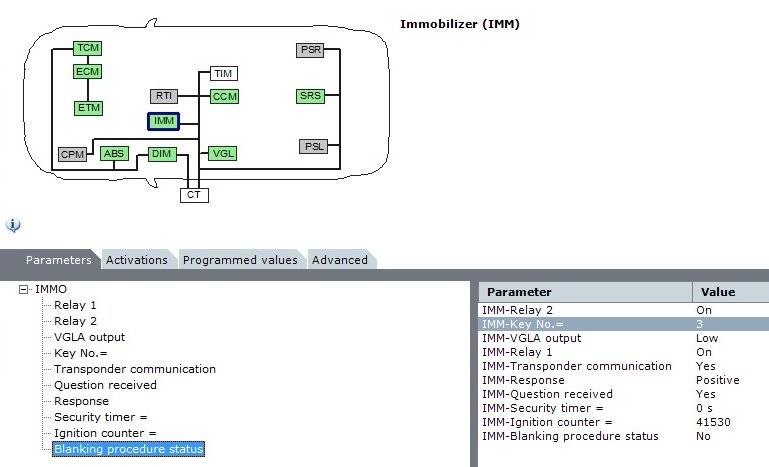

Debugging continues. VIDA shows IMM-321 Faulty comms consistently. I am going to have to verify the wiring between the ECM and the immobilizer modules. VIDA shows the IMM is recognizing the key and giving a positive signal to start. At his point it looks like either wiring or the ECM itself is bad.

Well as you get positive Response and Question rec. in live data so Immo responds ECM ok.
(Additional clarification: Immo is told all clear and it doesnt anymore stop engine running during start)
This fault code happens too if there happens a unusual reset like engine cut off other reasons.
You say it runs even up to 5 seconds. Thats would be for me a clear signal its not about Immo as it always only gives time for two seconds (including crank) when Request was not received or not positive.
How this works is that ECM sends request to IMMO first always after you turn ignition On. Immo then responds back was it positive or not correct data (communication is fully encrypted, it includes random calculation plus engine code).
My best guess this fault code gets registered if there comes new request before Immo box gets shut down (like if there was already one successful one or it become too late but this would be registered in live data and NOT show all Positive in Response).
I have once read this fault code can come too if you have bad fuel pump.
Does your fuel pressure drop when crankin or starting happens too much?
Does your battery go too low during crank?
What data shows on ECM side? You lose connection during crank to it?
Maybe ECM resets unusual way during crank and asks again Immo some nonsense.
