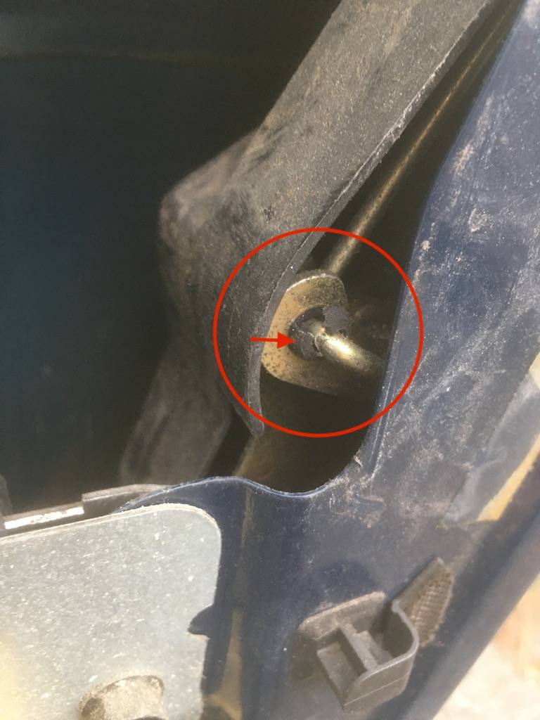

Hy Buddies,
Recently i've been unable to open the door driver side from inside. Have to get the window down and use the handle by outside. The reason is rubber clip that hold the metal clip itself: a picture explains more than words... apparently no reference on the Volvo parts Web.
May someone tell me where i could find some to repair my door or has any solution ?
oeilleton caoutchouc.png (450.84 KiB) Viewed 212 times

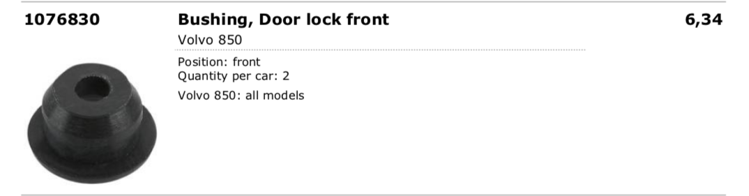

Skandix is your friend...
Capture d’écran 2023-10-15 à 11.22.25.png (55.91 KiB) Viewed 199 times
