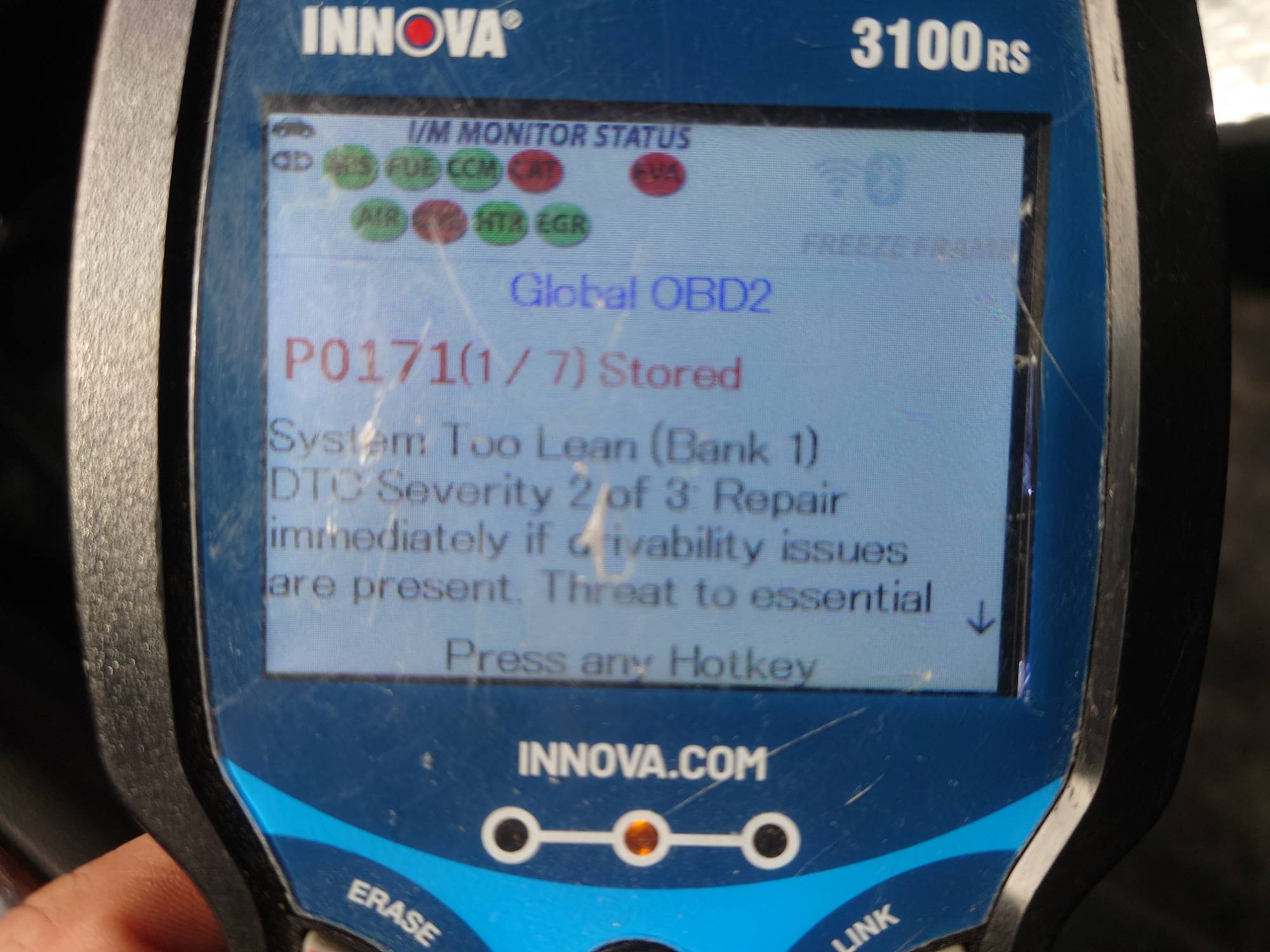

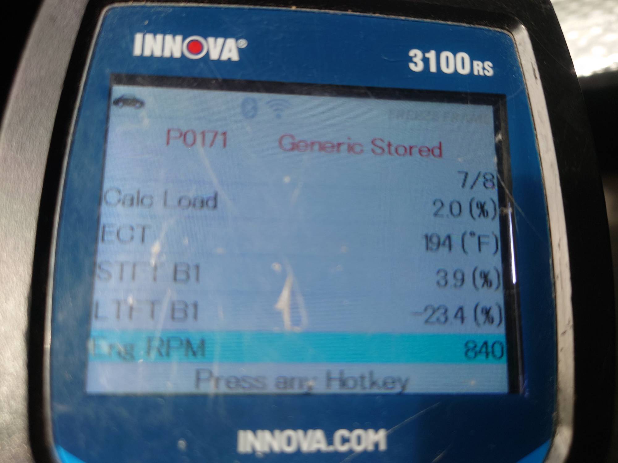

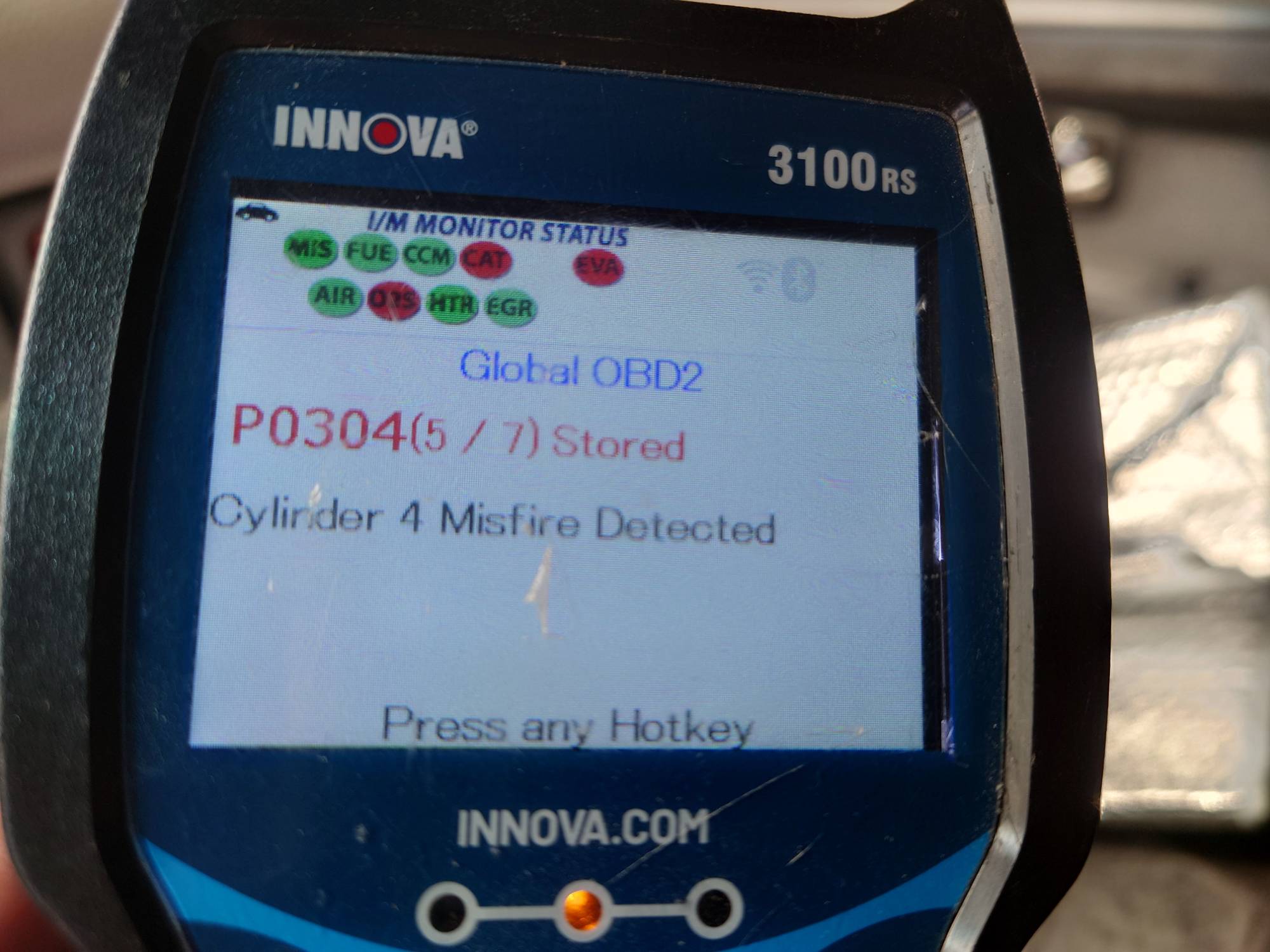

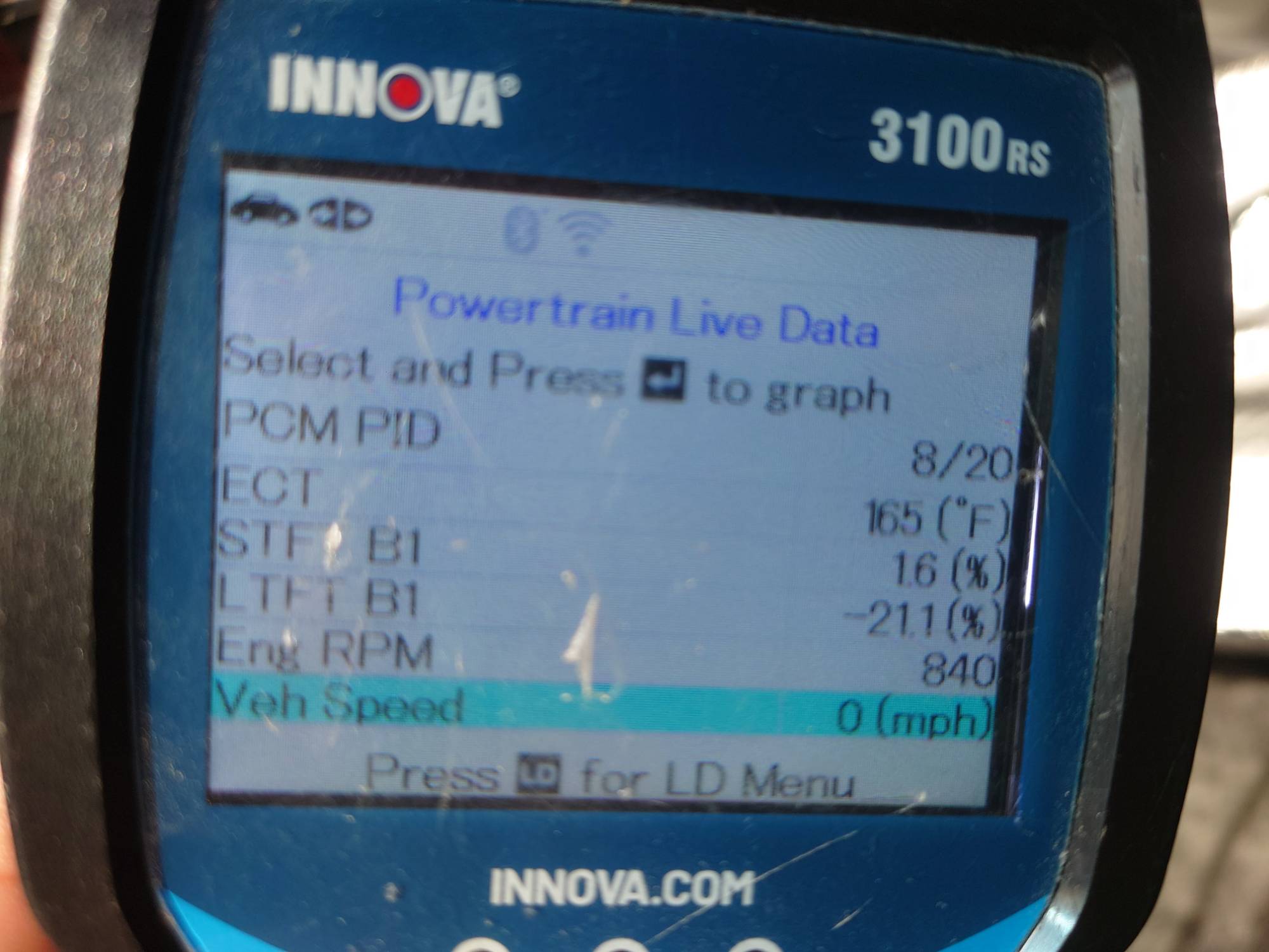

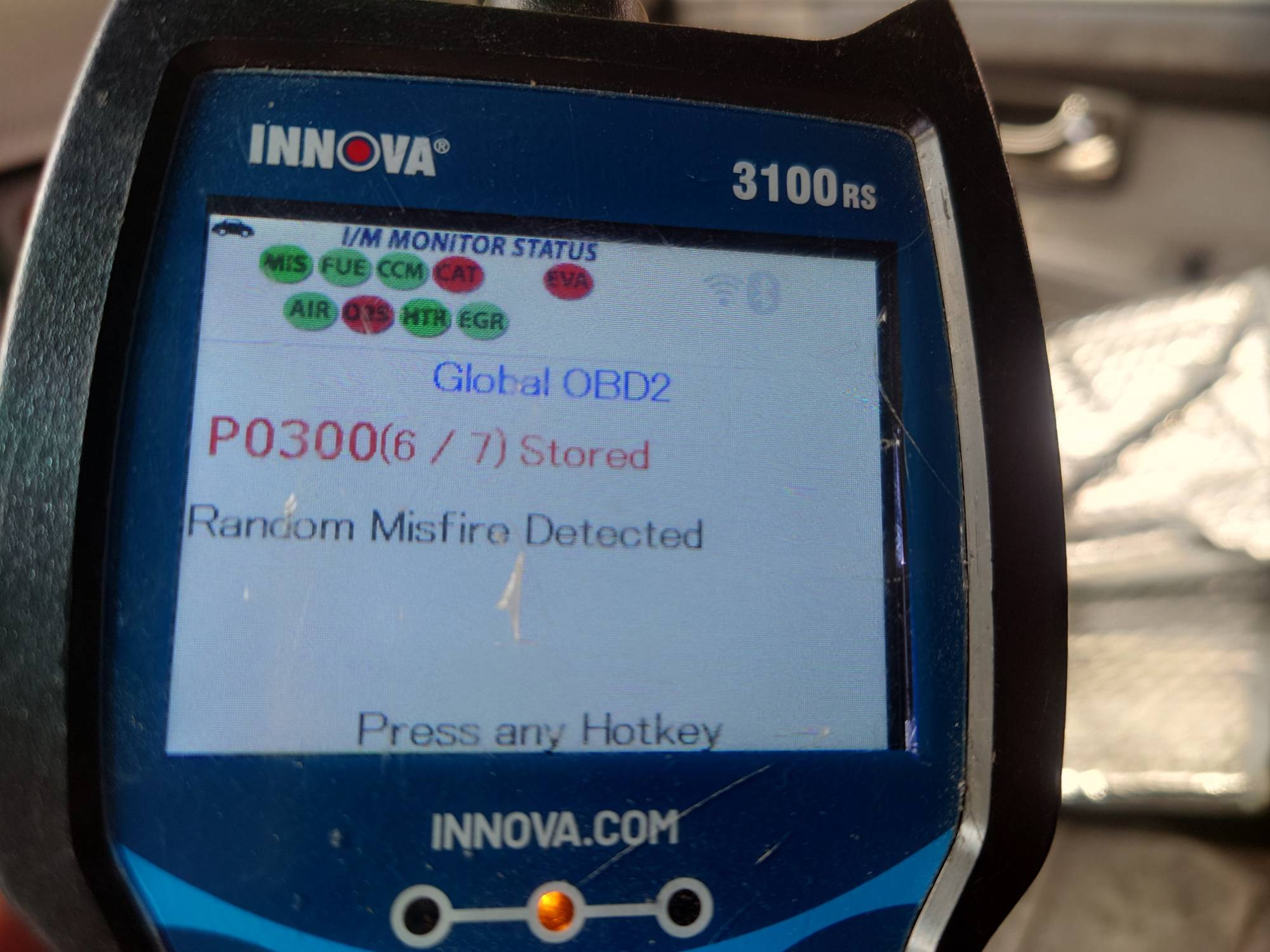

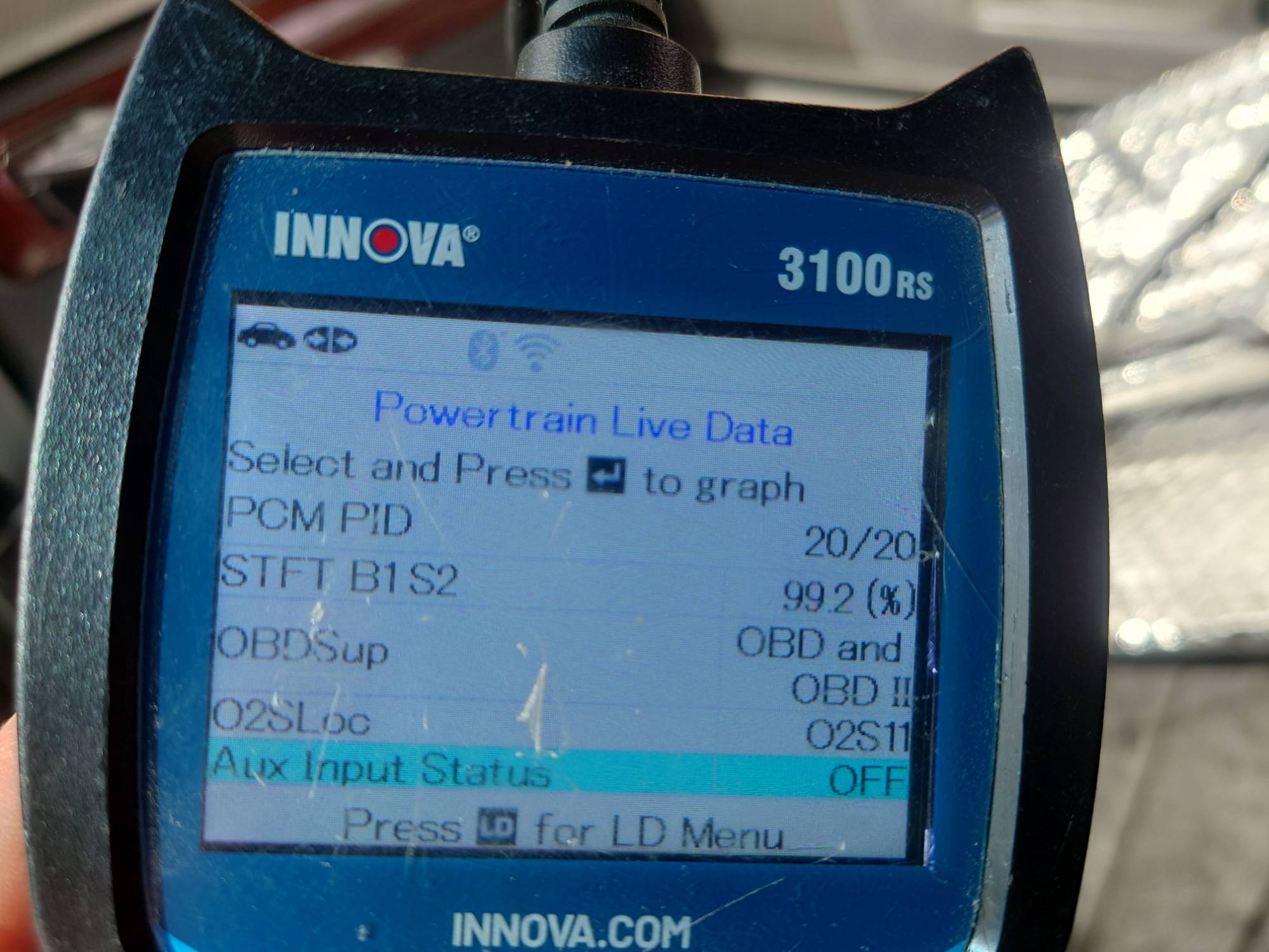

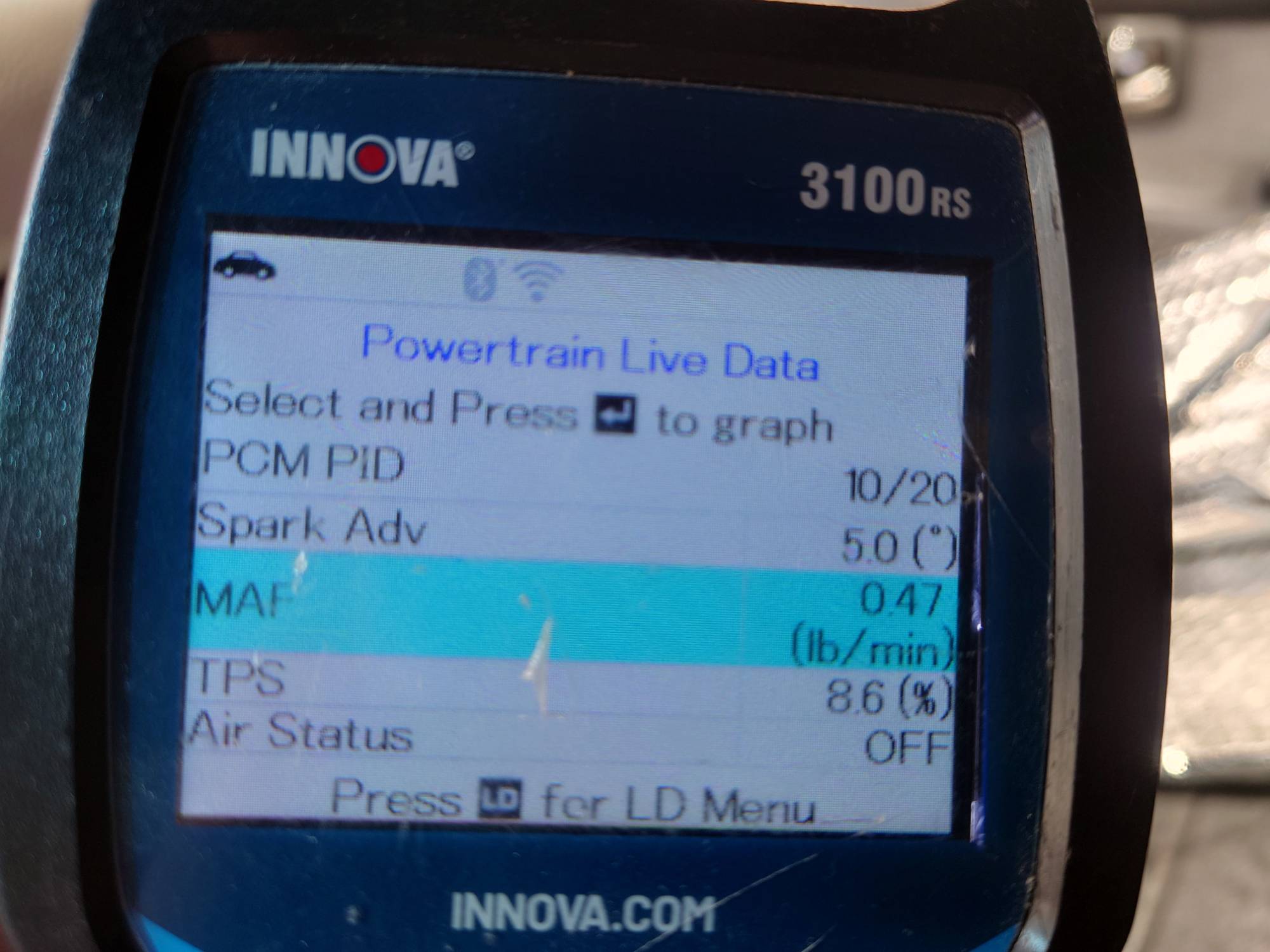

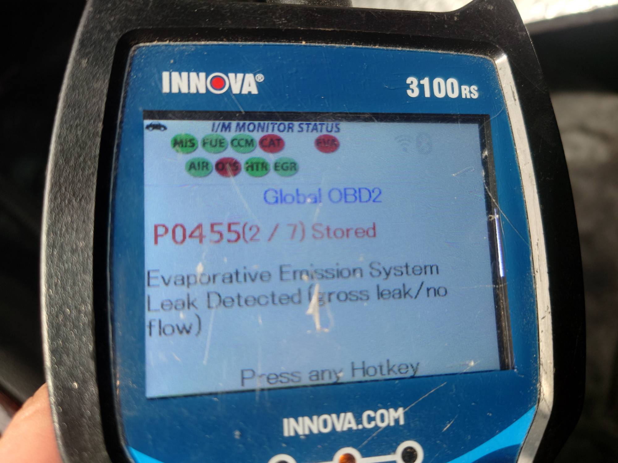

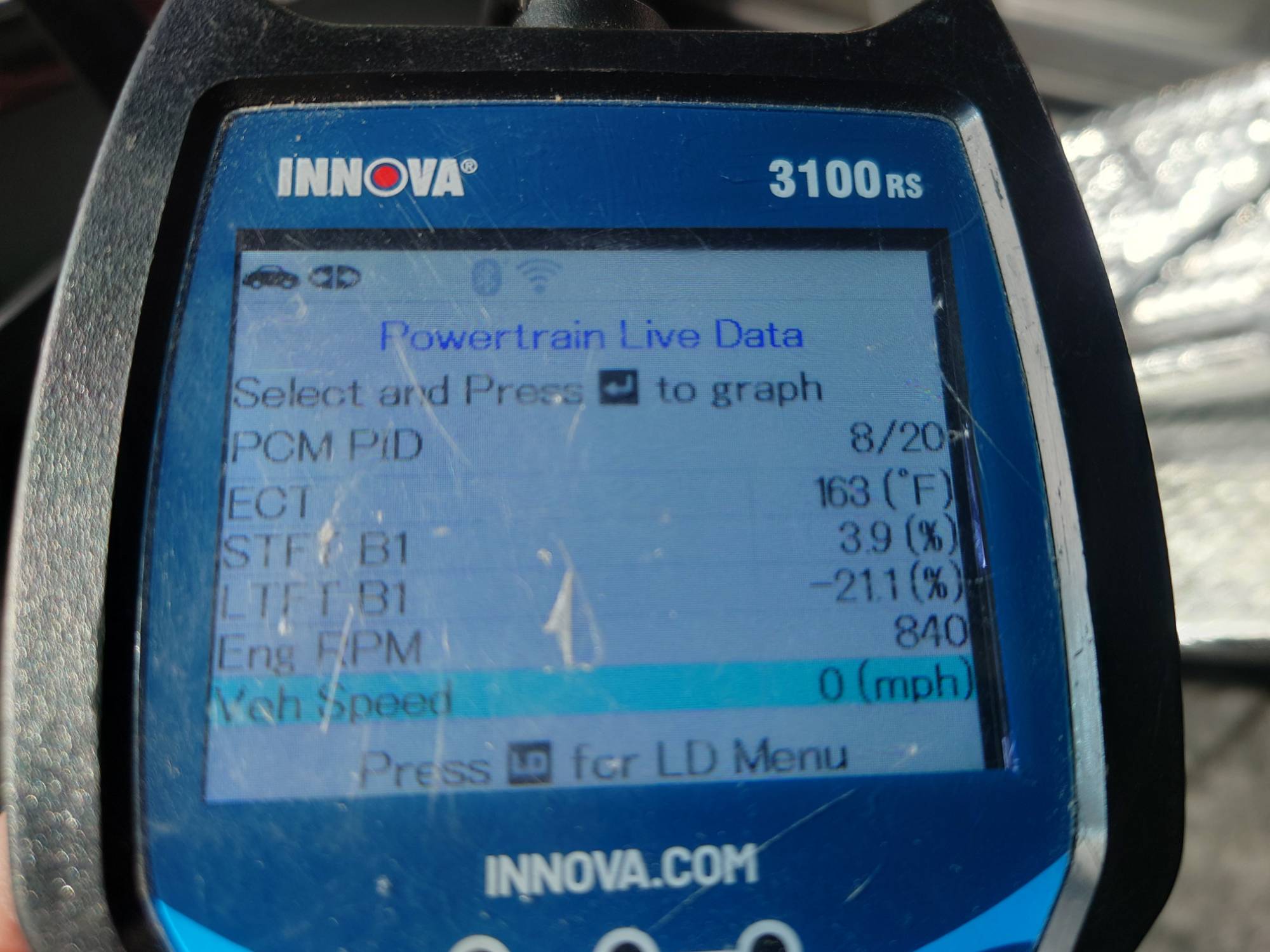

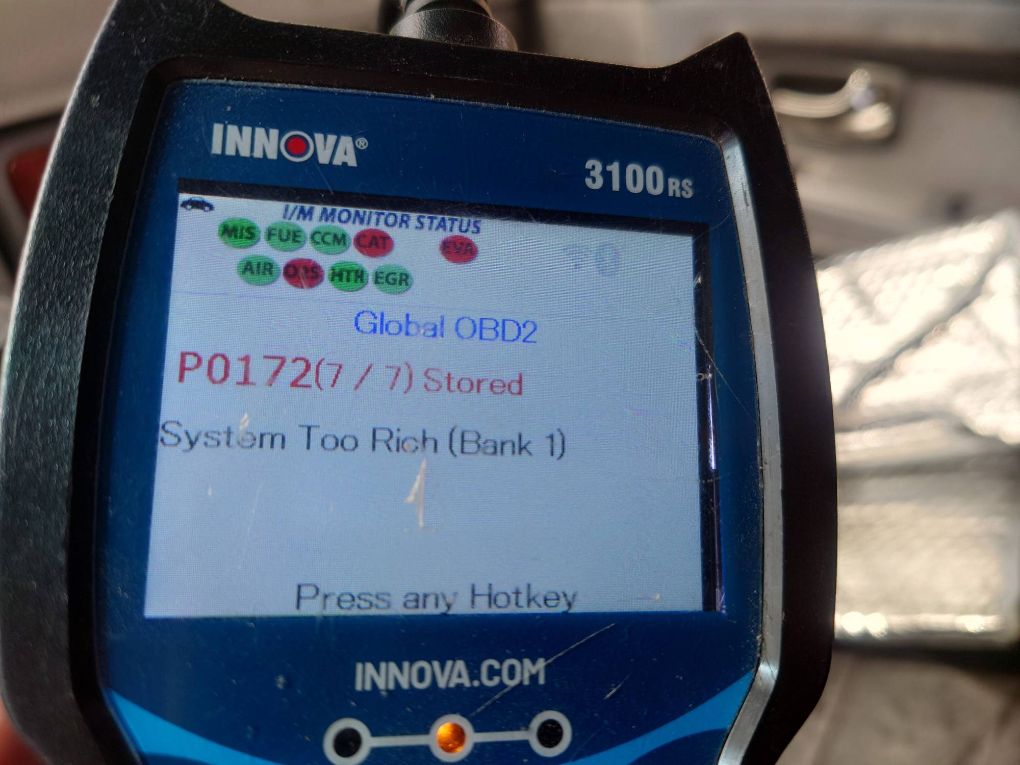

Codes and live data attached. I wiped all dtc when finished reading the scanner. The temperature read as 160F going up while running. I thought there was 1 red relay on this car (fuel pump, red red with green). Turns out there are 2 and I have the wrong one (intermittent wiper? red with dark red). I have a mis on #4. I heard something about #4 being a common issue on these. Am I correct and, if so, what was that issue?
