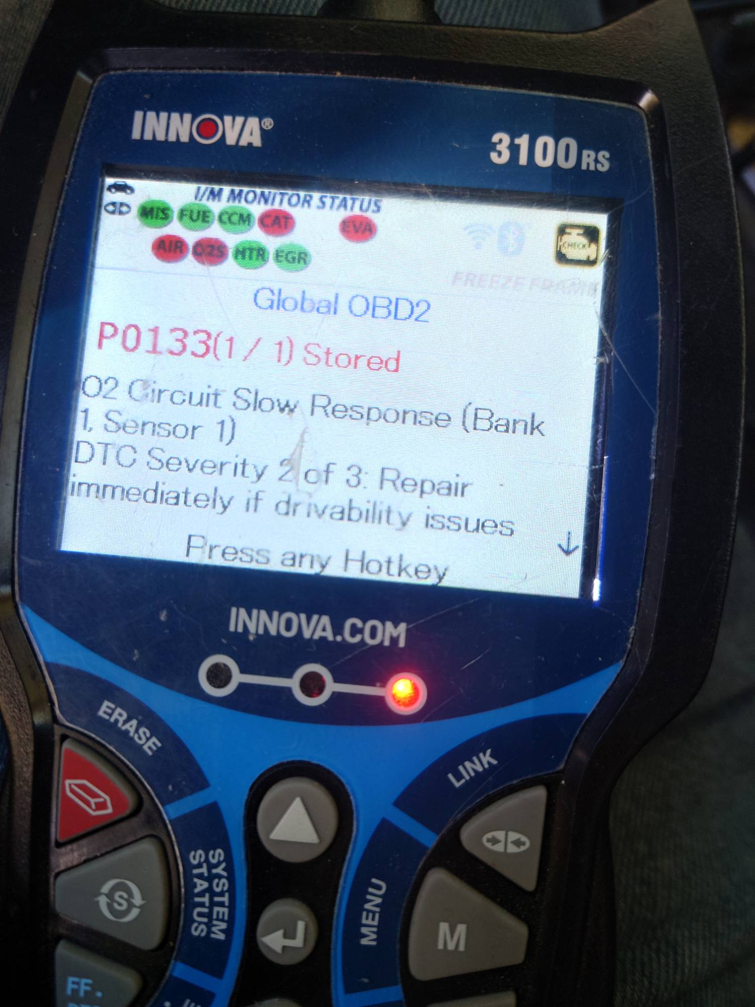

You have simultaneous too rich and too lean codes. Fascinating.
Your long term trim is very high at -21% which suggests a bad over rich condition.
Fuel pressure
Leaky injector
MAF problem

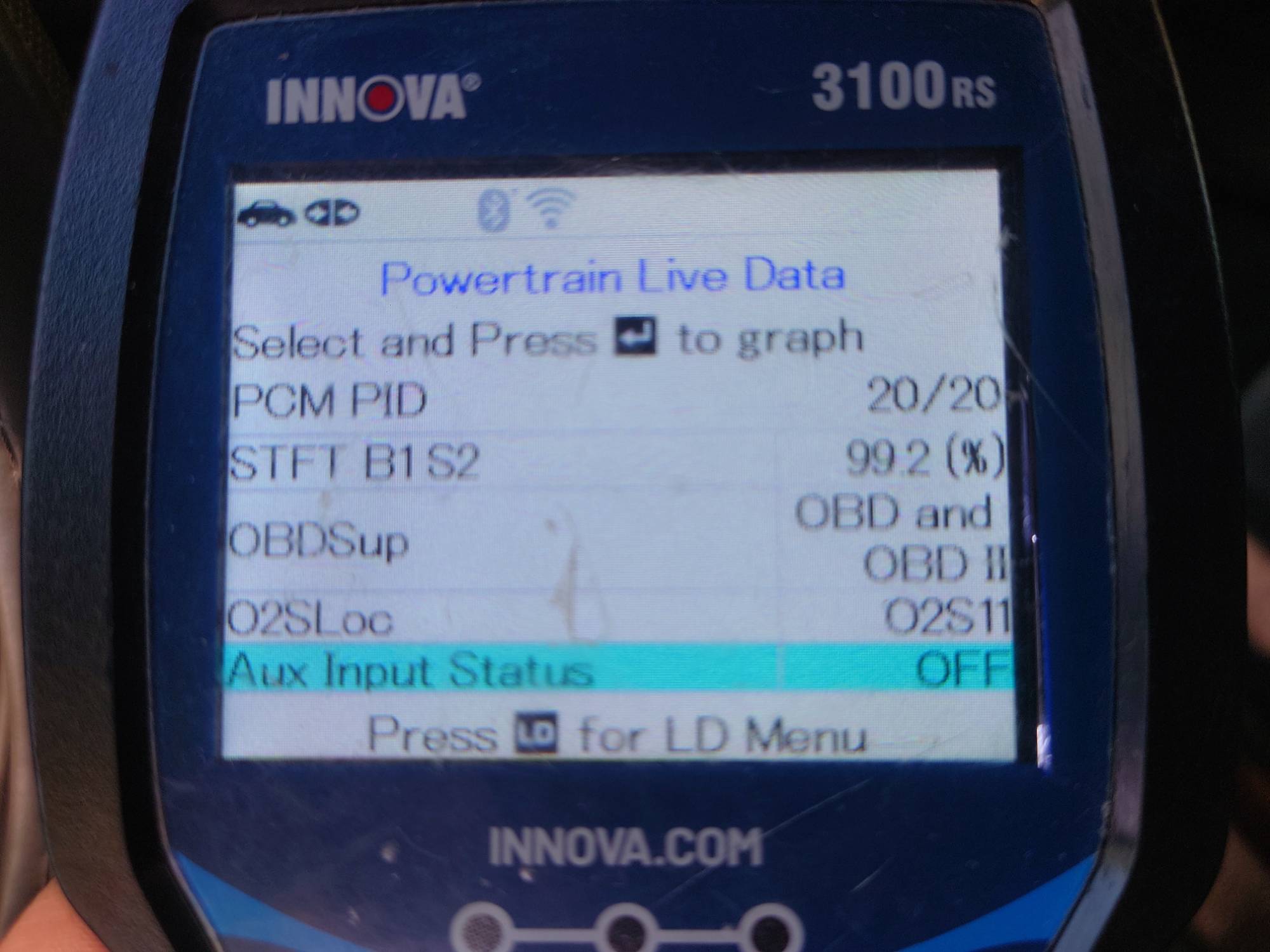

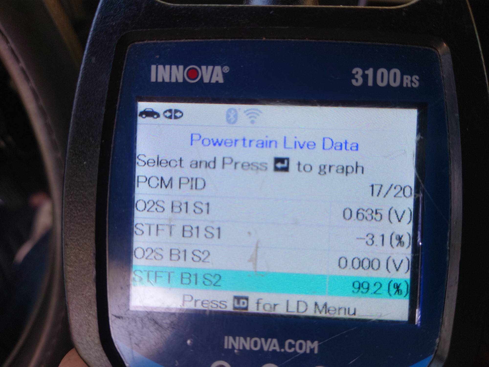

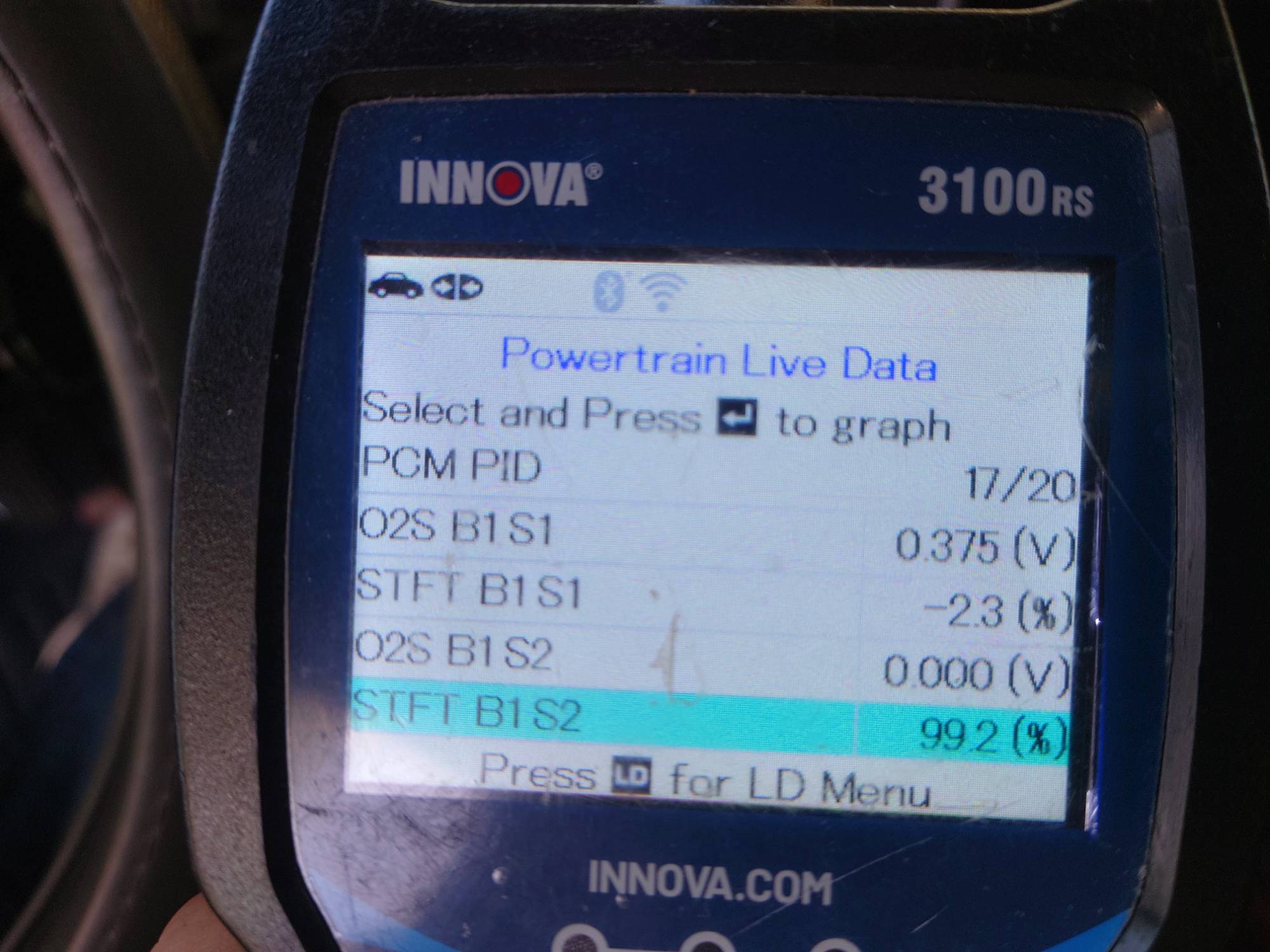

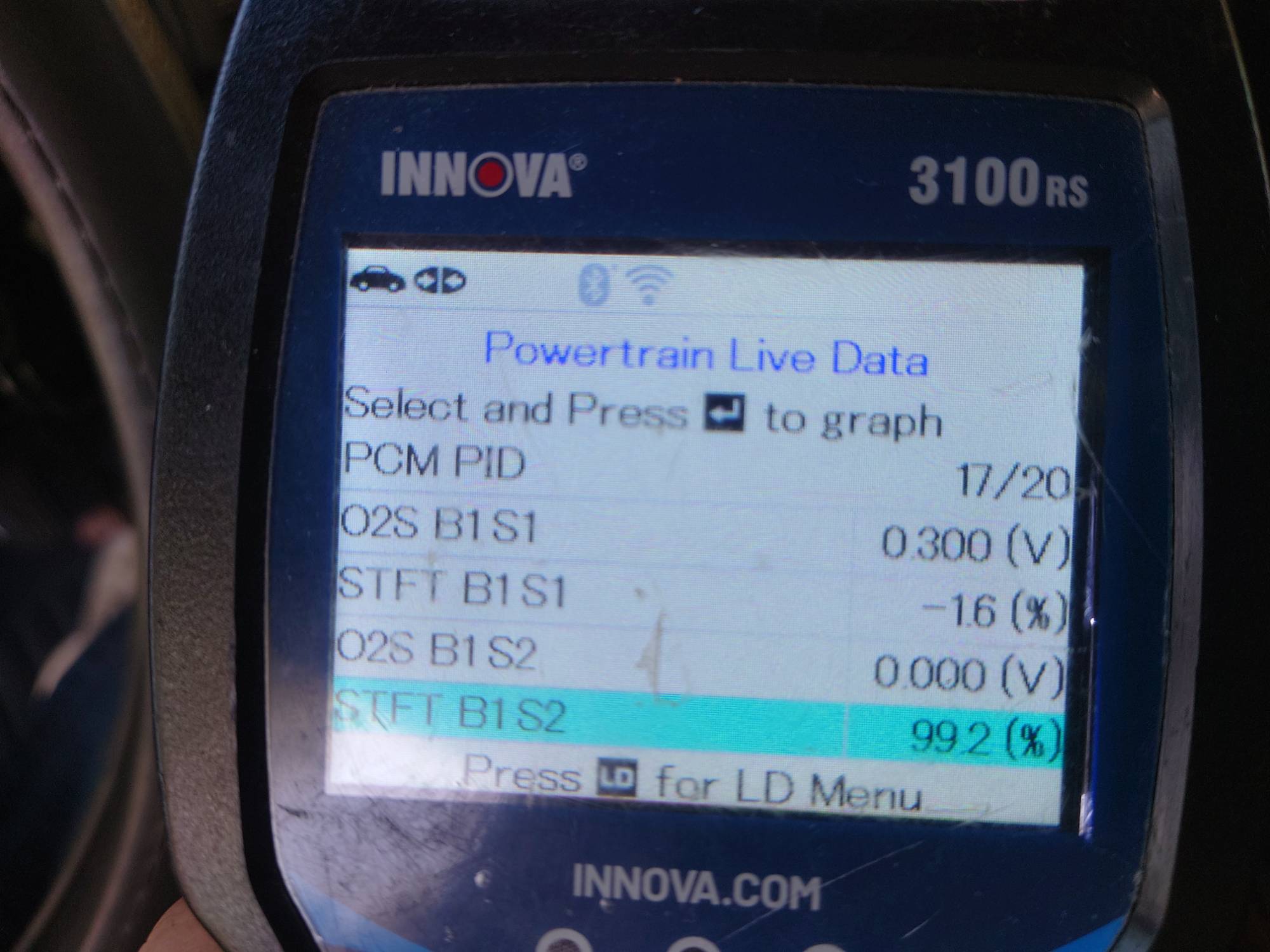

I didnt think I had O2 sensors because PO cut out the half-alive cat and put a straight pipe there. But yeah I do..... And now 10min later I am back. Everything O2 related attached below. Be sure to pay attention to the names/labels on pics.454cid wrote: 19 Oct 2023, 07:42What are we looking at here?CIK7 wrote: 18 Oct 2023, 17:43 Besides your input, something tells me I need a new coolant temp sensor... Joking aside, I am surprised I failed to notice this until now considering that I try to keep the car shipshape. I look in the engine bay every few days for one reason or another.

I have not checked the codes in quite some time. I think these are just stored codes. Ill come back and update y'all once I have the new coolant temp sensor and fp relay installed.abscate wrote: 19 Oct 2023, 02:36 You have simultaneous too rich and too lean codes. Fascinating.
