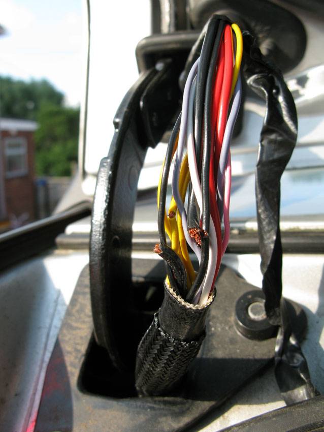

I looked at my tailgate and made this photo. This is 2001 V70. I am not certain this wires shown cut here are the wires for the open/closed switch. They may be the wires for the lock actuation motor which I removed when it failed. I don't remember if these wires were for motor or switch or both.
To access these wires, the lower half of the tailgate inner panel must be removed and you some of the attachment clips may break in the process.
Search for other posts about specific location of the alarm with internal battery.
This is the best information I have. Use it at your own risk.
