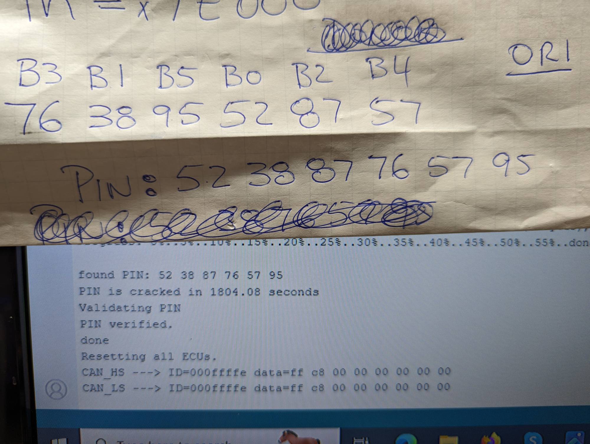

Got my Cracker done today, and works. Thank You guys for all hard work.
