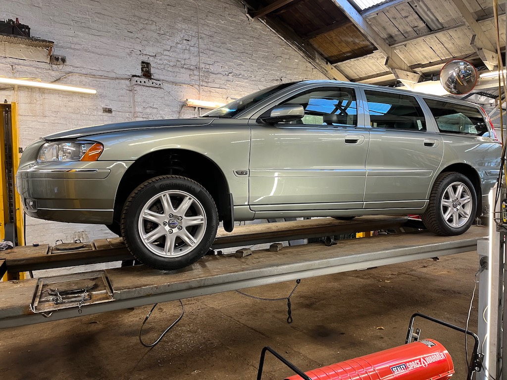

The MOT for the V70 is due next February which would mean anytime from 21st January onwards it could be done. I decided that I would rather loose a few MOT months this year and have an October MOT next year avoiding having to worry in the middle of winter if anything was needing repaired.
A straight pass was issued and tester said it was the best V70 he had seen in years

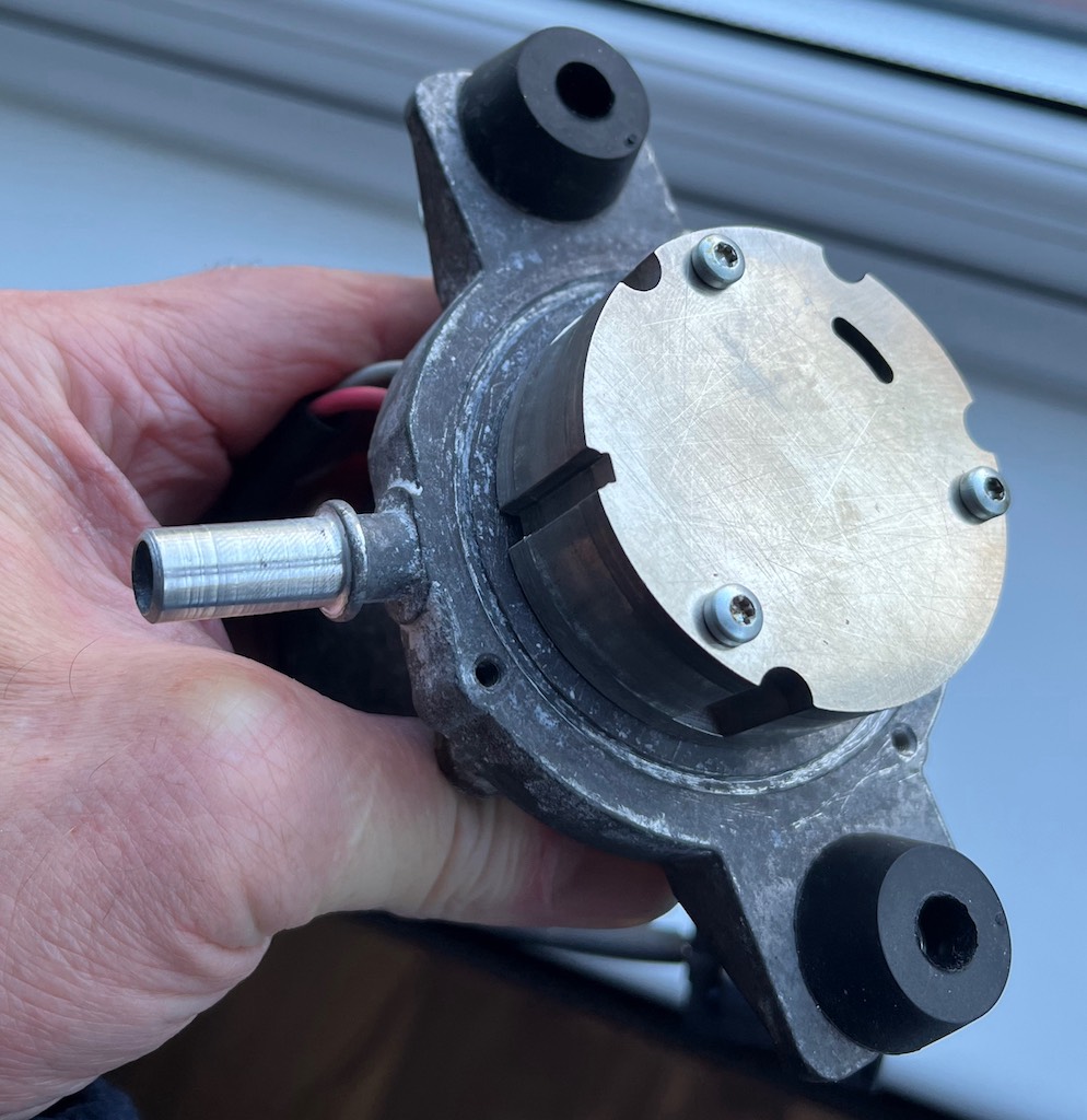

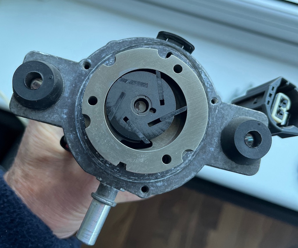

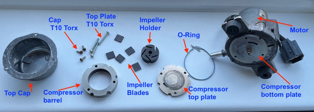

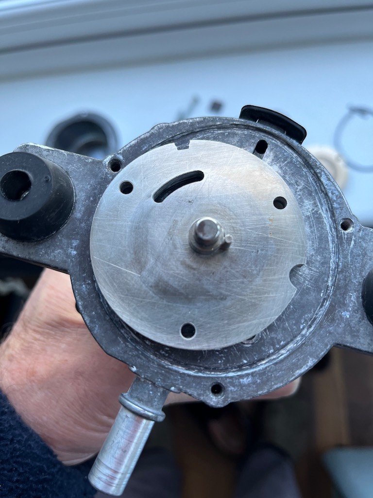

Now that I have the new Hella pump fitted and it works correctly I decided to have a look at the original pump to see if it was salvageable.
3xT10 Torx screws hold the top-cap down, one came out the other two were too rusted and the Torx just turned in the head so a set of Mole-Grips managed to remove the screws, once removed I put them into the vice and I cut a straight slot in the screw-head to allow me to reuse them.
Once the top-cap was off it was apparent water ingress (possibly condensation) was the issue, the entire inners were covered in white powdered alloy oxidation (sorry no pics). I removed the top plate 3xT10 Torx, removed the impeller and barrel. The bottom plate was so crammed with oxidisation between the motor body and plate that the plate would not sit correctly.
With the top compressor parts removed I connected the motor to a battery and the motor spun freely so I knew the compressor section was the problem. I took a Stanley blade and removed as much oxidisation as possible from the alloy motor body paying particular attention to the area between the motor body and compressor bottom plate. The impeller blades were seized in their holder so they were removed and cleaned off and now move freely. I cleaned everything with isopropyl and rebuilt the pump, I'm not sure if there should be any lube in the compressor, it didn't look like anything was originally there from new. I connected it to a battery and it is now working fine. I've ordered a new O-ring to seal the top-cap as the original was badly damaged and came off in bits.
From what I've read the main problem with these pumps is the switch breaks causing the motor to run and seize. If like me your switch is good then it just might be alloy oxidisation inside the compressor causing your issue and following the above could save you the cost of a new pump.
