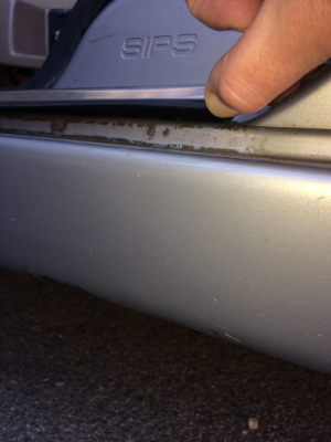

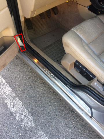

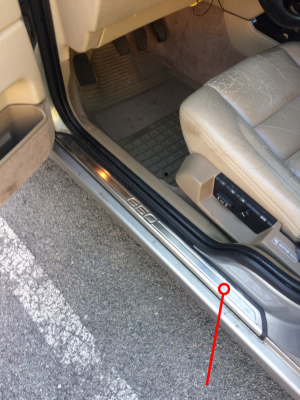

Dear all, I'm new here, thank you very much in advance for support. I'll try my best to translate technical terms correctly, please forgive any mistakes.
Basically the car is corrosion free but there is a guess that I might have some problems in the hollow spaces in the rocker panels, not sure if the visible corrosion comes from inside out as I see it on boths sides, driver and co-driver, pls. see pic.
Any way to inspect the inside without disassembly work by video camera?
If not, could a kind soul advise how to deinstall the metal arch trims without damaging them? No idea how they are fixed, just that they are not glued over full surface, just fixed along their rear side. Might they even be clamped together with the plastic rocker panel covers? It is the 96 version with the plastic rocker panel covers fixed from bottom, not from top.
Removal of plastic rocker panel covers is clear, just the arch trims are in question
Again, thank you & regards Sonicbarbecue

I have recently gone through this with a young friends 96 850. I think you have mud flaps at the front of the car?
We had to remove the plastic covers to have the metal welded underneath. To remove them you have to remove all the plastic rivets along the bottom edge. You have to push the center pin in to release the rivits/clips. Be careful not to lose all the pins. Also check while you are doing that the metal brackets the pins go through are even still there! It is a good opportunity to clean and paint this area when the cover is off.
To remove the rest of the cover, you need to drill out the rivets holing the front mudflap in place and remove it. Then you have to pull up fairly hard or in my case I used a 90 degree 'pick' to get under the edge of the upper part of the plastic cover below the door area and use it to pry up the plastic to un-pop the clips. If the nice shiny trims come off, they are only held on with double sided body tape so can easily be re-fitted.
I'm not sure on the P80's but some cars have plastic round covers on the inside of the rocker/sill panels behind the carpet that can be removed for access.
Another option is to get some rubber plugs and drill a few holes along the top of the rocker panels. These can be used to pass an inspection camera through, and then you can try something like Bilt Hamber? protection which comes with a 360 degree spray head on long tubes you can then spray and protect the rockers from inside.

The metal pieces that cover the plastic rocker panels are just glued on. Use a screwdriver to get them off and any kind of flexible glue to mount afterwards.
You can inspect the rocker panels by removing the rubber plug behind the rear door and use a flashlight to see how they look from the inside.
I'd guess you are fine, your 850 looks quite clean. Only one of my 3 850ies has rusty rockers.

It's hard to tell if you already have the plastic rocker covers off, but I recently found some nasty surprises behind those nice plastic covers. You can get a little bit of an idea by putting your head under the car, and looking at the back side of the pinch weld. If it looks like some brown is peeking through the undercoating, or if the bottom edge isn't straight, it may indicate a problem.
Once the panels are off, there are holes in the top of the rockers, as well as access through the brackets that the pins clip into at the bottom.
You can put a borescope/endoscope in here to get an idea of the condition, since they rot from the inside out. If you don't have one already, they're available on amazon, I'd suggest one with both an end AND side mount camera, or one with a wide field of view (I've seen ones with 120° lenses).
I'm not sure what undercoating is available in your Austria, but try to find a set of cans that come with a 360° sprayer wand that you can stick in the rocker and coat the inside. Just don't buy anything that's rubber-based (rustoleum, ziebart). Look for woolwax, hopefully its easier to find than an El Camino in good condition.
