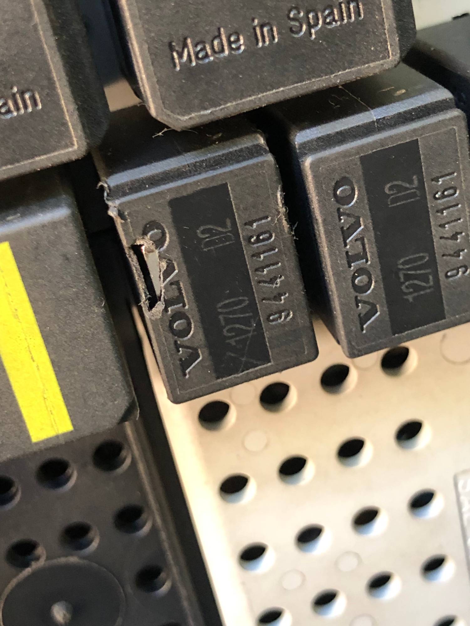

02V70
Posts: 358
Joined: 15 Dec 2021, 21:06
Year and Model: 2002 V70XC
Location: California
Has thanked: 53 times
Been thanked: 40 times
Post by 02V70 »
The relay looked like this. I swapped it with the one for the fog lights, and now the high beams work!
2002 v70 X/C 288k miles
