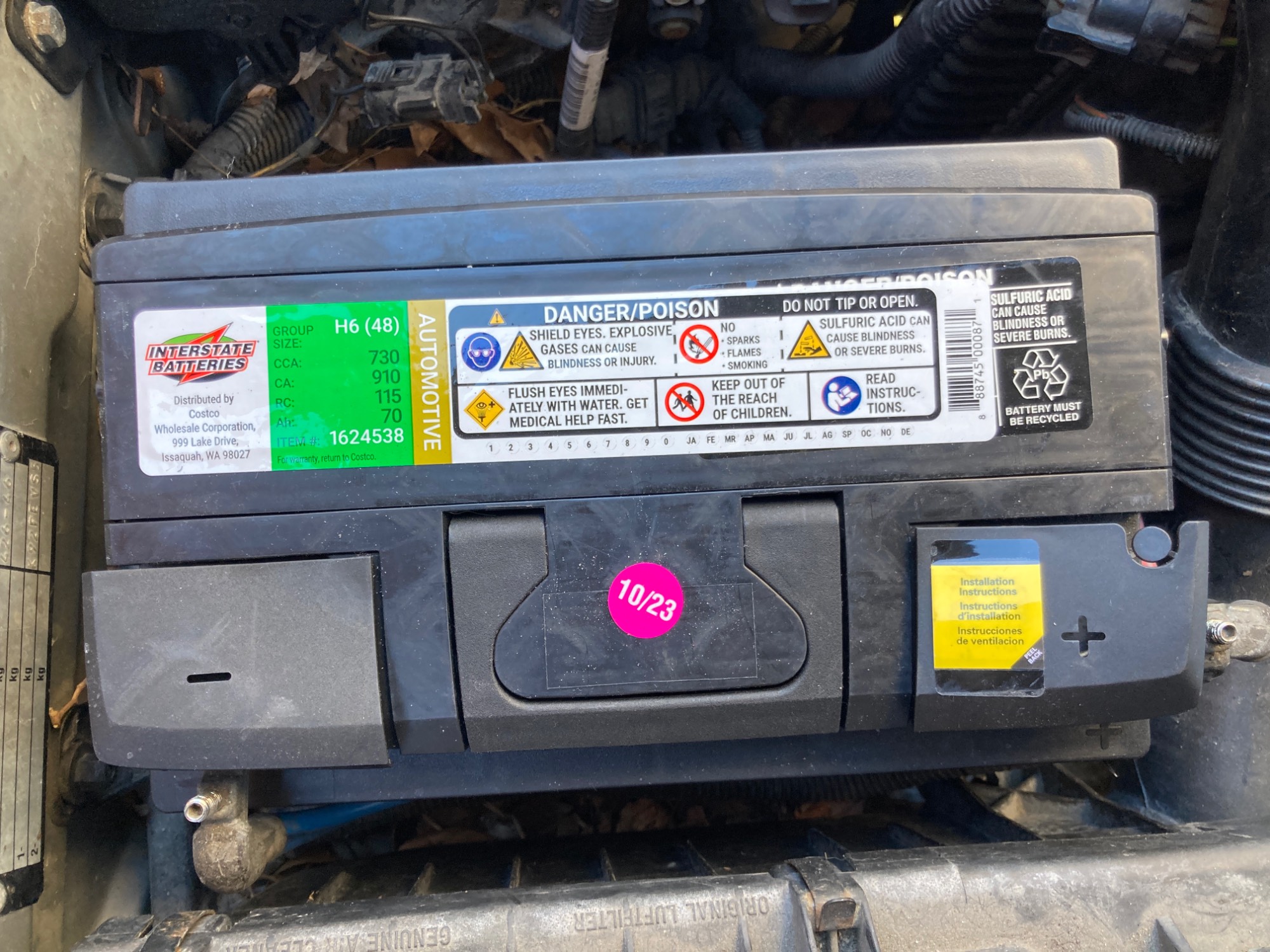

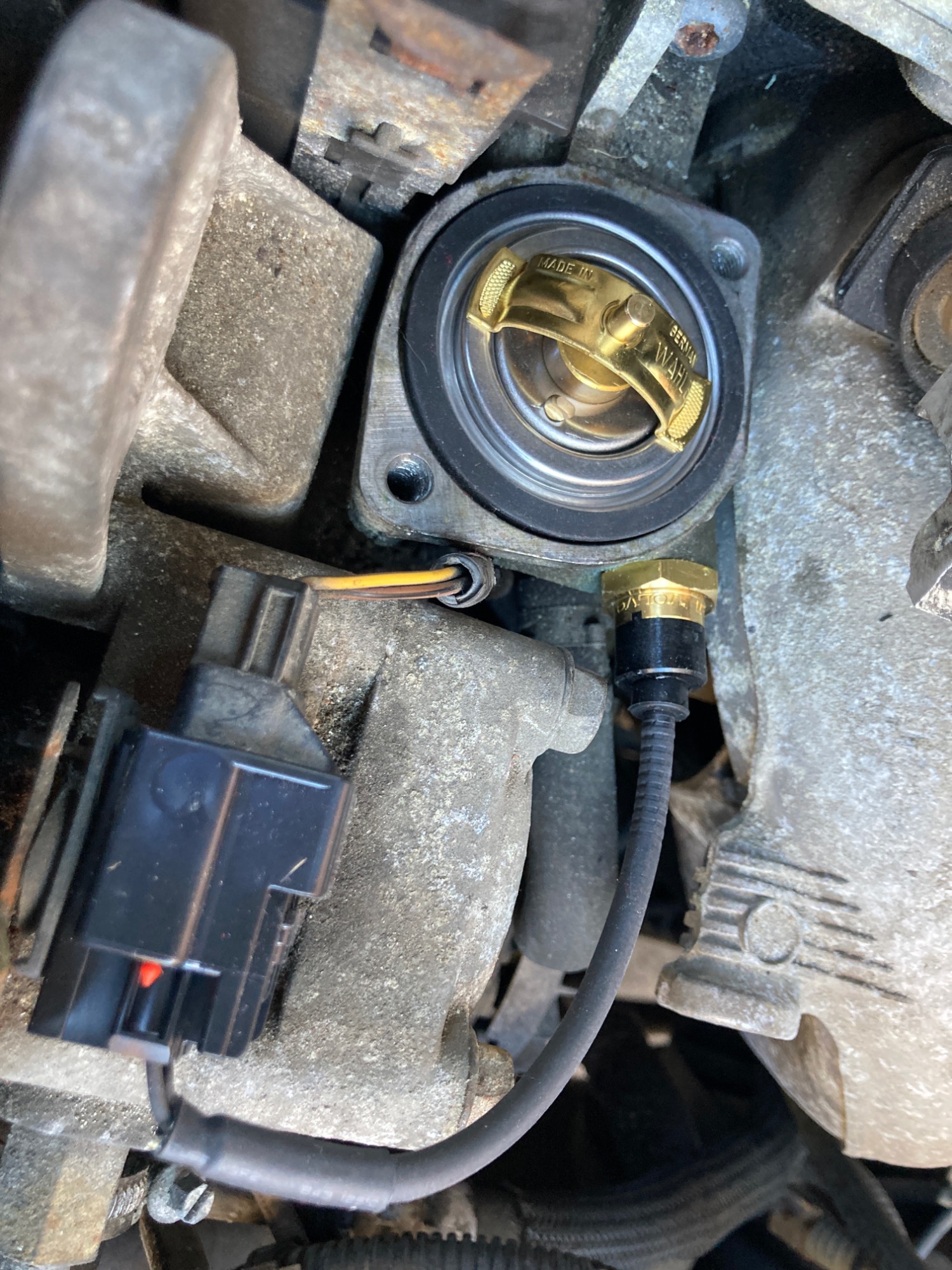

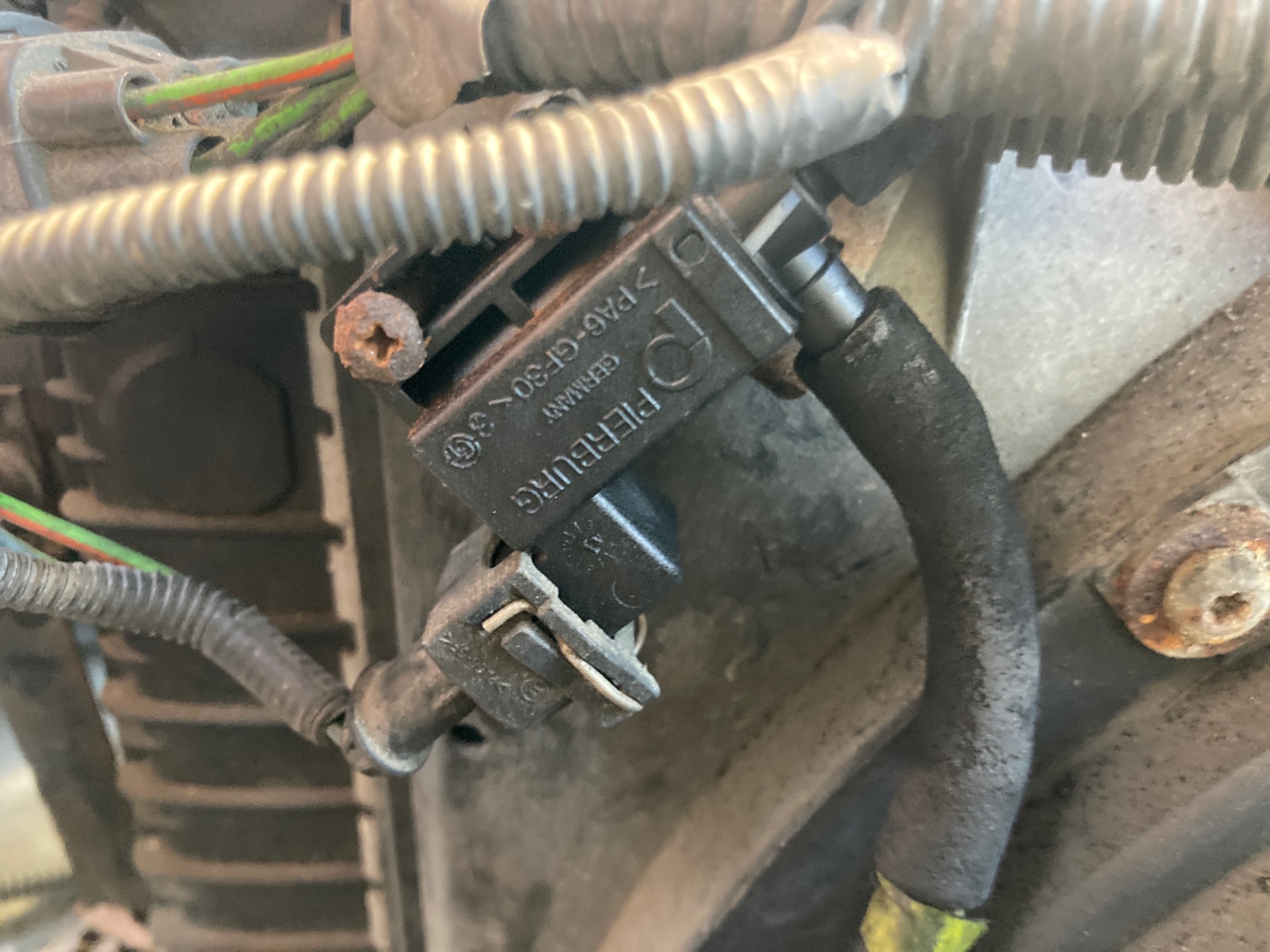

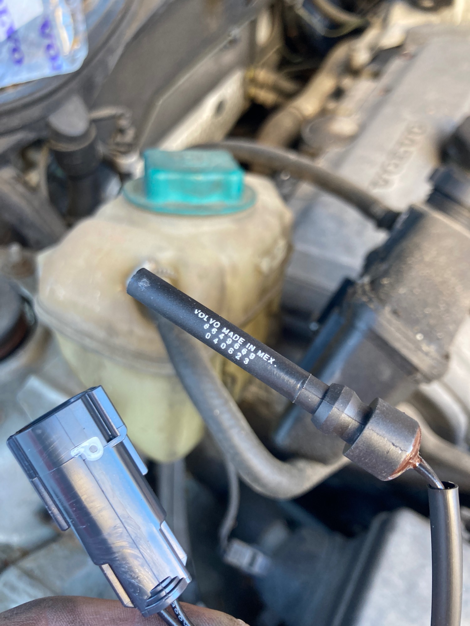

Finally got everything I needed to get the Silver Bullet back on the road after changing the MAF sensor along with rear brake rotors, calipers and pads and having the ETM repaired. A new H6 Interstate battery (why do they spec the smaller H5 with lower CCA and a higher price?), a Pierburg canister purge valve, plus OE thermostat, temperature sensor and coolant level sensor.
(Does anyone know offhand the diameter of the purge valve hoses?)
Started right up and hunted around for its proper idle speed for a bit before settling down. Now to bleed the brakes and get some fresh fuel!

You got me curious since the battery in my 850 is an H5 and the battery in my S70 is something that doesn't quite fit if I want to use the hold down. I haven't replaced it, since it was installed shortly before I purchased the car, and it still quite new.brunocerous wrote: ↑19 Nov 2023, 09:50 A new H6 Interstate battery (why do they spec the smaller H5 with lower CCA and a higher price?)
Looking at Walmart's catalog, because that's where I buy all my batteries, I find that the H5 is listed for my 850, but the spec for my S70 is an H6 with the exception of their AGM offering. Prices seem to be the same for the two sizes, but they sure have gotten expensive. $160!!! My truck battery is $20 cheaper even though it's larger... group 78 (or 75).
When I bought the 850's battery, I wondered why the tray looked like it was designed for a larger battery. Next time, I'll get an H6.

It is an alternate size. For warmer climates the larger battery is not needed typically. For colder climates we need the larger battery to turn the car over when really cold! Volvo typically sells you the H5 for P80's.
