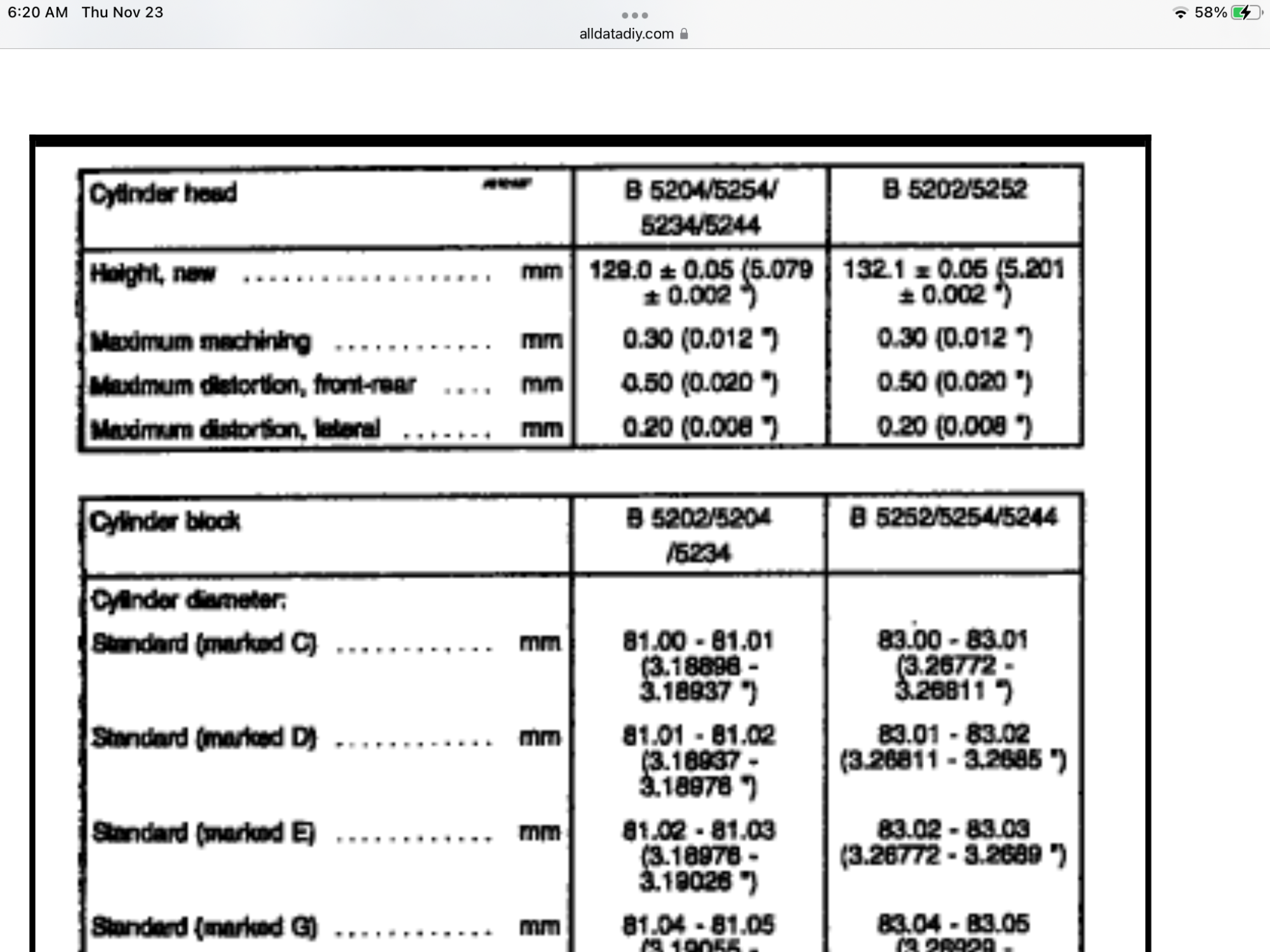

- Posts: 35273
- Has thanked: 1498 times
- Been thanked: 3810 times
The warp spec from Volvo is much , much bigger than that.I've seen people say that more than 0.01mm is bad,
O, 5mm end to end
0,2mm side to side
20 thou and 8 thou respectively for the Imperialists
- 39BF3803-A649-422E-AE0C-A72012018EE6.png (776.69 KiB) Viewed 618 times
