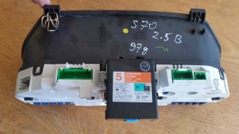

When you guys are saying remotes are stored in the VGLA module, which one is it on -98 S/V70 ?
The alarm module that's attached to the steering column, or the module on top of the instruments (pictured) ?
The remotes never worked on my V70, but the 850 OBD II app reports two registered remotes. Wondering if I could fix it without needing the PIN

That top of dashboard module is just antenna and its circuitry. Alarm VGLA module is further in dashboard and steering column one i belief is immo.Goupil wrote: ↑22 Nov 2023, 14:46 When you guys are saying remotes are stored in the VGLA module, which one is it on -98 S/V70 ?
I am waiting currently one VGLA module myself arriving hopefully soon so i can write down step by step guide for the PIN for 97-00 year models which has this VGLA module. I dont promise but i think possible the way so where no need take module out of the car..
If new remotes then need be sure is frequency murican 315mhz or 433mhz european (usual frequencies per area) if dig them out of ebay.

Interesting, I'll have to try swapping the receiver next time I have the dash off then.
I have a spare from another -98 P80, might as well do that before I spend any money in other parts
