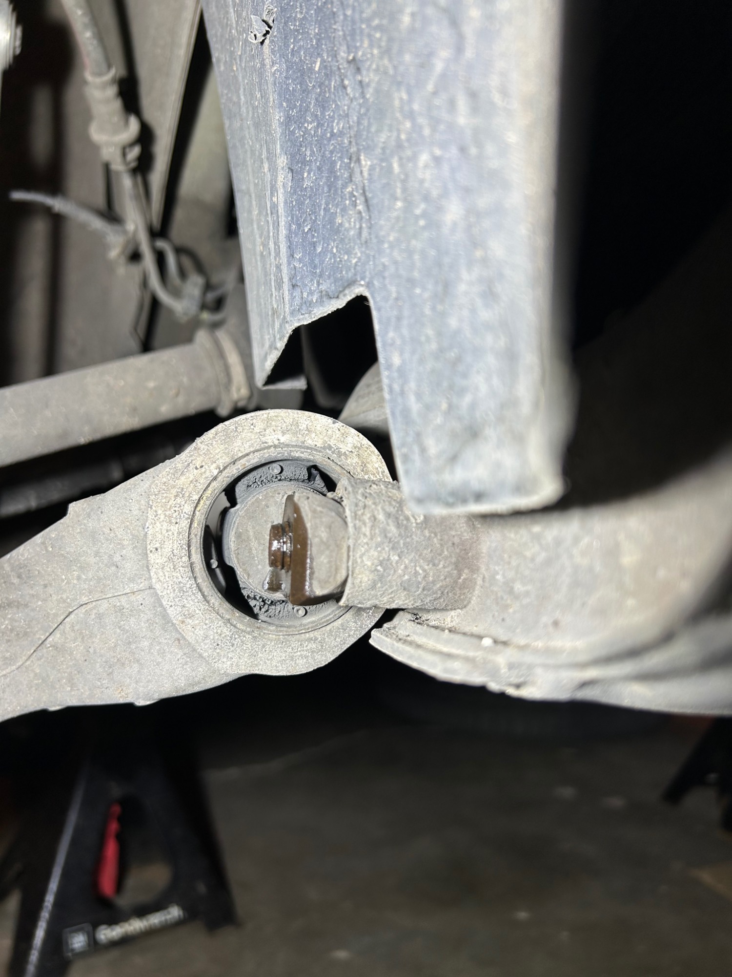

Doing control arms this week(end?), the green wagon came to us with the factory original arms so just over 180k. Pics of those at the end of this post.
Not all pics are rotated 90˚ clockwise as compared to how I took them.
Why was the passenger axle full of water??? I've never run into that; probably 6-8 oz came out. Is the CV grease ok? The axle bolt threads were greasy on this side.

Car had no clear symptoms yet of failed control arm bushings but FYI this is what they looked like when I started the job ...
passenger's side bushings 1
passenger's side bushings 2
driver's side bushings 1
driver's side bushings 2

Keep your old control arms, don't throw them out. Get some Volvo bushings and re-bush them and then you have a spare set for later. What brand of control arms are you installing? I've noticed some casting variations with the aftermarket brands I've seen, a couple of them appear to be cast iron or mild steel painted to look like aluminum.

The new arms are Lemforder (viewtopic.php?p=636853), they are not magnetic at all and the casting seems okay to my naive eye. But I hear you I'll hang onto the old arms for now, although if they go bad then I'm probably more likely to replace under warranty, we'll see!

Those bushings are crispy! Should ride much better afterwards.
I’d probably throw a boot kit on it and re-grease it. When I found a torn driver side boot on my S60 during an oil change I bought a cheap aftermarket CV shaft to keep it going until I got time to re-boot/grease the old one. 10,000+ miles and I’ve yet to do that…maybe get to it this winter!
