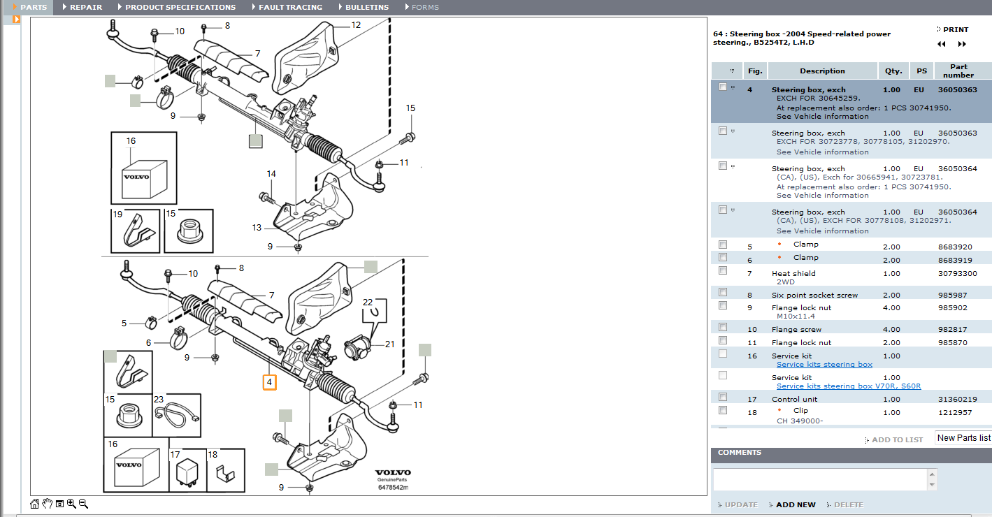

What's your VIN? VIDA will say the correct (Volvo) part number for sure.
Racks are very expensive. I replaced mine in 2018 with a factory-rebuilt Bosch-ZF for $800, it still works. It also came with the new tie rods/rod ends/boots, which is nice.

2004 V70 2.5T AWD Wagon VIN YV1SJ59H542416853
