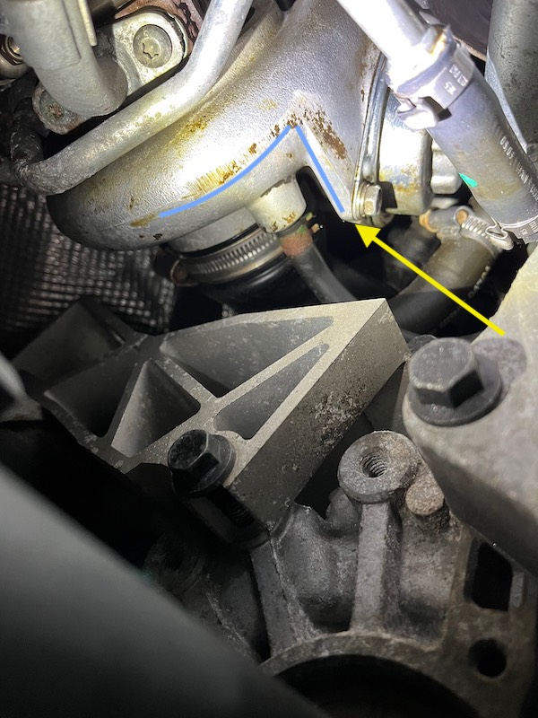

Not a good news day today...
When I changed the torque rod a couple of weeks ago I noticed undertray was covered in oil. Looking around I saw the bottom of the turbo was covered in oil, I wiped it dry and took the car for a drive, sure enough there was more oil leaking when I returned. The turbo drain on these cars are prone to leaking at the seal but mine was dry, the oil inlet feed banjo bolt was also dry so that is as much as I know about turbos and decided to book the car into a turbo specialist for further inspection.
I dropped the car into the specialist this morning and just had a call to tell me the thrust collar bearing on the cold side is leaking and needs rebuilt. I as told I could have left it for a while without doing any harm but the leak would just get worse. He was surprised that this was the cause as he thought it might have been an intercooler problem. The car won't be ready until the end of the week.
