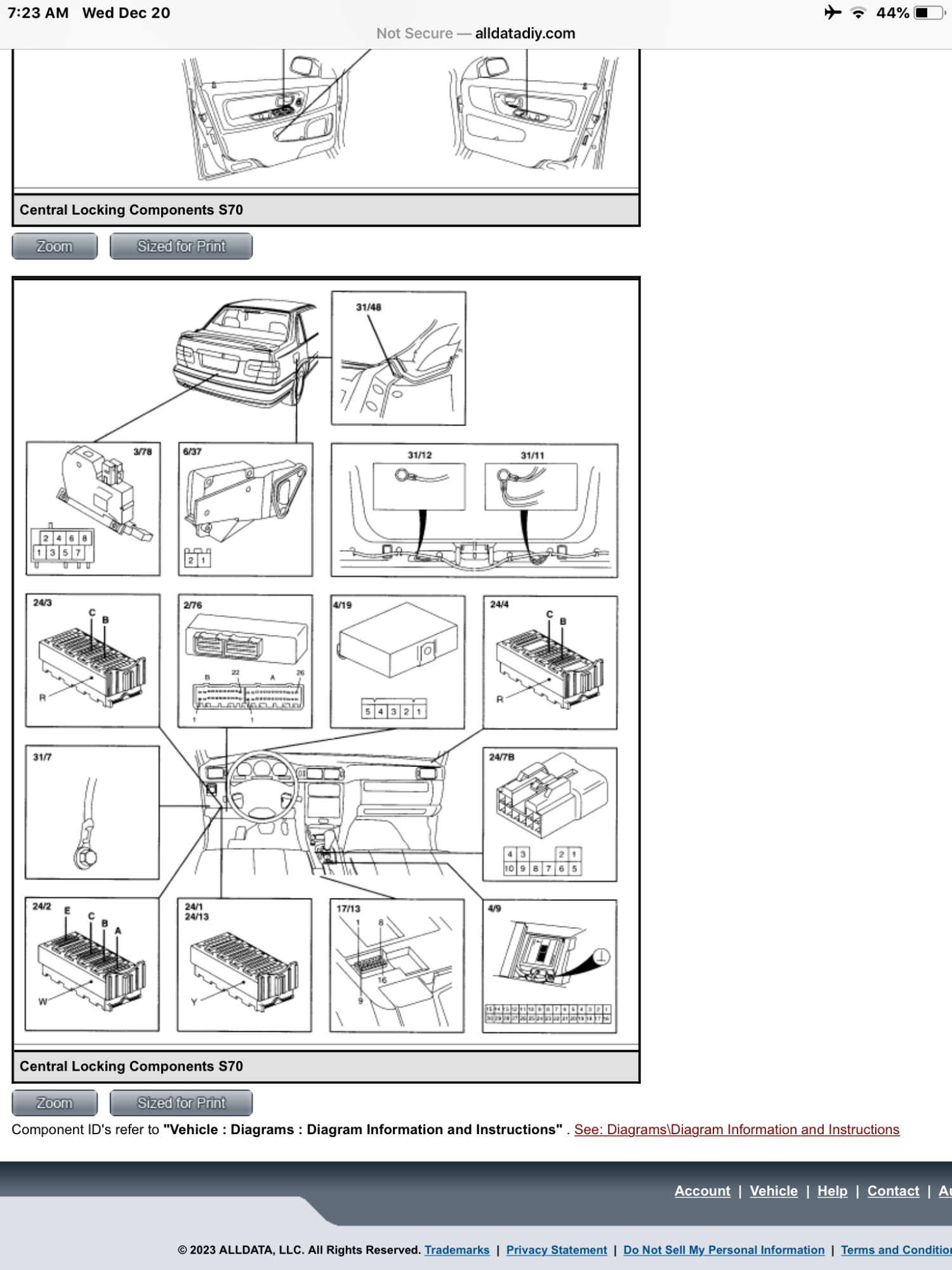

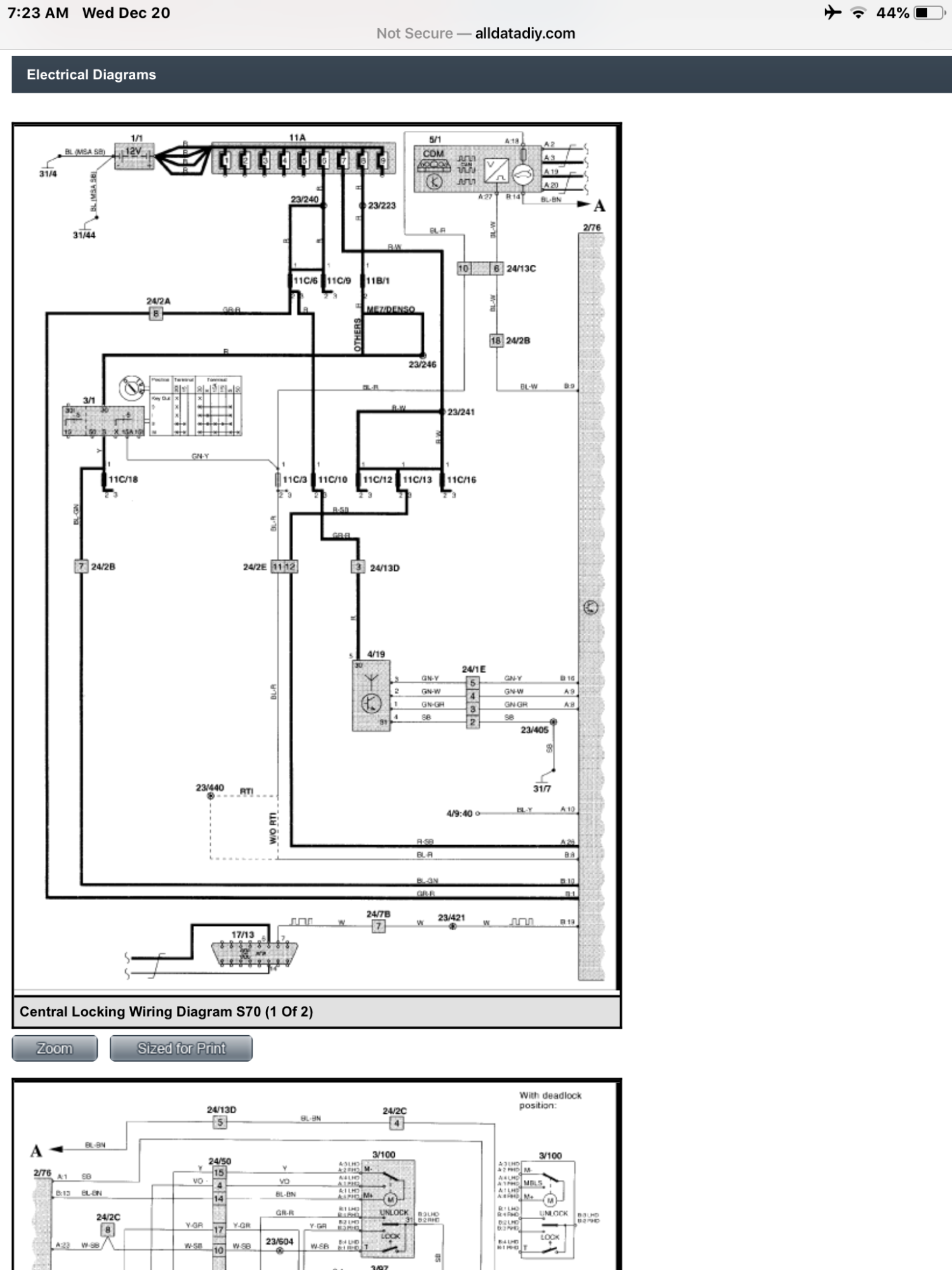

Still wondering about this. The real deep understanding would be to know where vida is actually writing key information
Lock control module 2-76?
VGLA unit?
CDM?
ECU?
Some of the above ?
All of the above?
It looks like it just writes to the VGLA module, based on this thread successfully moving a remote and the 4/19 module
