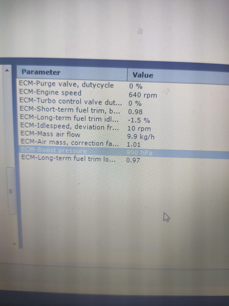

erikv11 wrote: 18 Feb 2021, 09:24 Most common cause of vibration after the top torque mount is the front engine mount, the non-hydraulic one under the crank pulley. Access from the wheel well.
I'll try to get my hands on some working space ASAP. Thanks guys! I was trying to find something suspicious in VIDA but I couldn't to. Pic attached, readings of hot engine.
