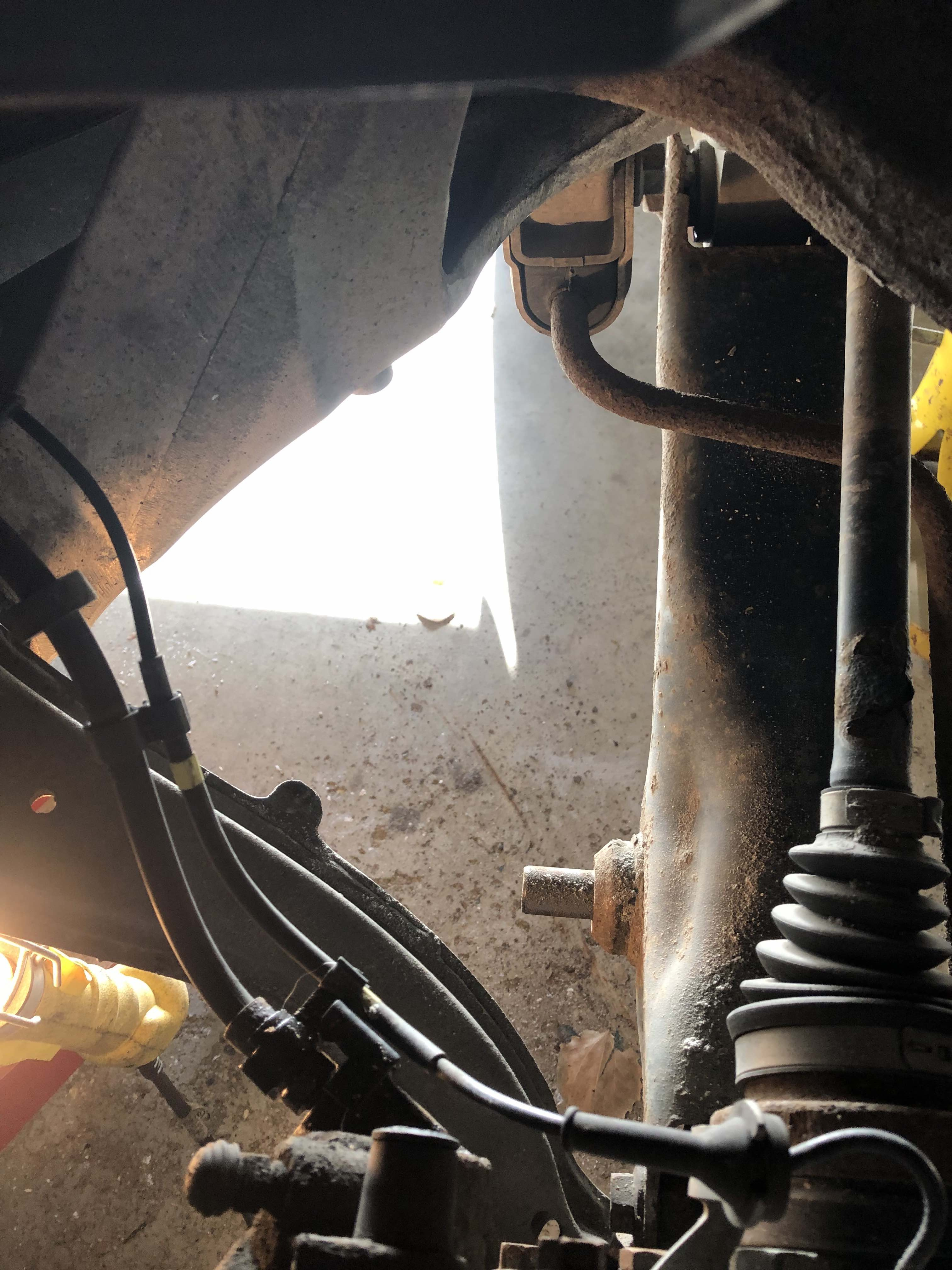

Support the lower arm of the suspension with the jack and pry the bottom of the strut off the mounting dowel
lower the strut assembly through the bottom through this hole in front of the dowel, you will have to rotate and maneuver it but it will come out the bottom without force.

For this step working solo I used a wide, ratcheting load strap across the bottom, looped over both sides of the suspension with the ratchet in the center under the car. This way you can cinch down until both sides are low enough for the reassembled shock/struts to be installed. No danger of anything falling out but it is scary how much tension there is in the strap.Blacklab467 wrote: 24 Nov 2021, 16:13.

Here’s me prying down a control arm on a 2004 XC70 using the pry bar method

I could not get the ratchet strap method to work on a 2004 XC70 (the same car abscate's prying on above in my driveway viewtopic.php?t=90195&start=60) until I disengaged one end of each control arm stay that are used to align the rear wheels. Then it was fairly easy. No amount of ratcheting would sufficiently lower the control arms with these stays in place. Others report difficulty with this step but the stays are not mentioned in discussions of this topic or in the official Volvo instructions. Am I doing something wrong? What could explain my different experience?erikv11 wrote: 05 Dec 2021, 02:20 For this step working solo I used a wide, ratcheting load strap across the bottom, looped over both sides of the suspension with the ratchet in the center under the car. This way you can cinch down until both sides are low enough for the reassembled shock/struts to be installed. No danger of anything falling out but it is scary how much tension there is in the strap.

Maybe the strap you're using is too lightweight? It was even easier for me the second time, when I used a wider strap and moved the hooks farther out.

I would be surprised if the ratchet strap is not sufficiently heavyweight. I used this strap (HAUL-MASTER 3300 lb. Capacity, 2 in. x 27 ft. Ratcheting Tie Down https://www.harborfreight.com/3300-lb-c ... 7IQAvD_BwE) as in the attached photo. It was as widely placed as possible and as taught as I could get it bracing against a wall and using my legs. I'm relatively weak but still. Descent had stopped and it was so taught I thought it might snap with more turns of the ratchet. And it worked relatively easily after disassembling the stays. Both things can be true: yours (2003 XC70) can be lowered with the stays in place; mine (2004 XC70) cannot. Model-year differences explain other apparently anomalous observations (like presence/absence/placement of a FPM -fuel pump nodule - as discussed recently on this forum).erikv11 wrote: 24 Dec 2023, 00:43 Maybe the strap you're using is too lightweight? It was even easier for me the second time, when I used a wider strap and moved the hooks farther out.
