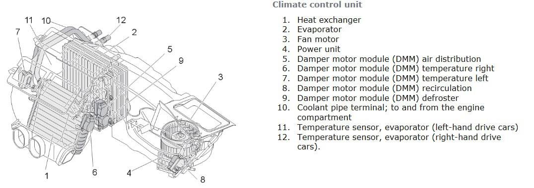

Do you know which damper based on the above info?

Is it that one side is warmer than the other? Defroster works properly? Position (legs/torso/head)?

No it's the temperature that's the problem at all vents. It's either ice cold or warm. I'm thinking the one which regulates temperature (not fully switching air flow to the heater core) but don't know which one that is or where it's located. Thanks in advance.

On the driver side, remove the bottom panels and look up towards heat core. The damper whose arm would interfere with core's removal is your broken one.

Wouldn't the ambient temperature sensor throw a fault? Is there an output value you could check with the autel?

Heat problem in the P2 cars boils down to:
1. HVAC linkage arm.
Just kneel down and look if the linkage arm moves when
the setting is changed from Blue to Red (key in position II).

try doing as vtl says, looking for damper movement.
