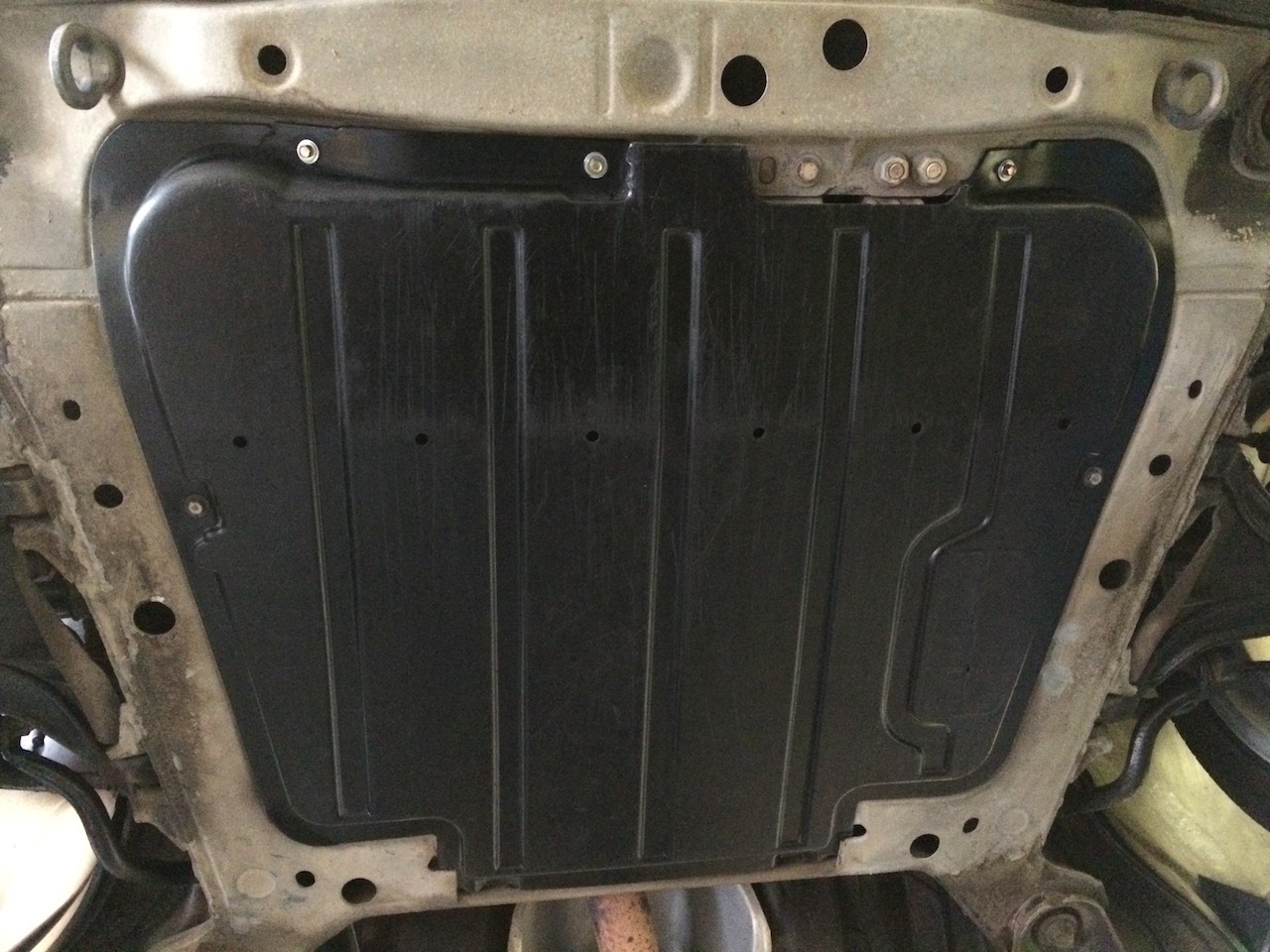

Under trays were only fitted to diesel engine cars in Europe, as far as I'm aware there were never fitted to petrol cars. I fitted a used one from a diesel car to my 850 a few years ago, at the time they were still available from Volvo part number 1397236

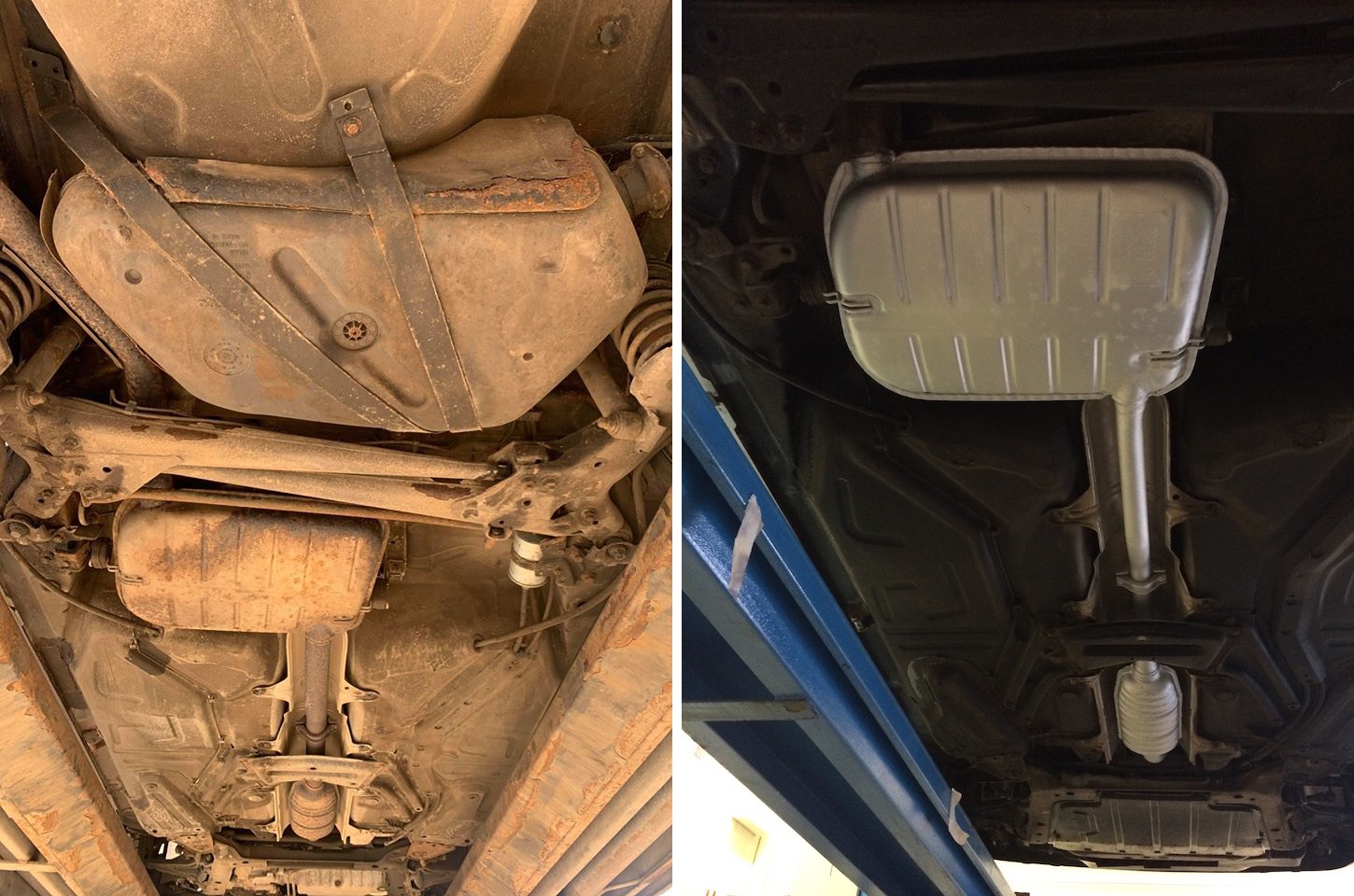

The underside of your car is truly amazing! With the crap they spray on the roads here and the poor guys on the eastern side of Canada/US we have little hope of achieving that level of preservation.
I am jealous of the engine undertray. I think they left it off here for better cooling in hot areas so we all got the same no-tray car supply. I recall my 760 and 240's having the undertray and it kept the engine bays so clean. Of course other than 240 diesels from the early 80's we never saw Volvo diesels over here. Mercedes/BMW/VW yes, but not Volvo.

I really don't buy the 'omitted to keep the car cool' story, all new cars have them fitted and none of them seem to suffer unduly from over heating. The air dam at the front bumper should be more than adequate at keeping the flow of cool air going through the radiator therefore keeping everything within temperature specifications, a little draft on the bottom of the sump isn't going to make much difference at all. More likely it was on diesel cars to cut down on noise, not forgetting in the early 90s when these cars were new very few cars would be fitted with an under tray.
As for the crap that goes on the roads, the west coast of Scotland is notorious for the copious amount of salt they spread every year. My car wasn't always that clean, I spent a lot of time with rags and soapy water to clean it all up.
This is a before and after picture, luckily there was no rust, just a lot of dirt that had built up over 23 years of use on UK roads

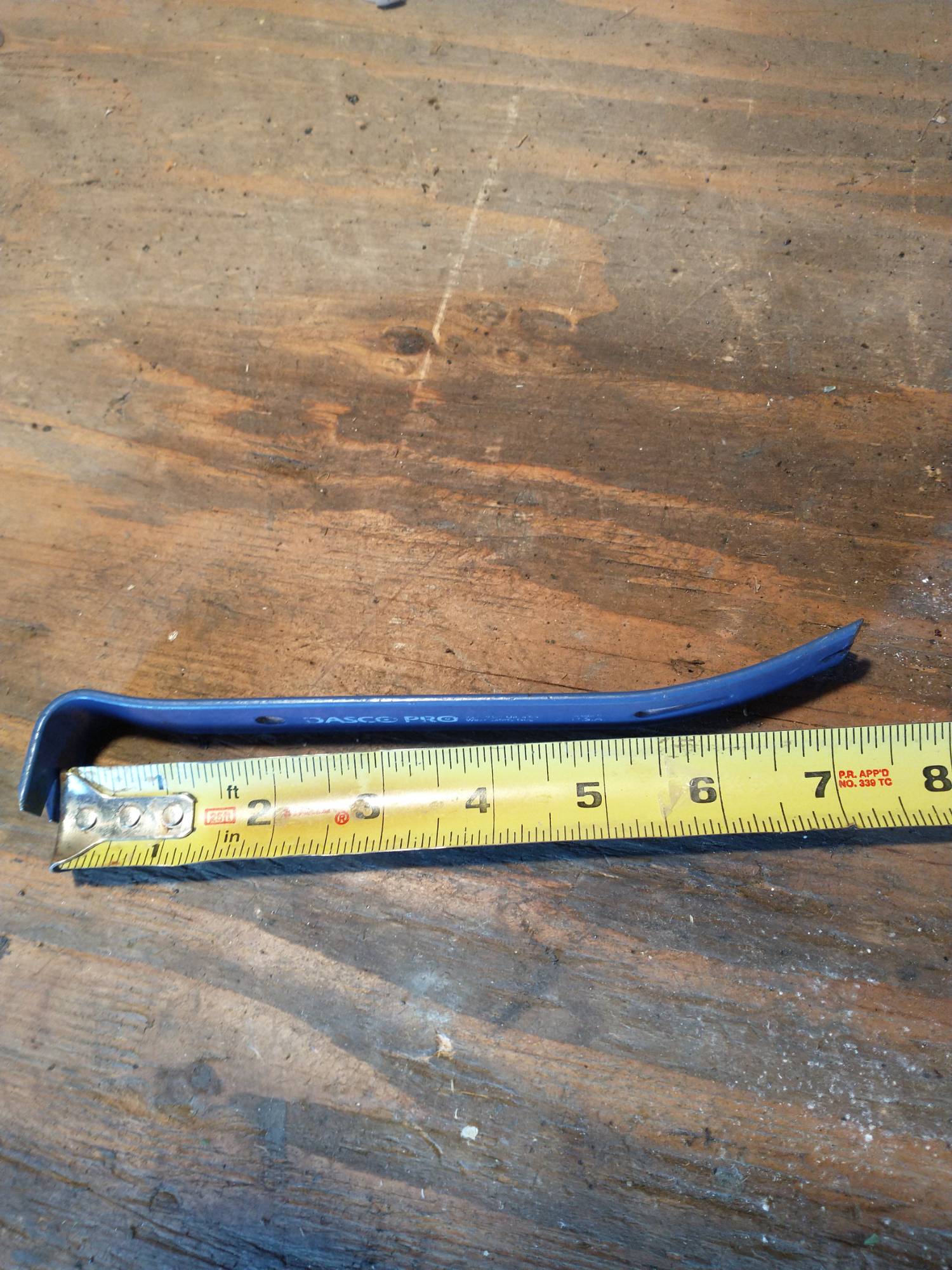

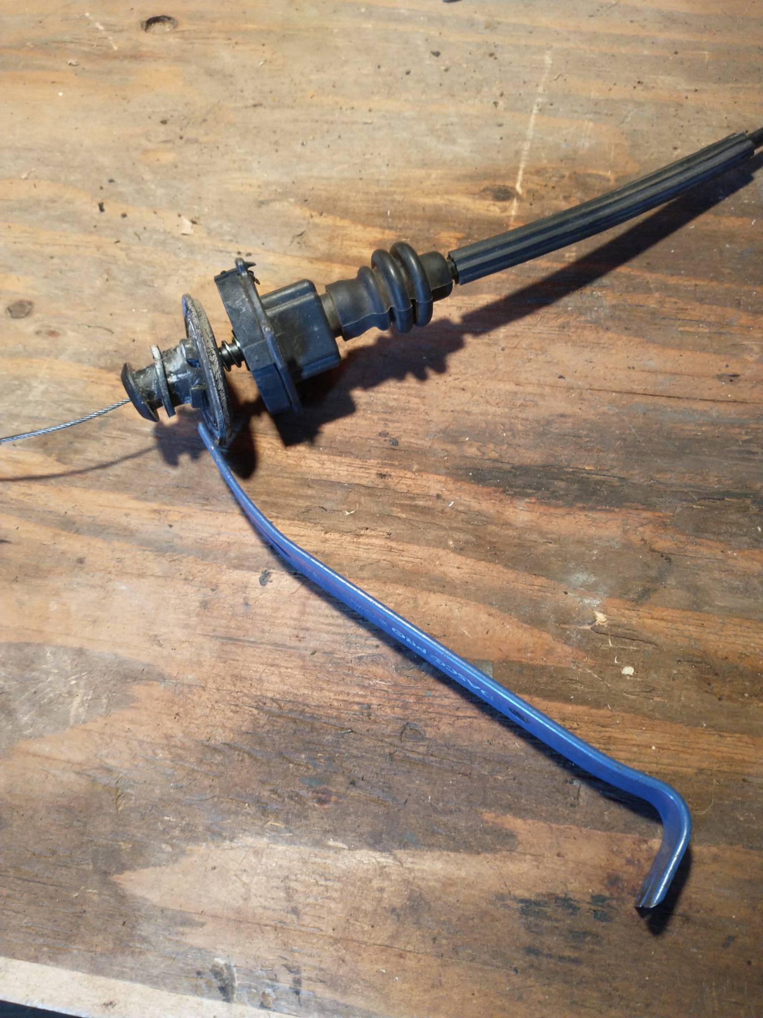

Installed the new throttle cable today. After watching a couple of YouTube videos, I was expecting this to be an involved hassle, due to the firewall connection. But no exaggeration; I had the whole thing switched out in 10 min. ( It did take another 10 min. to adjust it ).
So what I found that works, is after the easy parts are disconnected from the throttle body / pedal / plug, just manhandle and break the cable free from the firewall connection. Then use a small flat bar to push and pry the rest of the unit out of the firewall. Mine came out without even breaking the white plastic collar. No damage anywhere.
