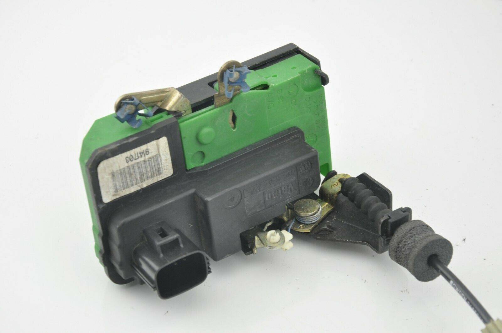

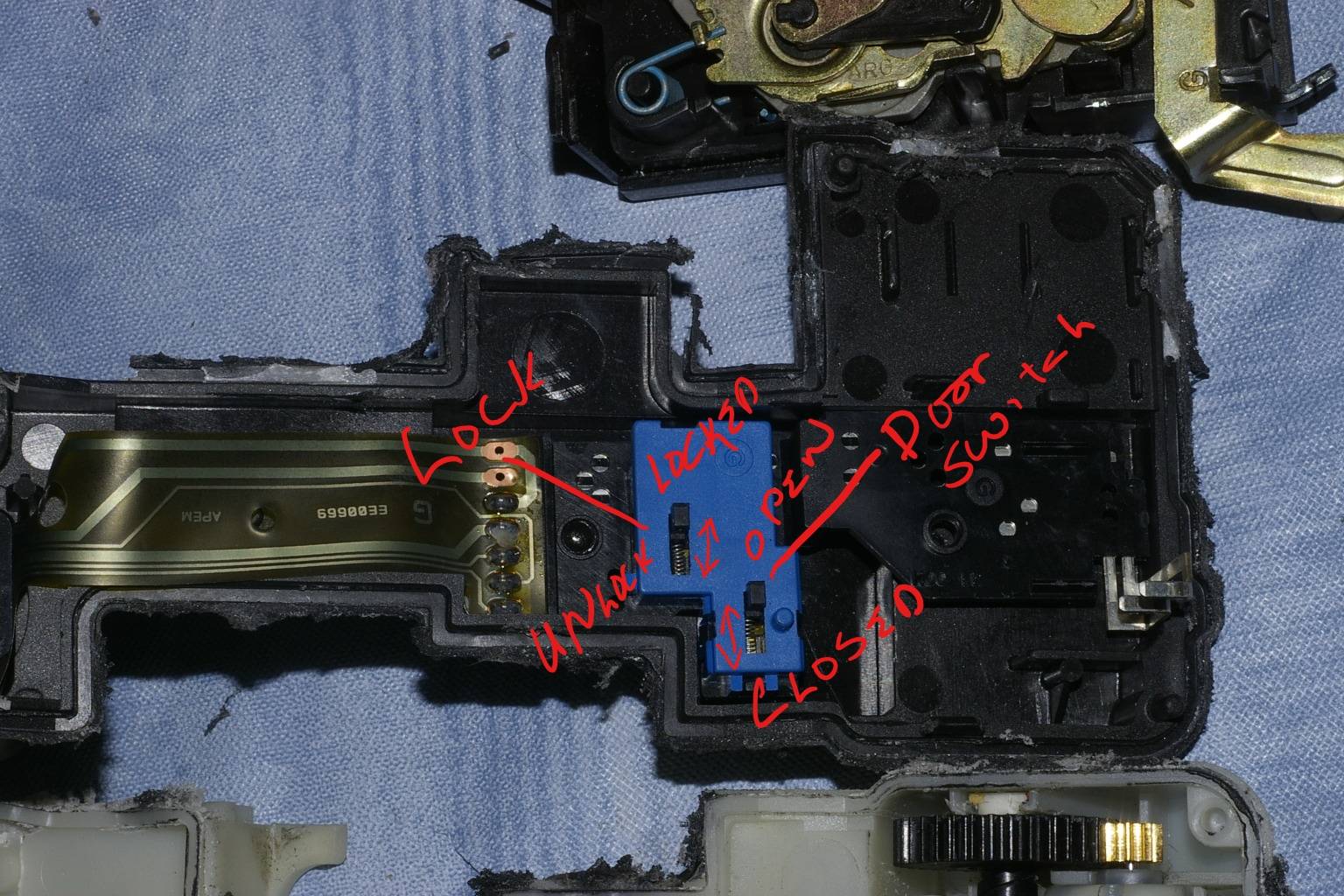

Post by firstv70volvo »
Chieftain wrote: 24 Dec 2023, 07:04 I'm having the same problem has anyone succeeded in curing this fault?
Typically caused by microswitch in the door latch/lock module. Solution is to replace with known good used one or new one. There are two switches (door opened/lclose and door locked/unlocked) that are internal to the sealed door module so you can get to them to clean them. Also could be the door wiring in the hinge area but less probable cause.
photos of switches from a cut open door module.
