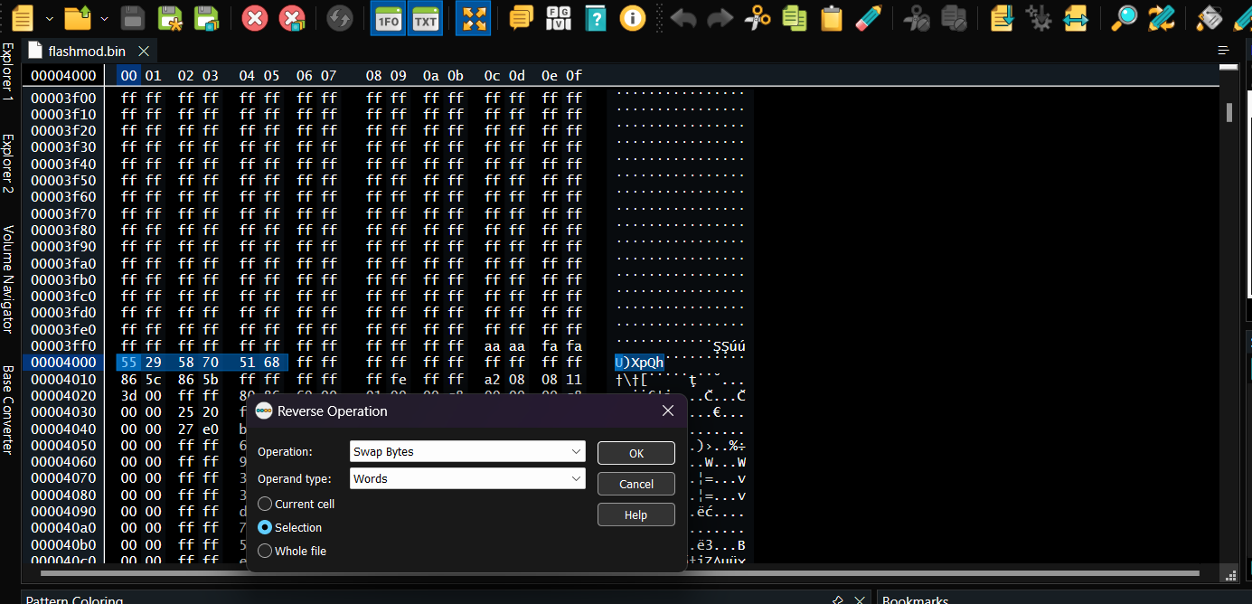

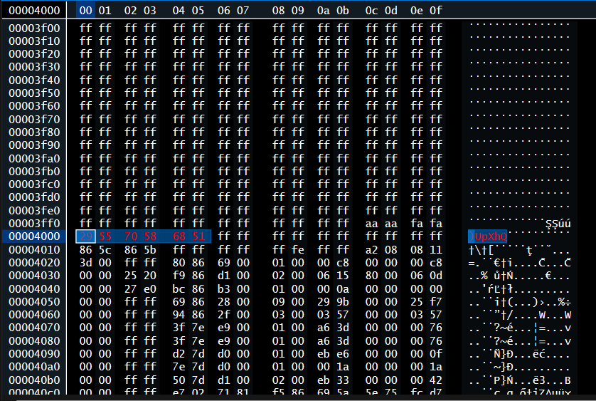

emericaz wrote: 05 Jan 2024, 05:19 Hi! Someone can check my 2003 CEM dump for me? This is my first try on something like this and i dont want to brick it.
Dump seems OK, I looked at the configuration part, wait until someone else confirms
VIN location OK
CHKSUM 1 & 2 OK
PIN @4000

emericaz wrote: 13 Jan 2024, 11:22 What PIN @4000 means?
Open the file in hex editor, go to address 0x4000 in hexadecimal or 16384 in decimal.

vtl wrote: 13 Jan 2024, 12:08
Thanks for the quick reply.
I need to change anything on the numbers or the order?

emericaz wrote: 13 Jan 2024, 14:51 Thanks for the quick reply.
Swap odd and even bytes, and then maybe shuffle them. What's your part number?

emericaz wrote: 14 Jan 2024, 04:37 I can’t get it right
What do you have in file and what have you tried?

vtl wrote: 14 Jan 2024, 07:08
I tried like this
