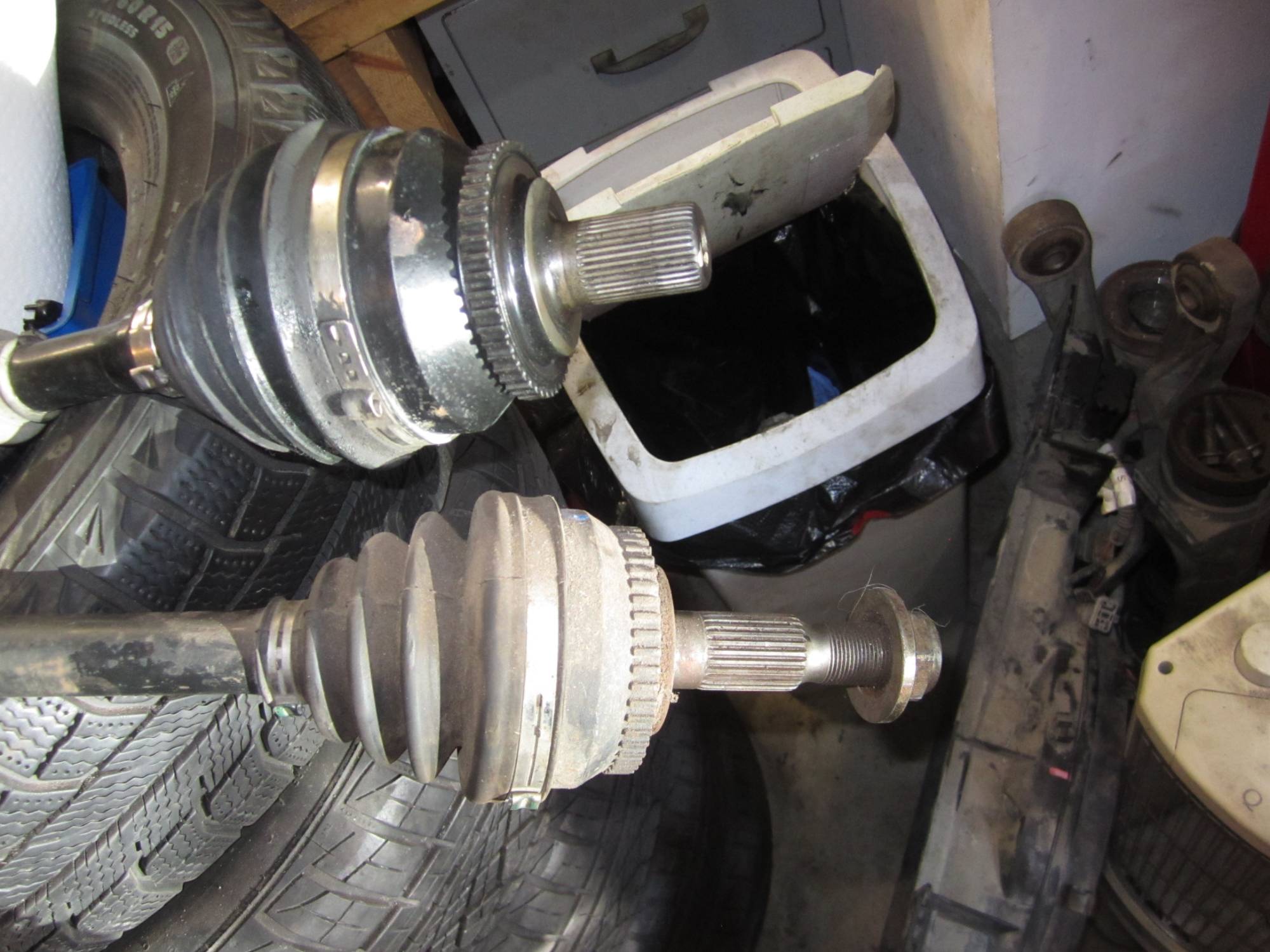

This may help on tone rings:
The upper of the 2 axles is almost like new condition. The lower one is a little dirty but still in good condition.
If your tone ring (you can see it through the sensor hole more easily) is excessively rusty/crusty, or has a bunch of dirt in there, then it can cause a tooth to be missed which will through an ABS sensor code. The reluctor ring is a little tricky to replace, but this gives you an idea:
https://www.google.com/search?q=Swappin ... TL3uo,st:0
The rings can also crack if rust builds up on the shaft it can cause the steel to swell and cause the ring to split.

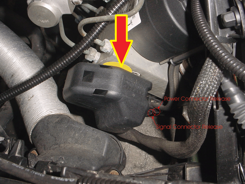

I found a photo of the ABS plug from perhaps the first documented ABS Module repair on MVS. I've added an arrow to where you can wedge a washer, piece of plastic or wood shim for construction to test the ABS. It's a test for the voltage in pin area going into the board and not other areas, which may have cold joints also.
viewtopic.php?t=12651
