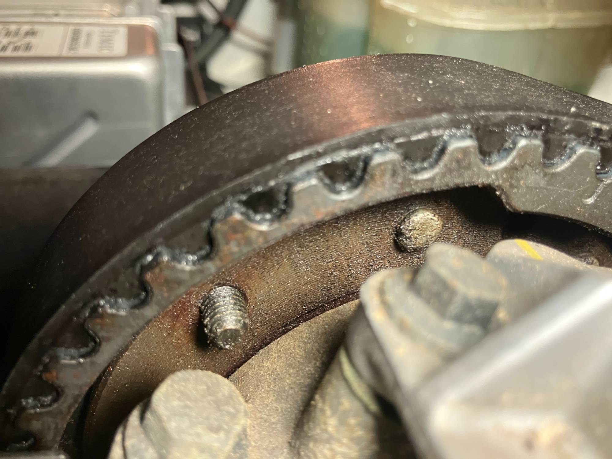

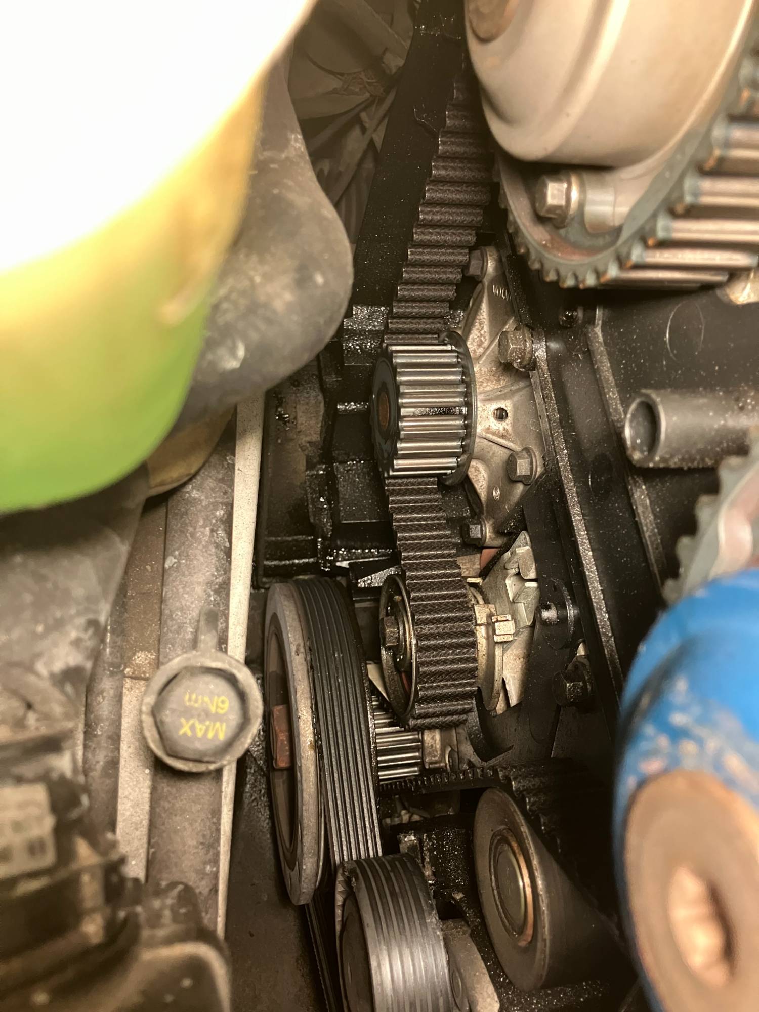

Hi all,
I've had an oil leak on the front of the engine (timing belt side) for quite some time now. It's very slow, but I'd rather not risk a timing belt slip/snap. I'm having a hard time determining what is causing it. I've attached some pictures but I'm not sure they're all that helpful. The back of the intake CVVT gear looks suspicious -- I hope it's not that ($$$).
Any advice on how to identify this leak before I start taking stuff off? I need this car on weekdays, so I can't have it apart for long. I'm thinking of grabbing two cam seals, a crank seal, an oil pump seal/gasket kit, and a timing belt kit, and returning whatever seals I don't end up using. I probably need a new timing cover too -- it's been soaking in that oil leak for so long that it is turning into rubber :shock:

Happy to answer any additional questions or take more pictures if there is somewhere I should be looking as a clear indicator of a specific leak source. Thanks for any and all help, as always.
(sorry for the pictures being upside down -- they are right side up when I open them on my computer!)

I can't tell from the pictures what is causing it. What I do recognize is your TB cover looks like mine did when my CVVT failed. One of them failed, and my Indy mechanic suggested changing both, which we did. I took the car to my Indy, and he did the diagnosis by eye that it was the CVVT. Good luck.

timetobakethedonuts wrote: 12 Jan 2024, 15:31 I can't tell from the pictures what is causing it. What I do recognize is your TB cover looks like mine did when my CVVT failed. One of them failed, and my Indy mechanic suggested changing both, which we did. I took the car to my Indy, and he did the diagnosis by eye that it was the CVVT. Good luck.
Ah. I honestly can’t remember how well I cleaned up the timing cover when I replaced the exhaust CVVT unit. I assume it wouldn’t be damp on the back if it was good - the exhaust side (that I replaced) is dry on the back.

that hardly looks like a leak, mine was dripping on the floor and the back of the vvt hubs were wet.

Maybe I ought to get a can of brake cleaner and go back in to clean it all up during the kids’ nap today. Could be that my 2018 self half-assed the cleaning when I did that VVT hub. Definitely no oil dripping on the ground, so if it’s a current leak it’s a seep.

and that plastic cover will clean up nicely with some brake cleaner spray.
