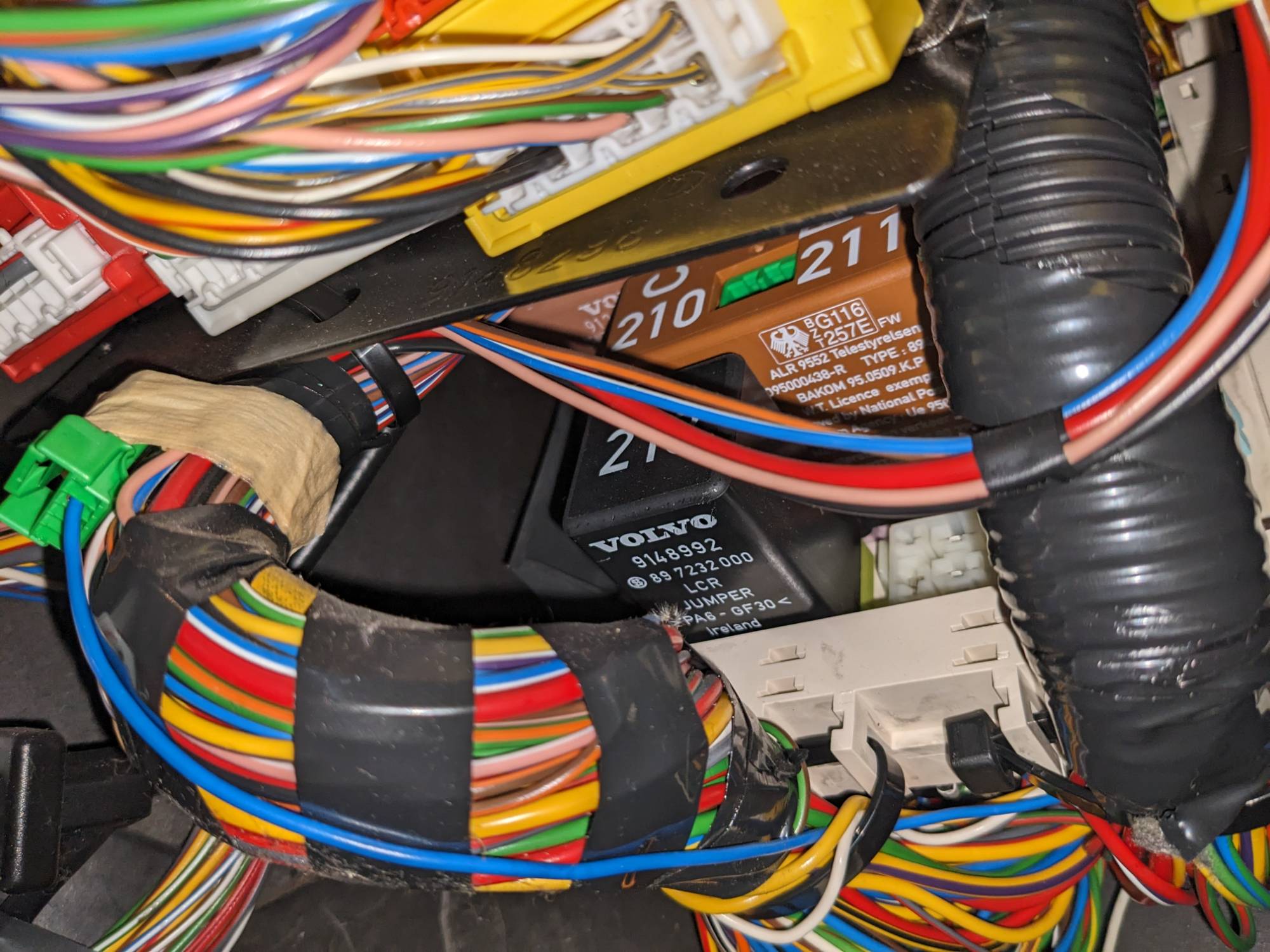

I have just picked up a new to me 850 and I would like to add remote central locking.

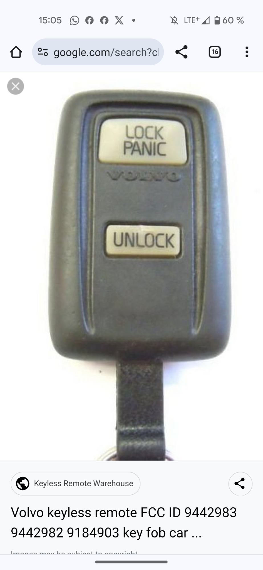

I took the kicker panel off hoping to see a grey 210/211 relay as shown in a couple of different guides. But I was greeted by this brown 210/211 relay, is the same relay and compatible with the "guard 2" key fobs like in the screenshot.

After googling a little I found a old post on a European forum suggesting that it's the same or at least it works with the fobs
https://www.motorbasar.de/volvo-850-960 ... 32950.html
Now just need to find the fobs

In my lists i have one verified visually Brown 210/211 with Part Number 9177999 which had Remote Part Number 944281 with it originally.Randomnamegenerator wrote: ↑21 Jan 2024, 08:29 After googling a little I found a old post on a European forum suggesting that it's the same or at least it works with the fobs
Now just need to find the fobs![]()
Mine 850 has black 210/211 but same like remote too ( thanks for kind person donating one! ).

Thank you for confirming xanthefin
Unfortunately 2 cheap Fobs came and went from local eBay the week before I had confirmed the car was 100% going to be mine.
The search (for a cheap one) continues!
